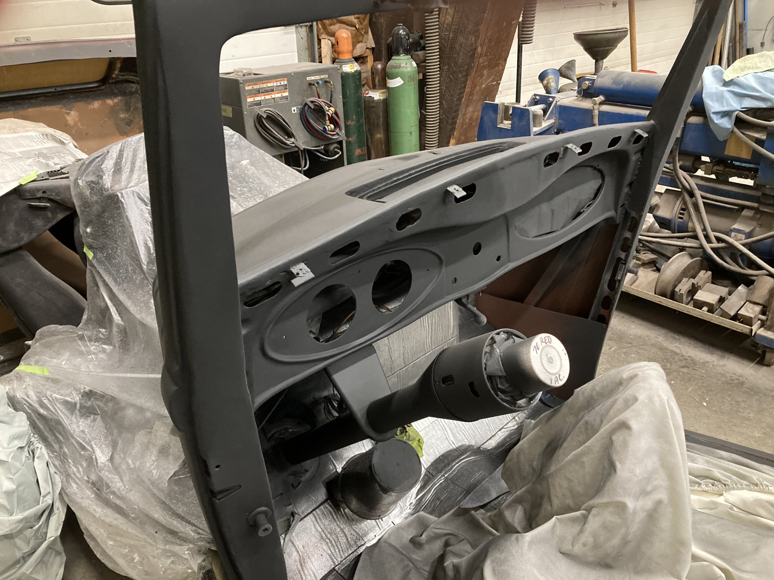

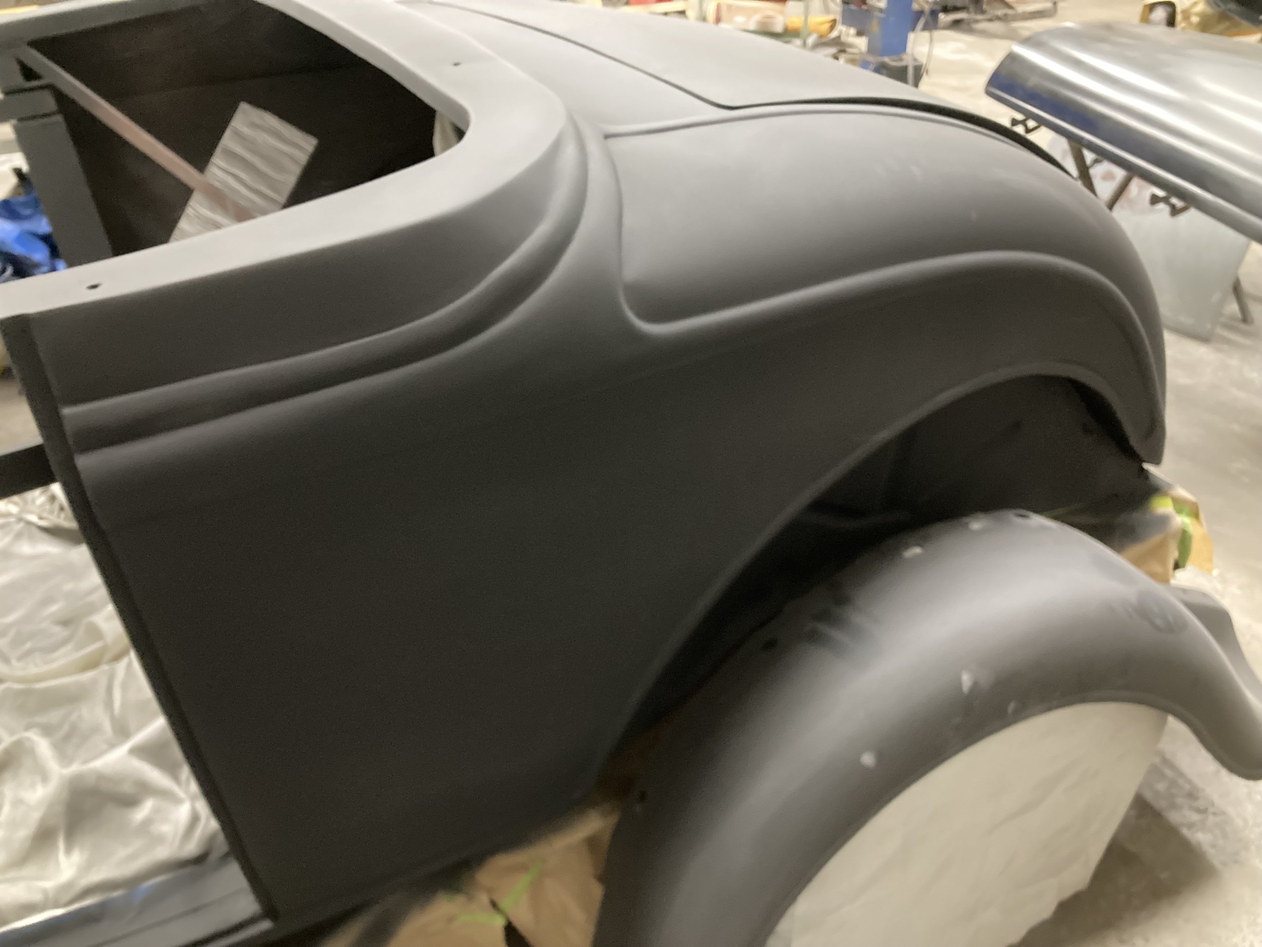

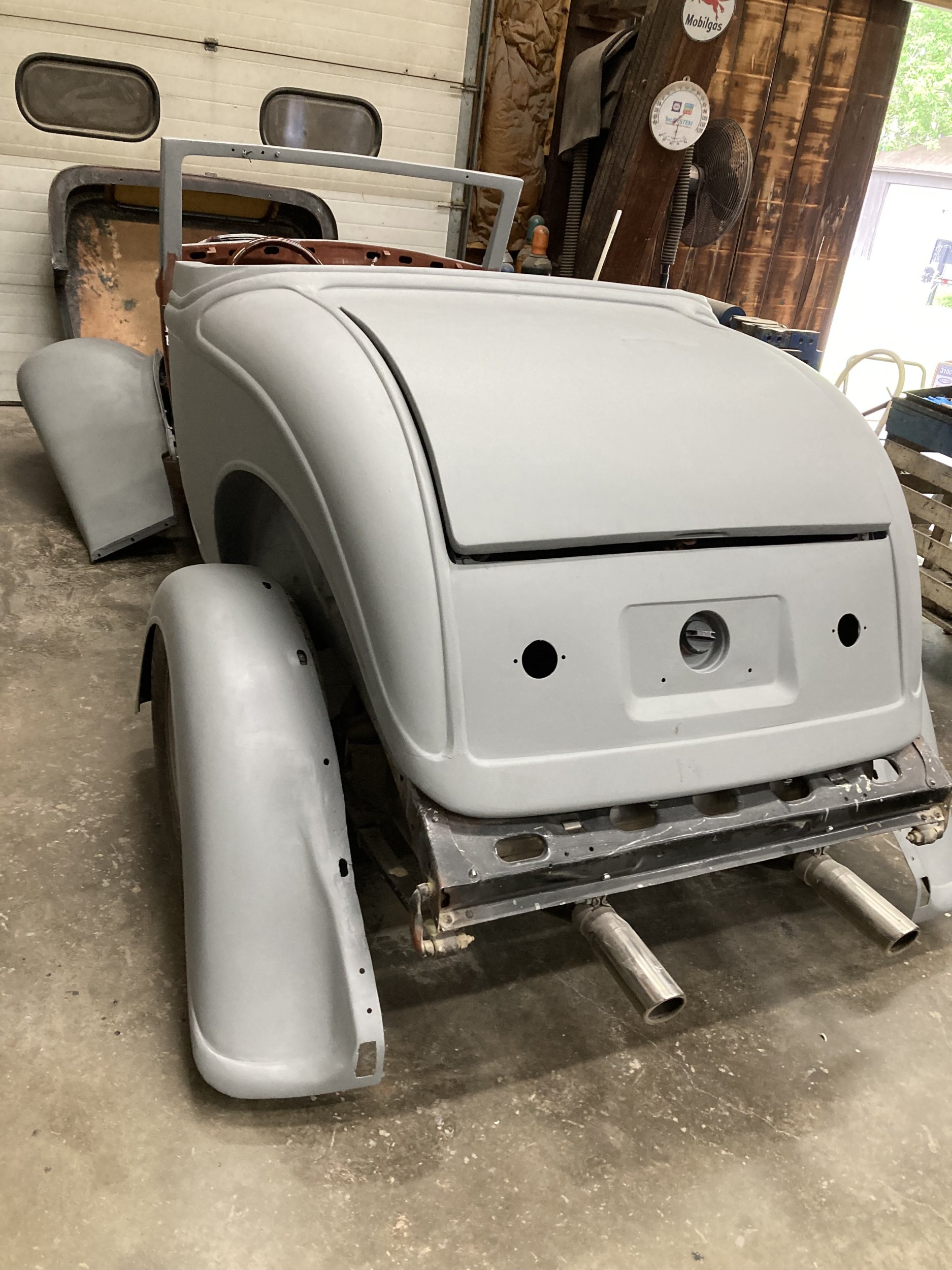

    So I finally am getting my **** moving and completing this project. I started this as something to putz with on weekends slowly gathering parts as they became available and money was there. I had my 29 to drive and there was no rush. Then in 2020 (I can’t believe that’s almost 5 years already) I retired and was still just treating it as something to do. Then you look around and have some friends p***ing on and realize your no spring chicken yourself anymore . My 29 is starting to show its age ,paint failing,oil leaks,wiring starting to have issues so I better get this one done to drive so I can work on it. So I finished most of the mechanical stuff got the body work fairly decent and blew this thing apart to paint. Contacted Upholstry guy and get him started on various chunks of car. I decided to try the roll on Eastwood primer which worked great although it needed 2 coats and it blocked out very nicely. No mess from overspray and only used about 3/4 of a gallon for entire car. Then got some primer sealer which I got in black because car is going to be dark color and it shows up any bad spots that need attention. Here are a few pictures up to this point. I will post more as the shiny stuff goes on

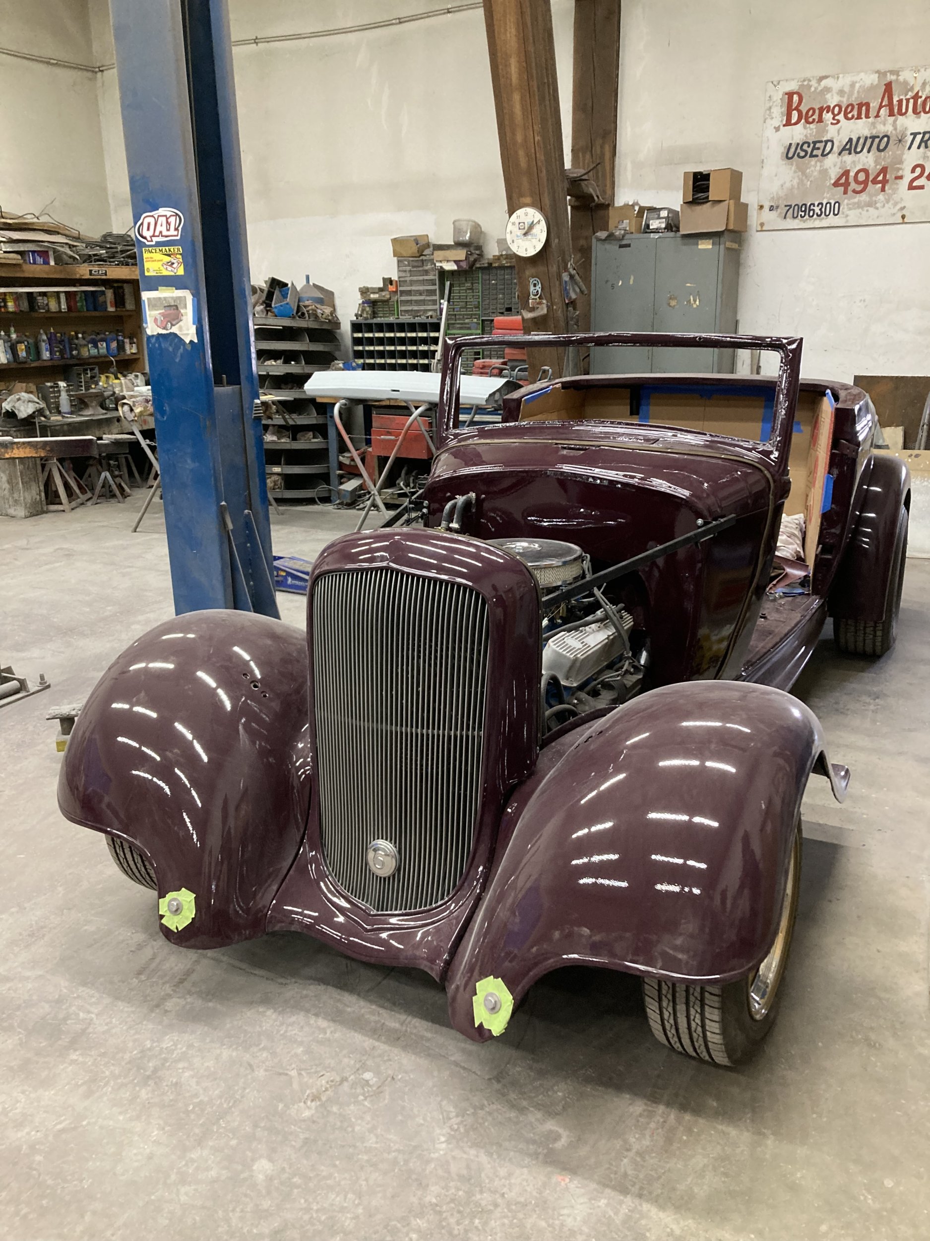

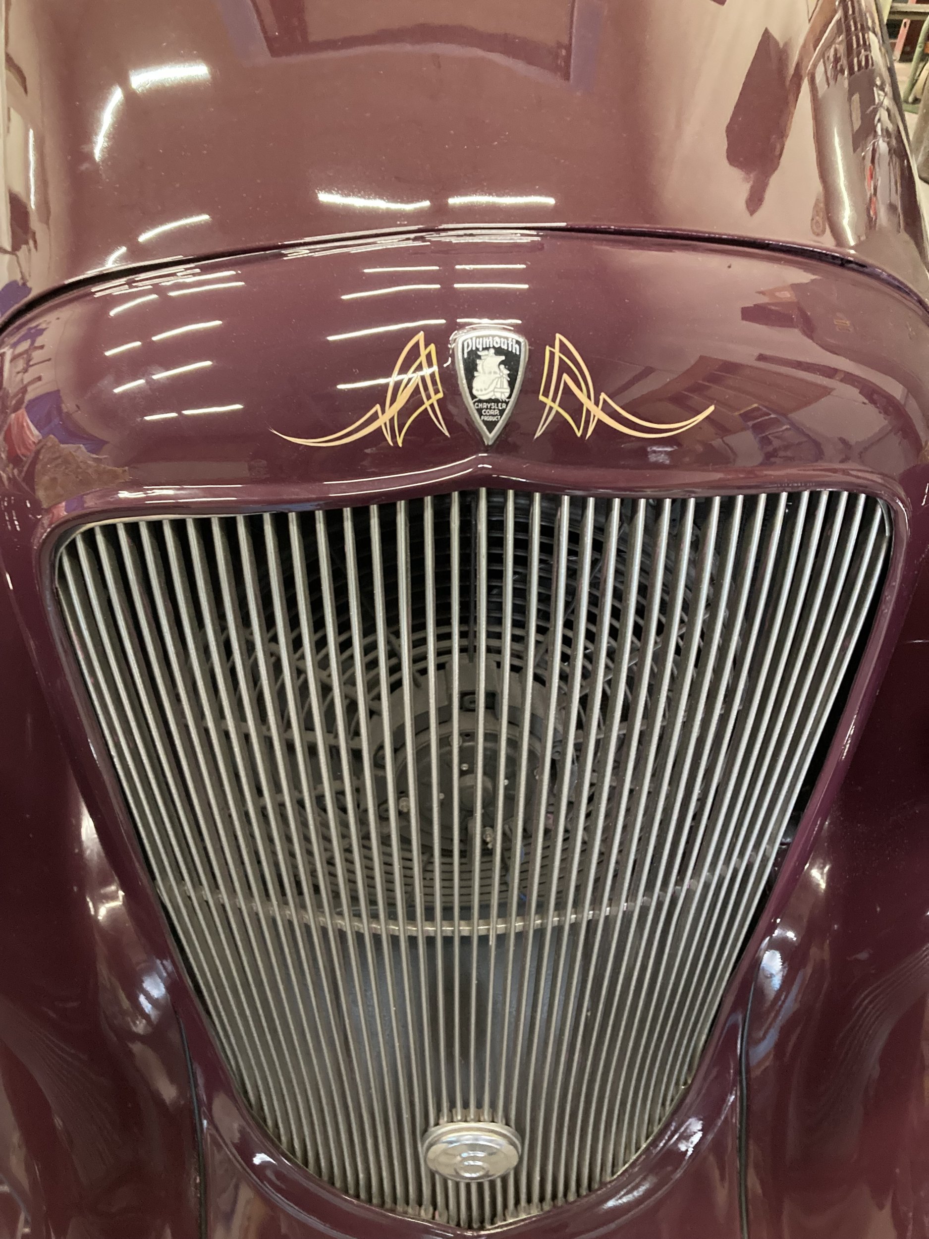

  16. Chucky
    Joined: Mar 15, 2009
    Posts: 1,862
    Chucky
    Tell us about the paint and the color. That is real nice looking!

  17. notaford1
    Joined: Feb 6, 2012
    Posts: 282
    notaford1
    from webster ny
    Restoration shop paint. Royal maroon single stage urethane. Nice deep nonmetallic color

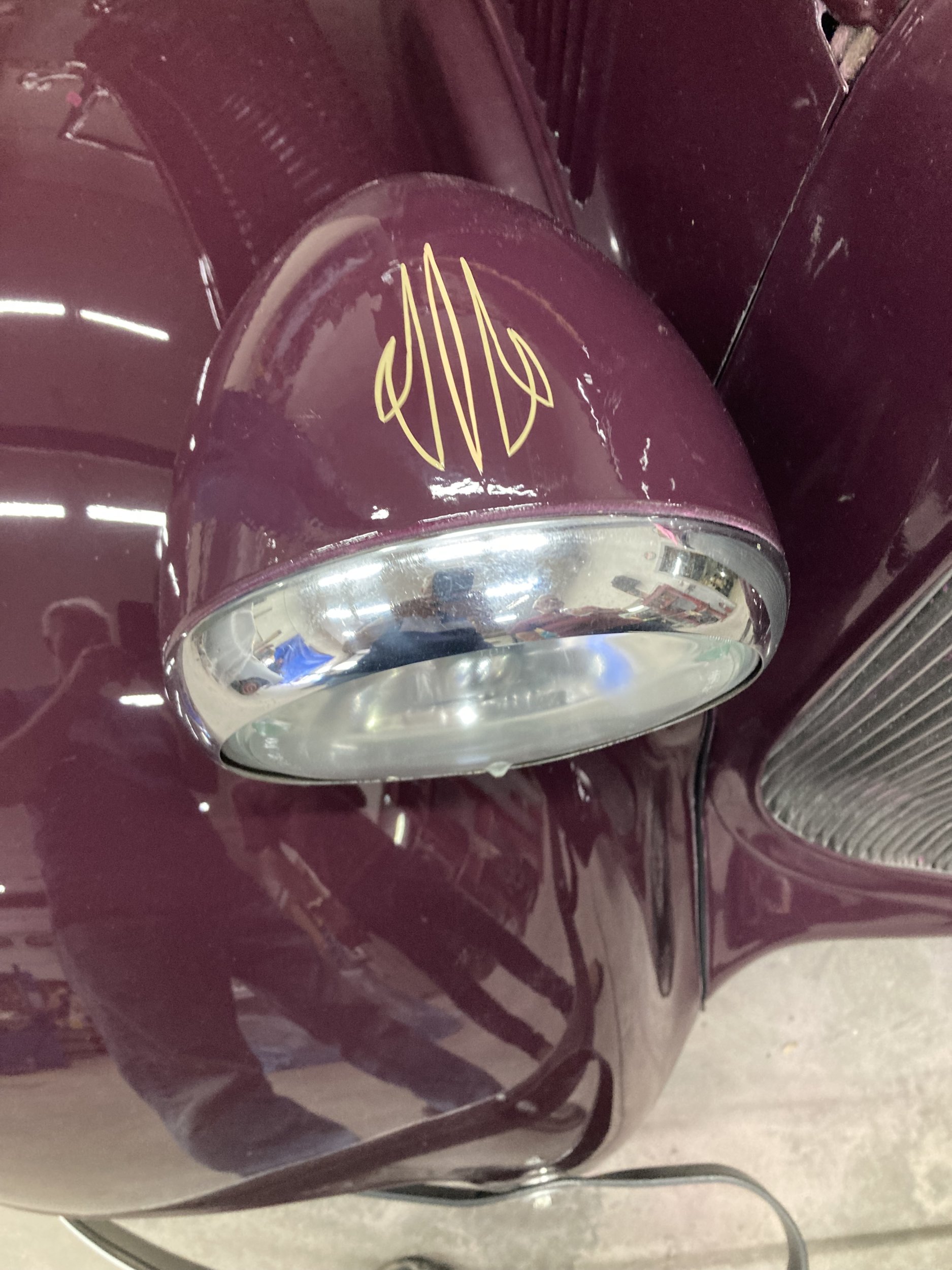

  19. notaford1
    Joined: Feb 6, 2012
    Posts: 282
    notaford1
    from webster ny

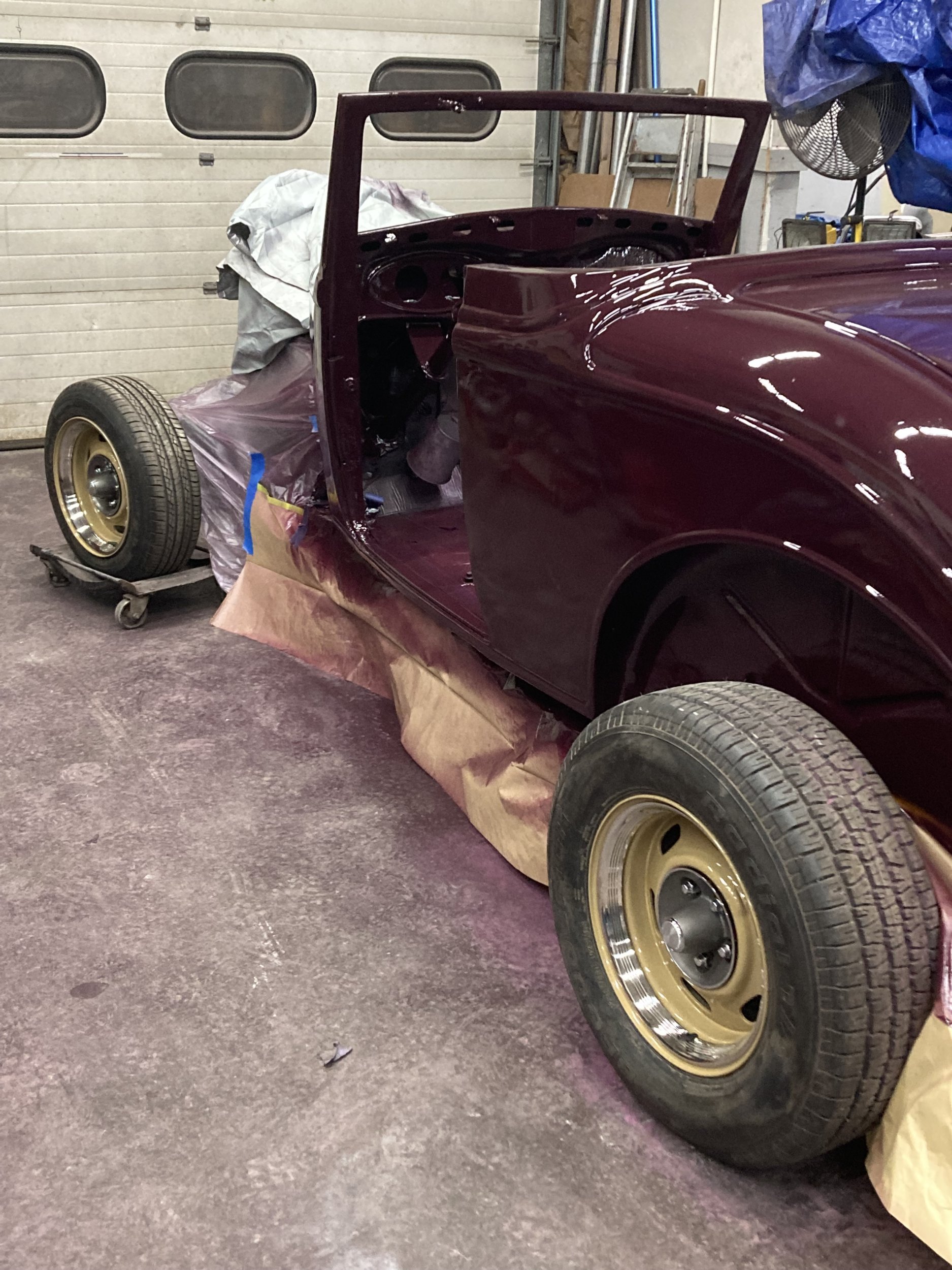

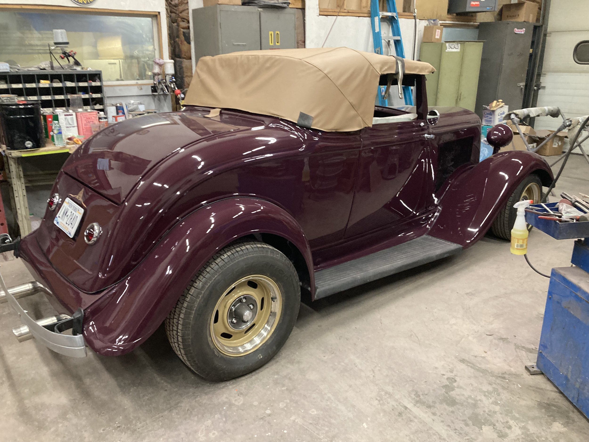

    Some more bits and pieces. Funny it photographs lighter than it actually looks in person IMG_3684.jpeg IMG_3683.jpeg IMG_3682.jpeg IMG_3681.jpeg IMG_3680.jpeg IMG_3679.jpeg IMG_3678.jpeg IMG_3677.jpeg

  20. 32fenderless
    Joined: Jun 7, 2007
    Posts: 400
    32fenderless
    Not sure how I’ve missed this thread but what neat car and a great color for it. Watching thread and excited to see progress.

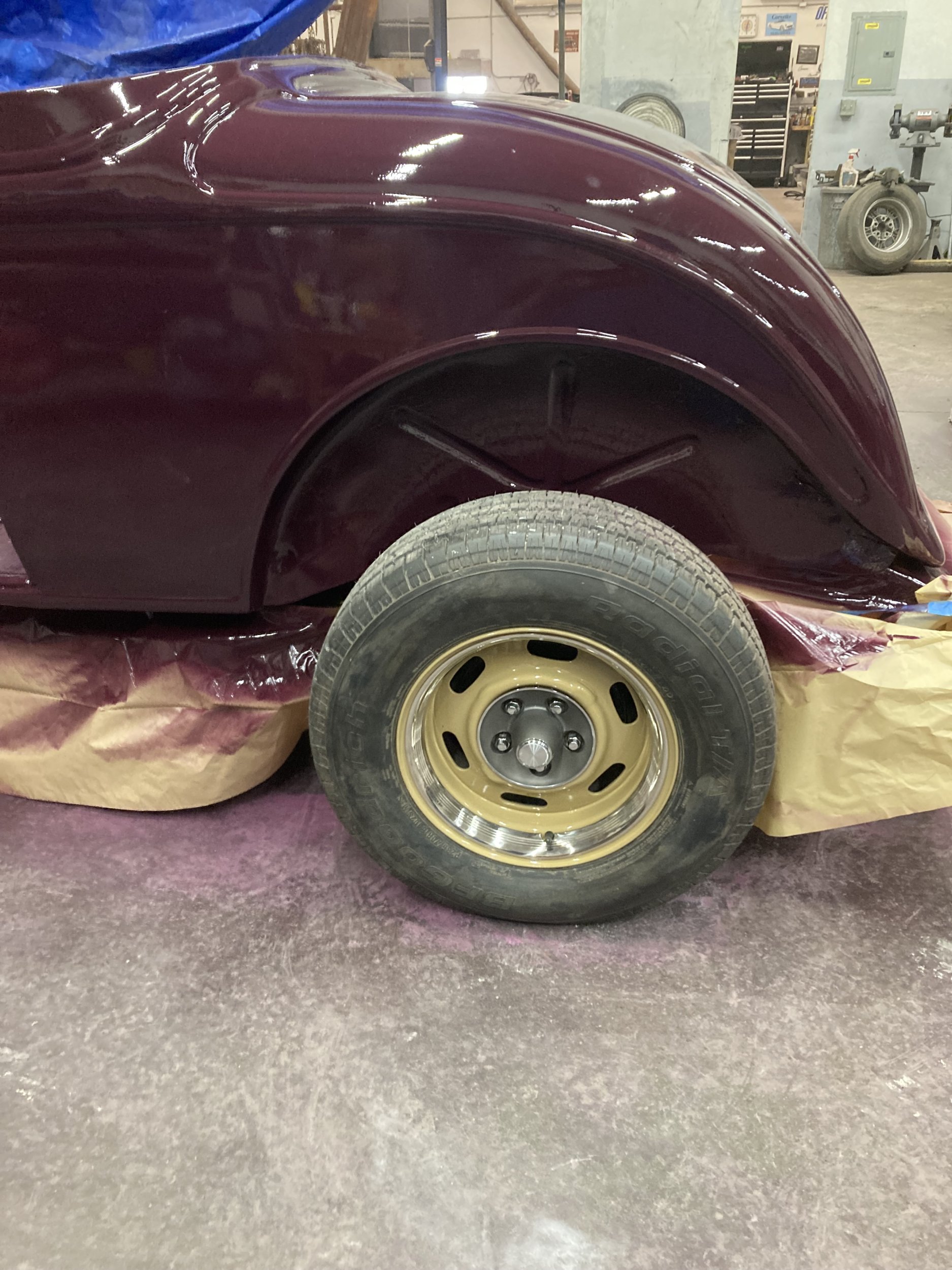

  21. notaford1
    Joined: Feb 6, 2012
    Posts: 282
    notaford1
    from webster ny

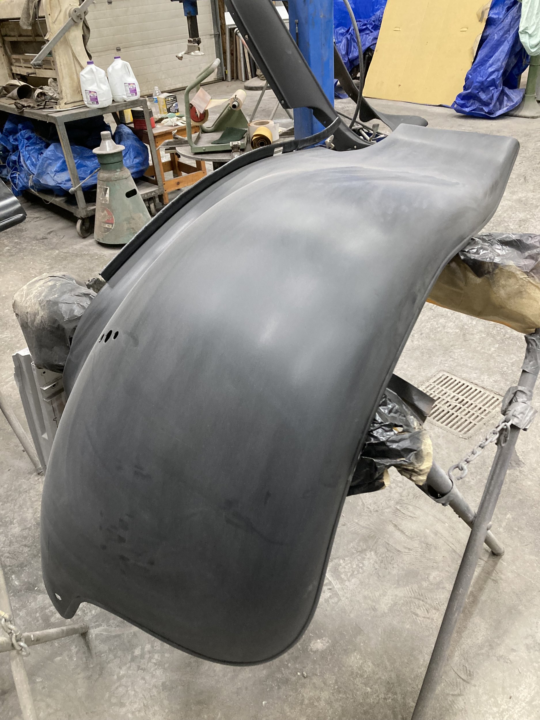

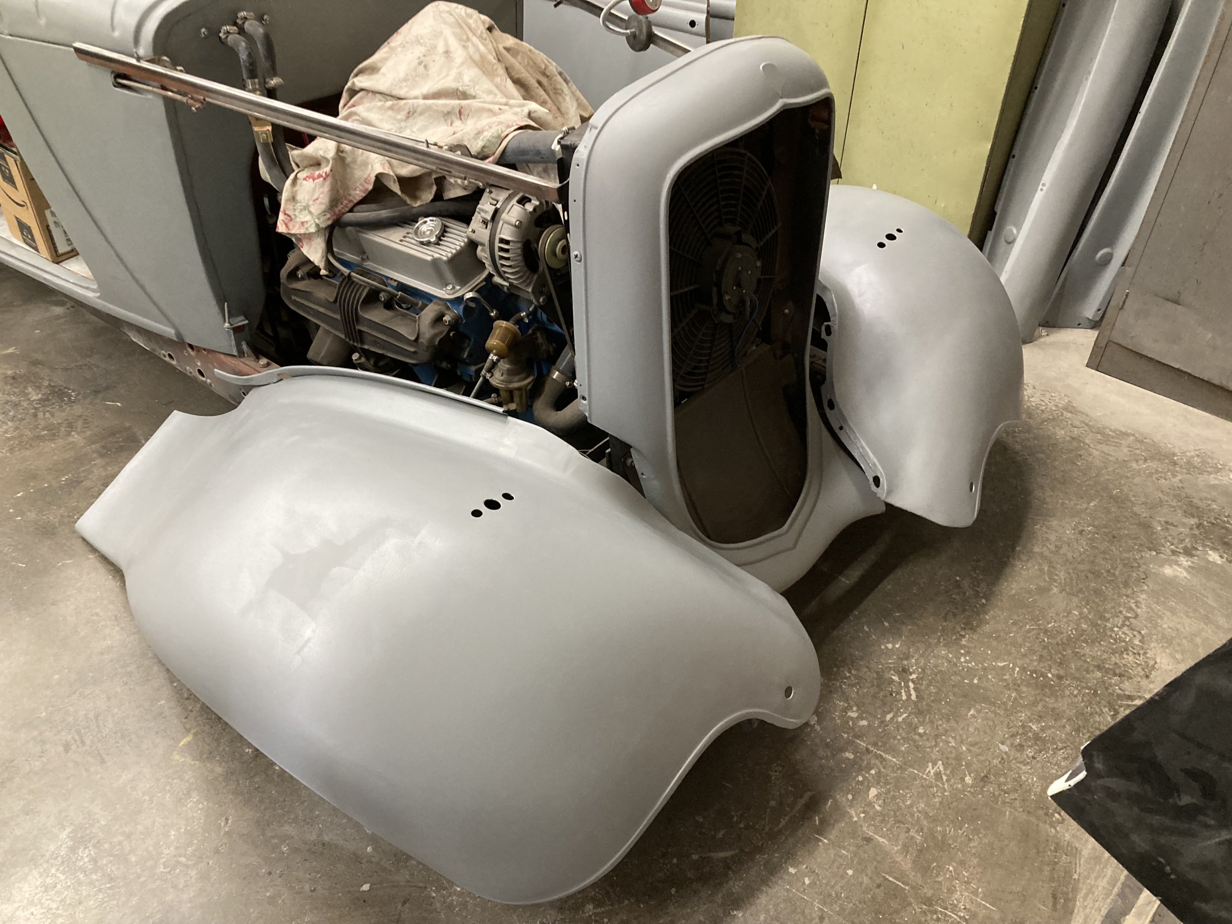

    Finally warmed up around here enough to finish spraying the rest of the parts. Now just let them cure for a few days and sand and buff. Then back to work with re***embly. I also resprayed the color on the wheels to go more with new top material and interior IMG_3721.jpeg IMG_3722.jpeg IMG_3723.jpeg IMG_3726.jpeg IMG_3727.jpeg IMG_3731.jpeg IMG_3733.jpeg

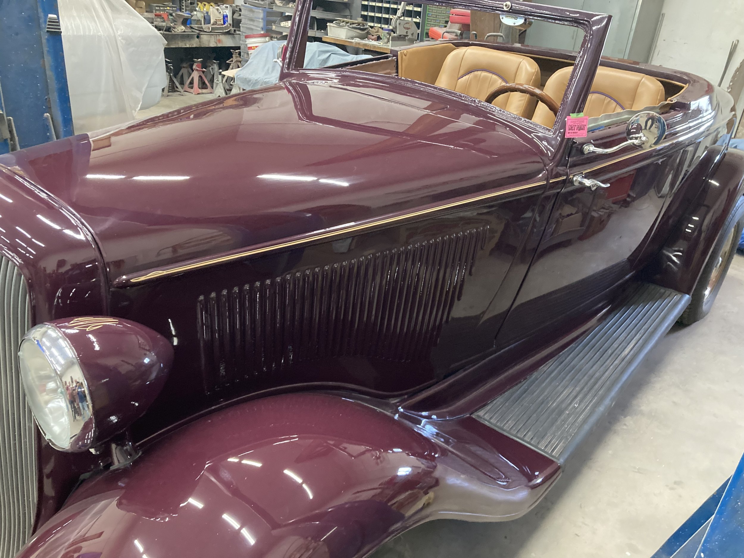

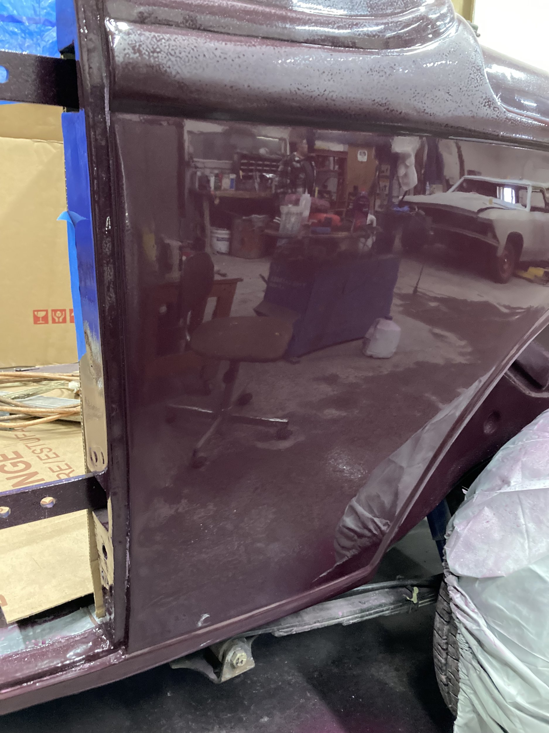

    Finally getting to rubbing out paint and getting a nice new color and new upholstery F240A21F-CA29-4598-8A81-63686D4B1BFAIMG_2827.jpeg IMG_3815.jpeg

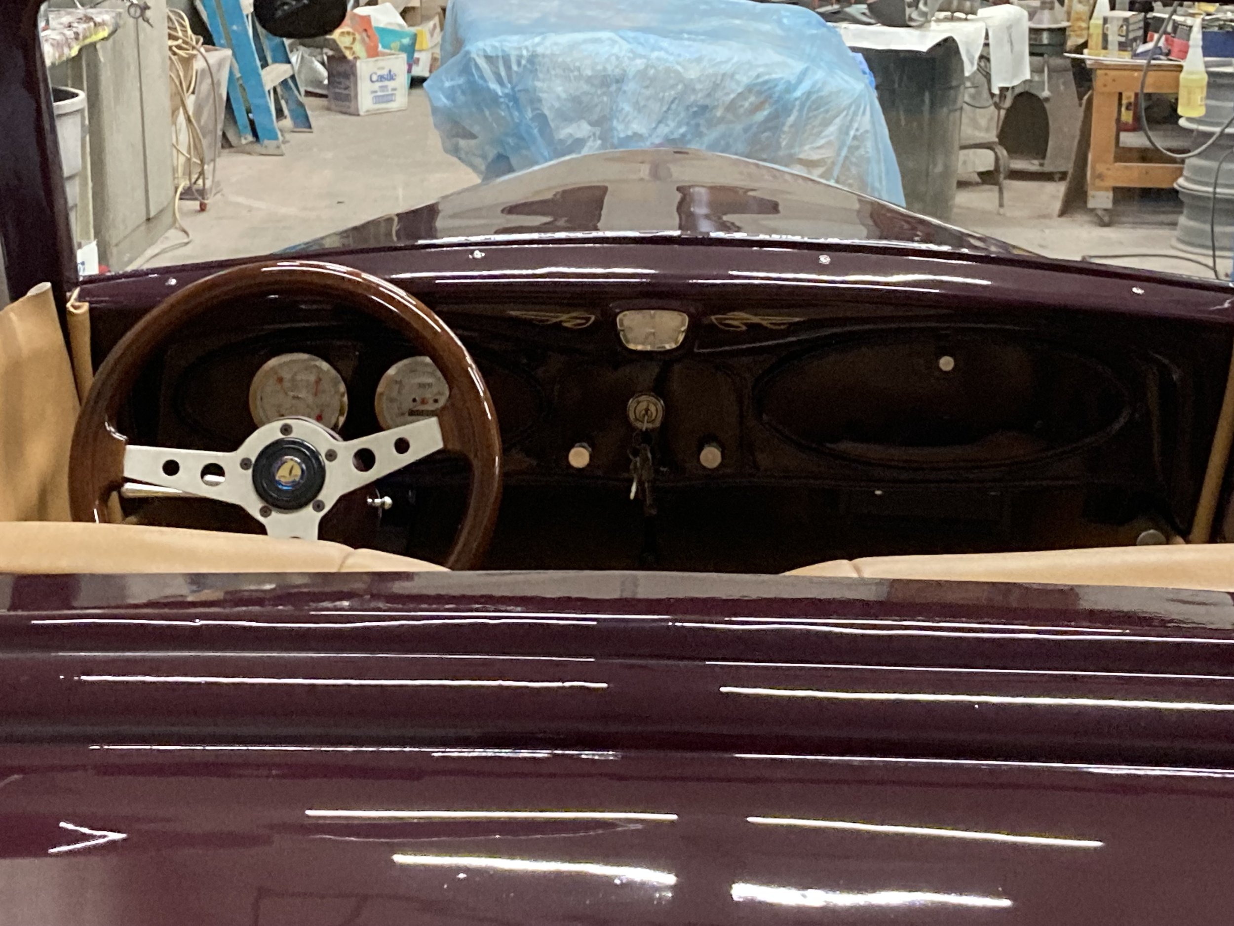

  25. notaford1
    Joined: Feb 6, 2012
    Posts: 282
    notaford1
    from webster ny

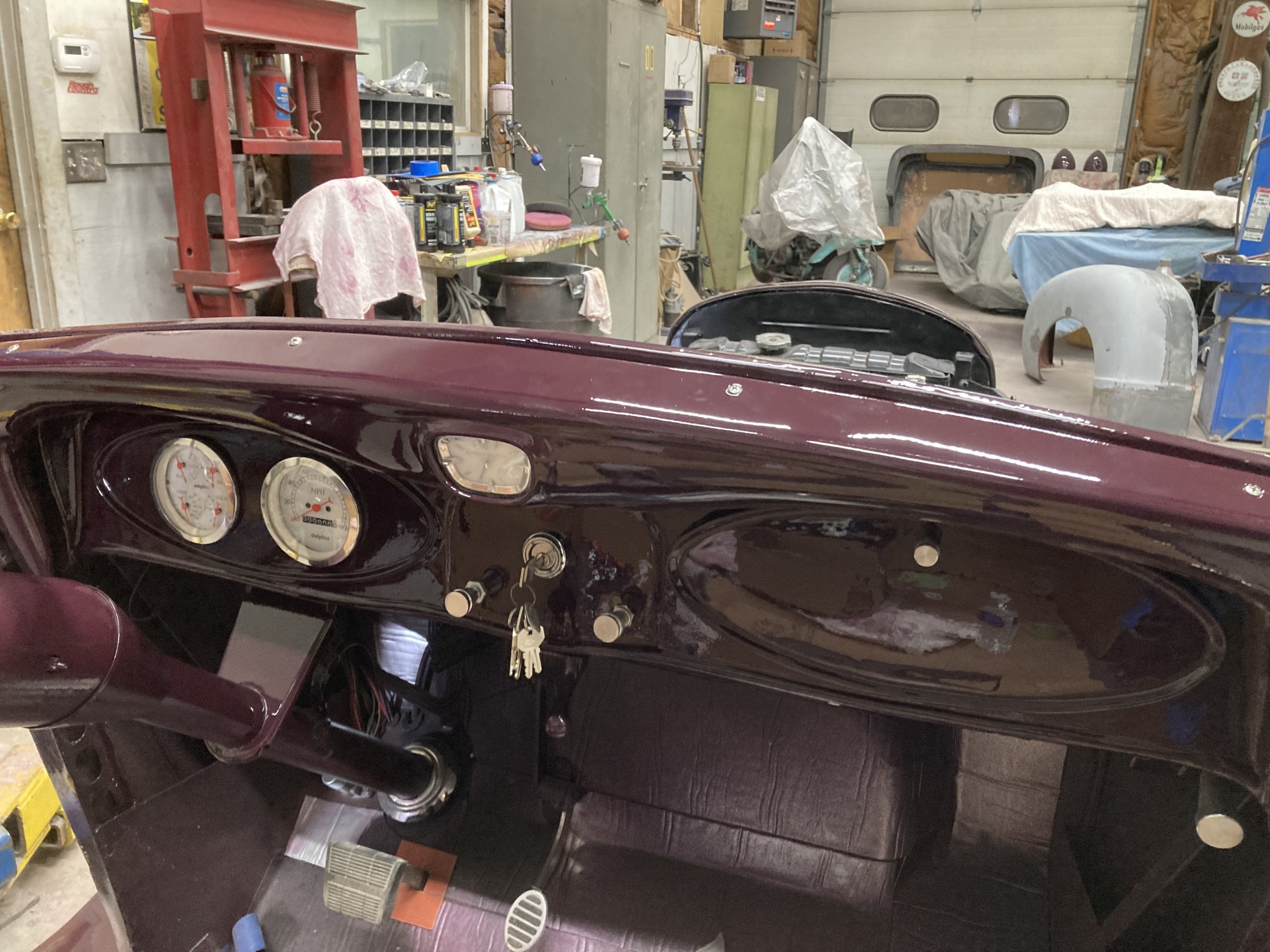

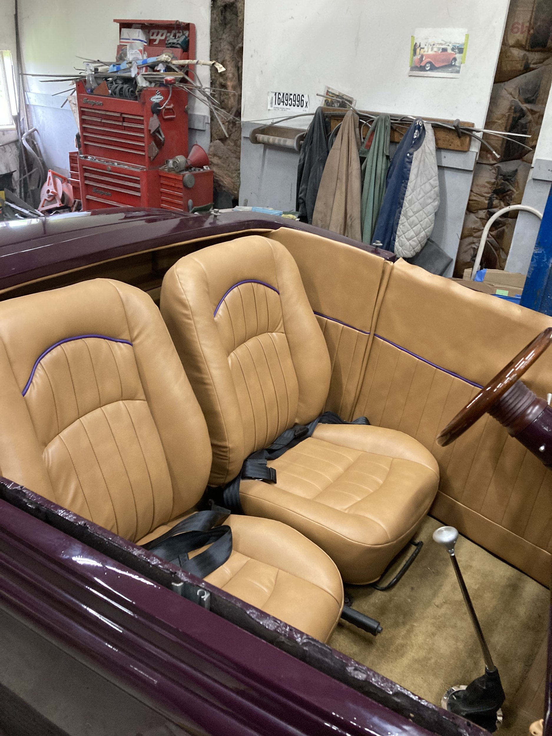

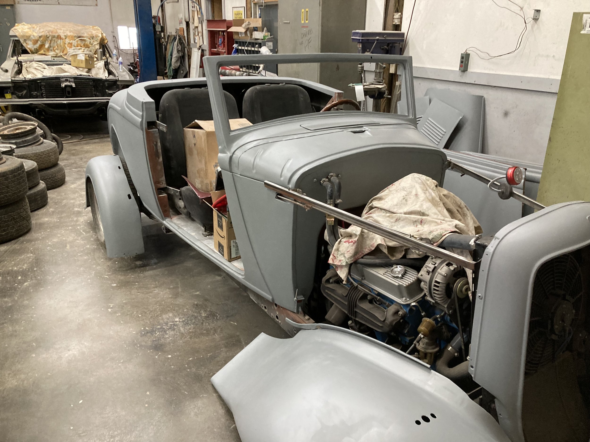

    Picked up my seats and got some more wiring and dash done IMG_3947.jpeg IMG_3950.jpeg IMG_3951.jpeg

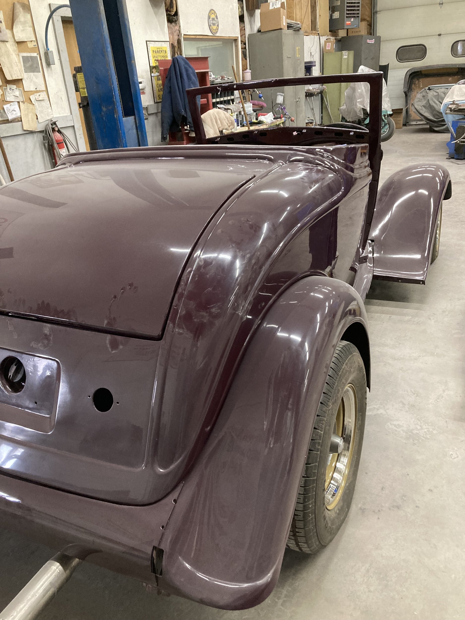

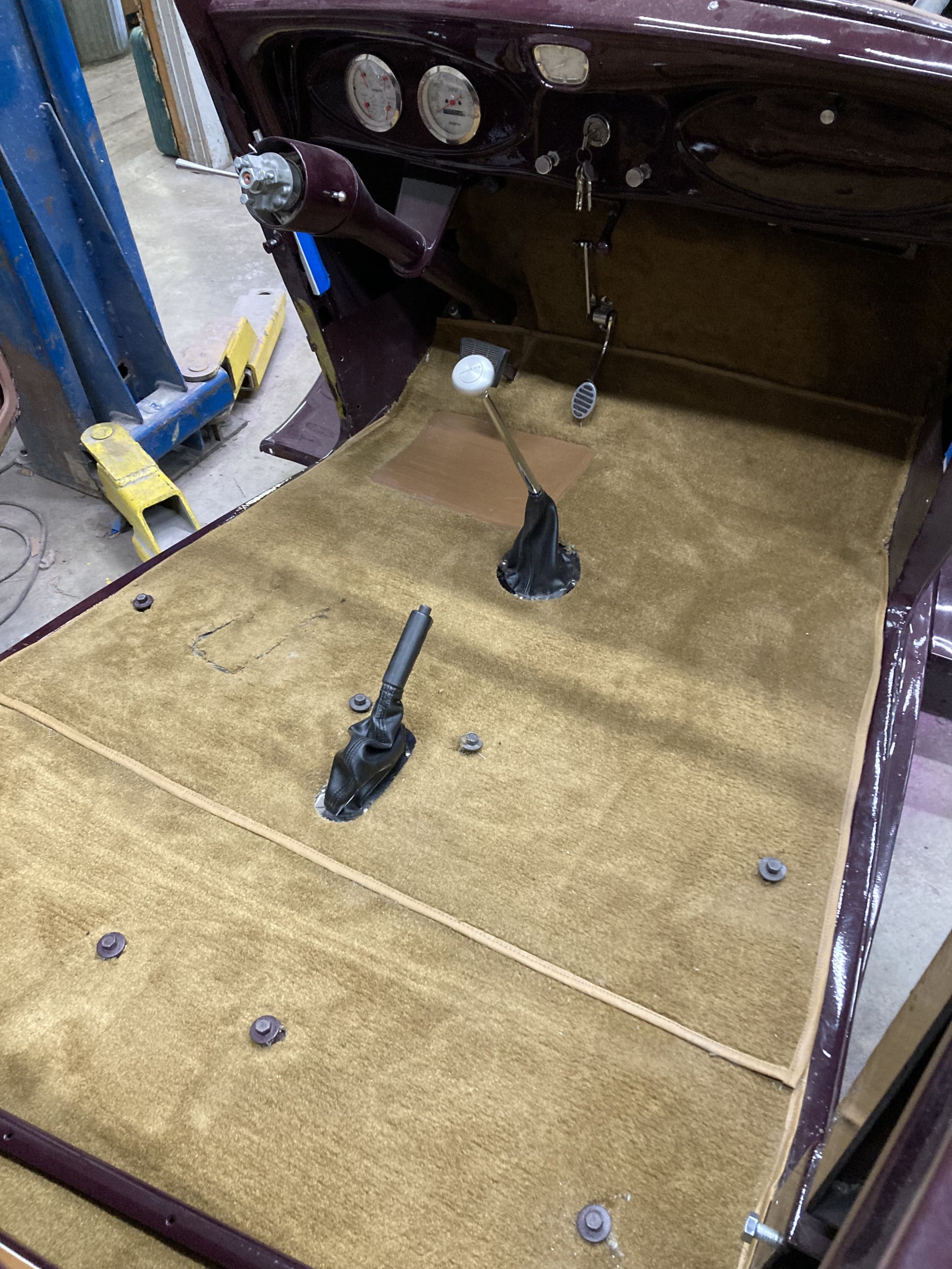

    Got rug all in and just waiting for all door panels to be s***ched up. Also finished rear of car. Taillights , bumpers,fender welting IMG_4032.jpeg IMG_4031.jpeg

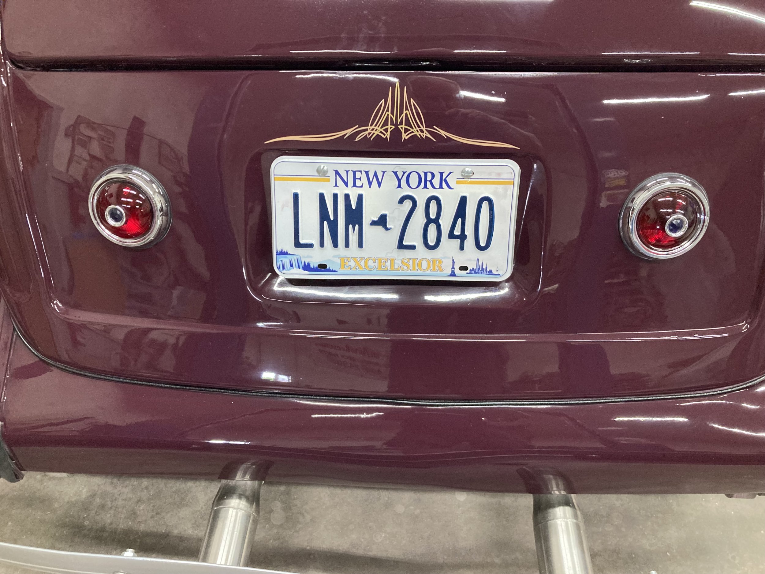

  27. notaford1
    Joined: Feb 6, 2012
    Posts: 282
    notaford1
    from webster ny
    Haven’t updated progress lately. Here are some new pics while I still wait on finish Upholstry and gl*** IMG_4567.jpeg IMG_4562.jpeg IMG_4558.jpeg IMG_4557.jpeg IMG_4556.jpeg IMG_4555.jpeg IMG_4499.jpeg IMG_4497.jpeg IMG_4495.jpeg IMG_4494.jpeg IMG_4284.jpeg

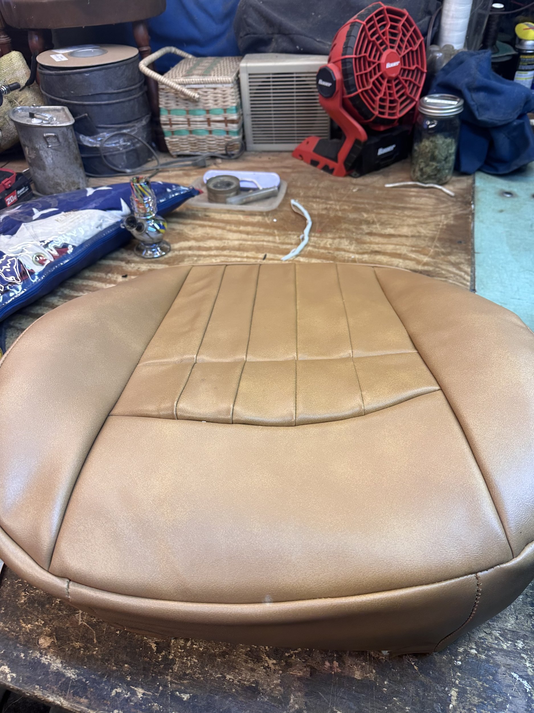

    Finally get this project near the end. Upholstery all done got front a rear gl*** in. Now just waiting for door gl*** so I can finish off door tops with molding and put in rear gl*** bezel. Than check out some details and it will be ready
