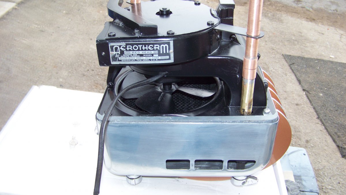

    I'm running this Francisco in my '38 with a computer fan, but the core has started leaking. It was fine with an unpressurized cooling system, but when I went to pressurized with an 8lb cap it started leaking. I soldered it, but it leaked again so I guess I'm looking for a new core.:(

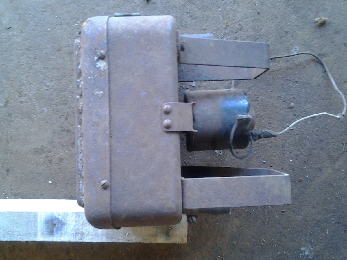

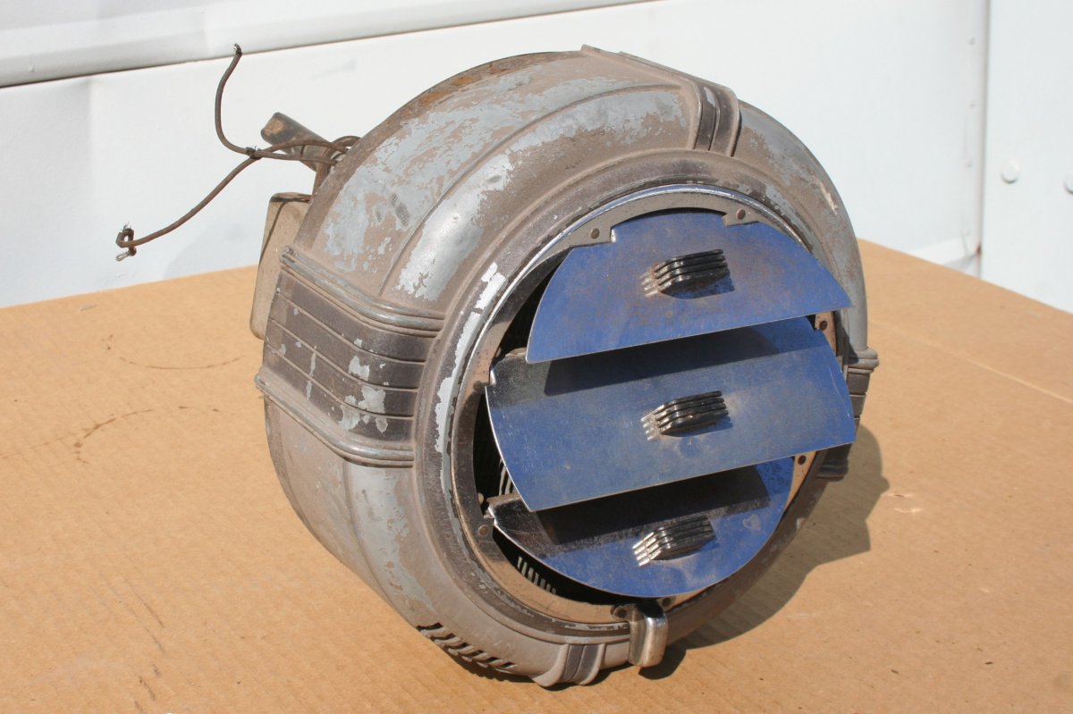

    20181111_125113.jpg 20181111_125113.jpg 20181111_125147.jpg 20181111_125247.jpg 20181111_130213.jpg 20181111_130030.jpg 20181111_125305.jpg Here's an old Sun warm heater I picked up at a swap meet. The core is rectangular I am going to use it in a 33 chevy coupe. Here's a good 12 volt motor to use its very similar in size to the one in this heater. I hope this helps someone.
    rjones35, Cosmo49, mgtstumpy and 3 others like this.

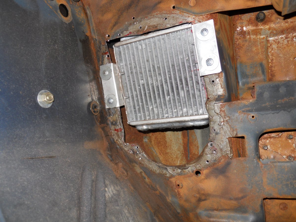

    I look on e-Bay for a heater core that will fit and mount it in the vent, I mount a ball valve on one of the hoses under the hood. The mount a 4" radiator fan in the speaker grill for a defroster. That way I can pull all the HVAC stuff. They also make tubing with ribs on it. Just run hot water thru it and you have nice heat.
    Just trying to give you some ideas..

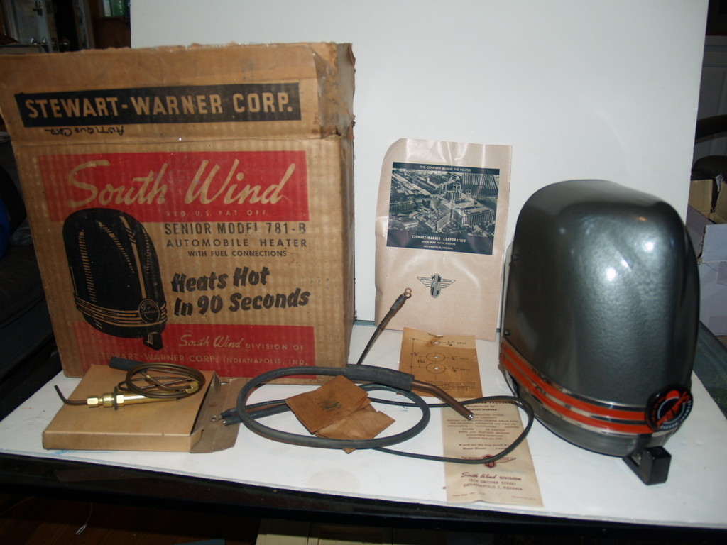

    I actually saw one recently that had been done with a [65] smaller Mustang heater core and electric solenoid for water and can't recall whether or not it was on HAMB. Once heater was repainted it looked great; you wouldn't know about the recore. I have a NOS Southwind (Stewart Warner) however I WON'T be using it the way it was intended nor will I be gutting it for a rebuild. Plenty of cores still out there.

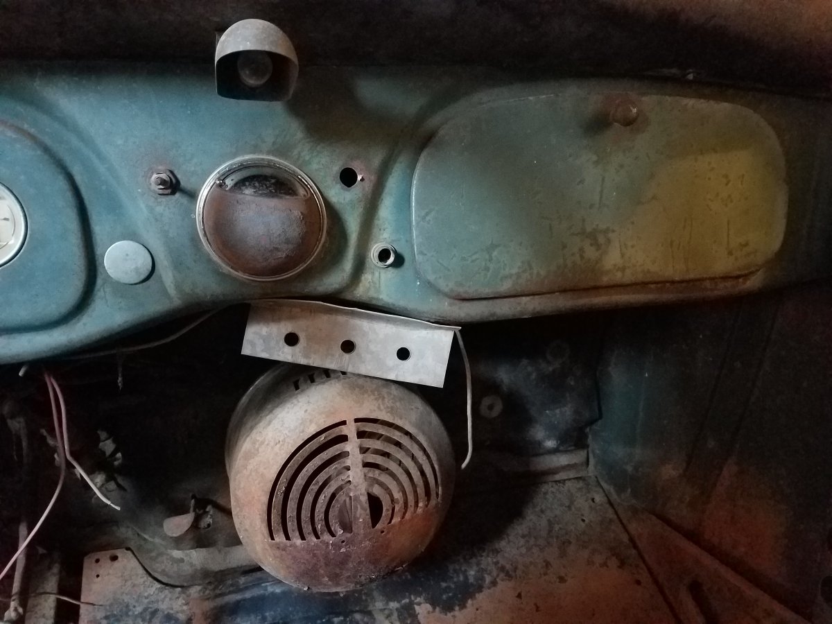

    I came across this stude heater in a swap meet box of parts. Ran 12V to it and the fan came on
    [​IMG][​IMG]
