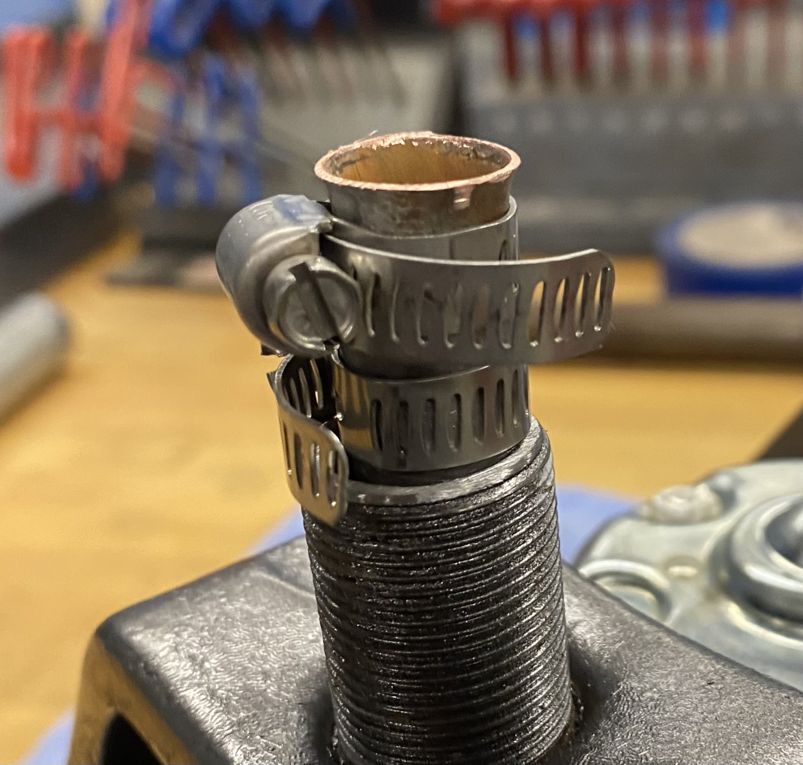

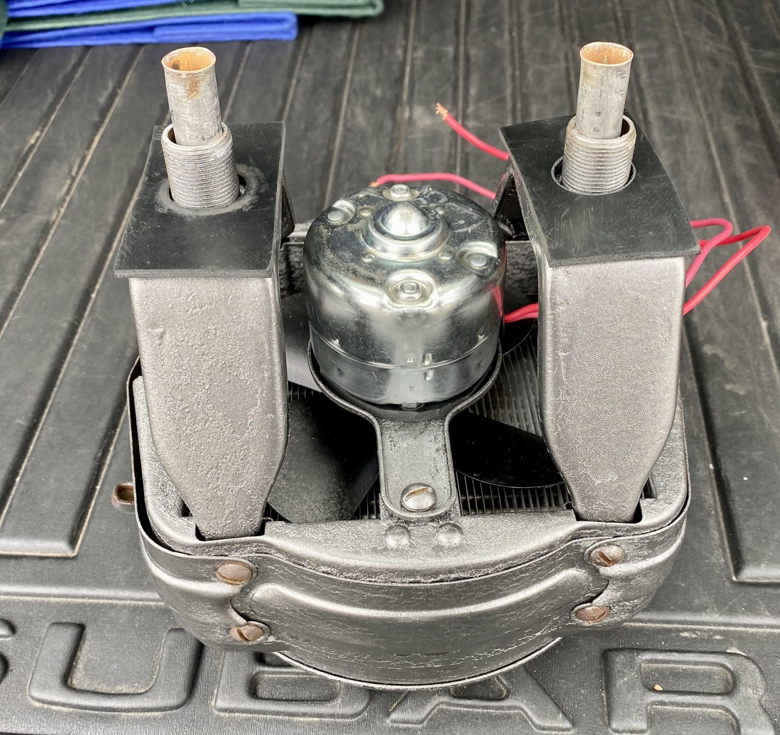

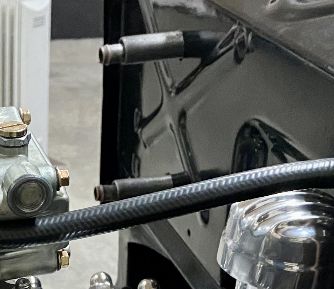

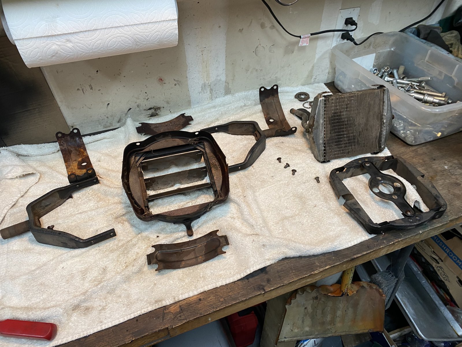

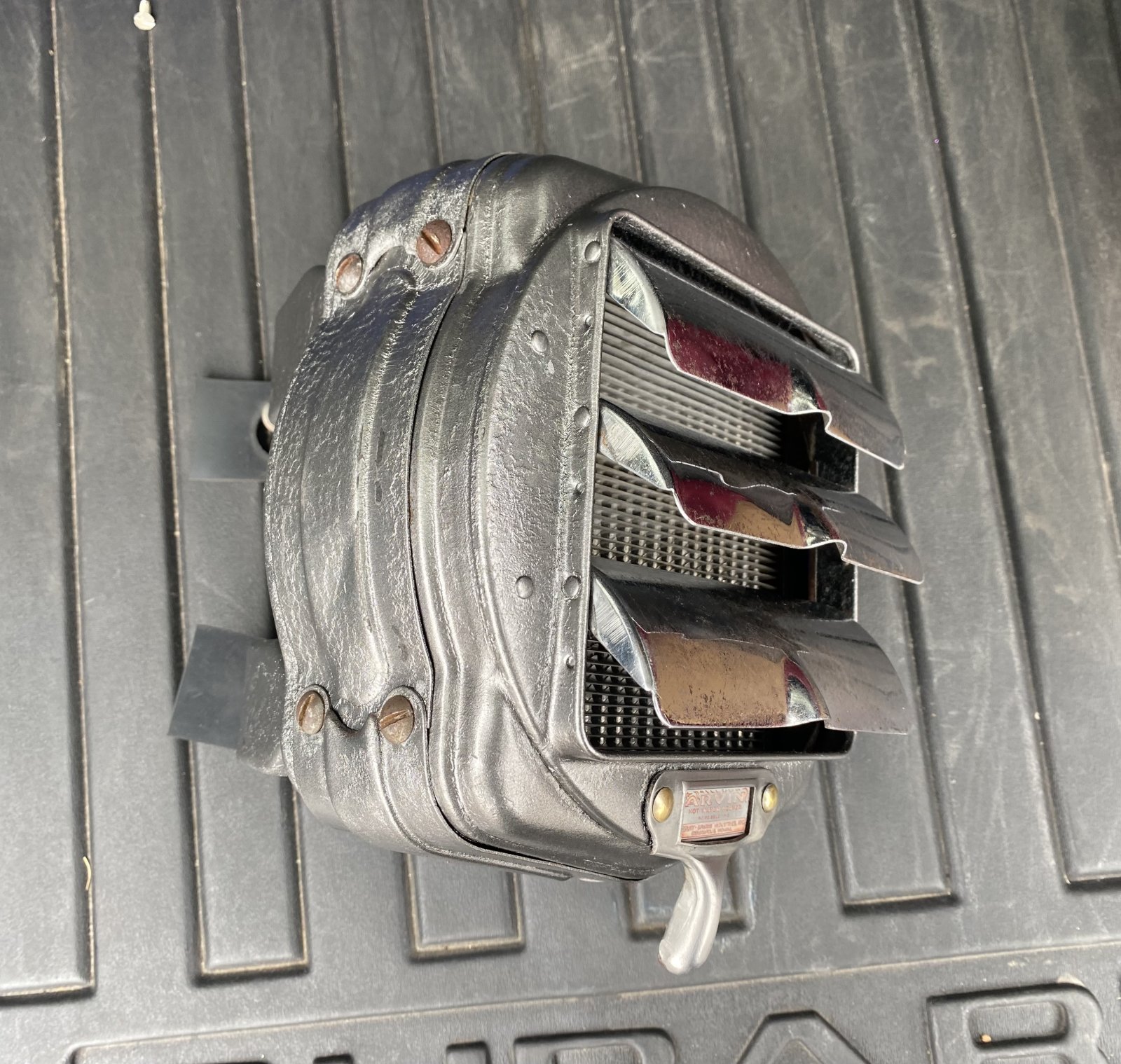

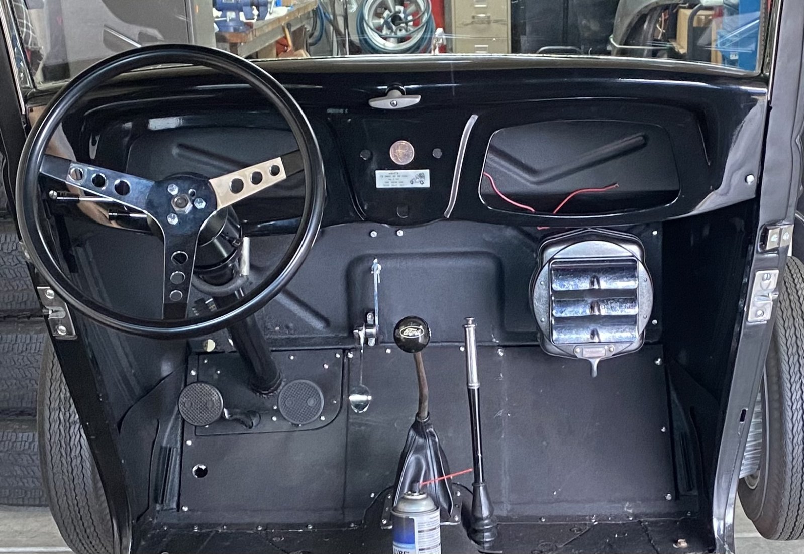

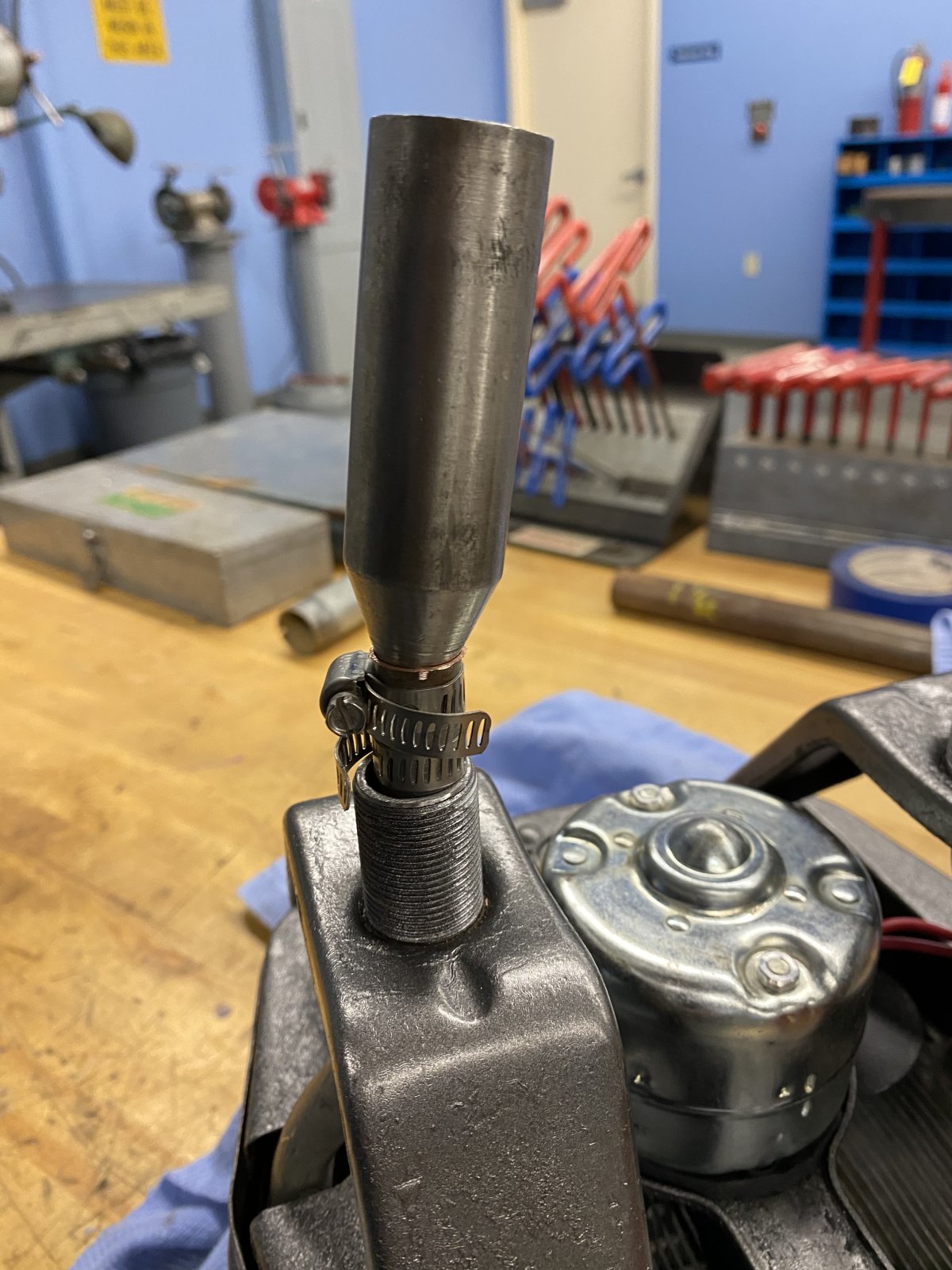

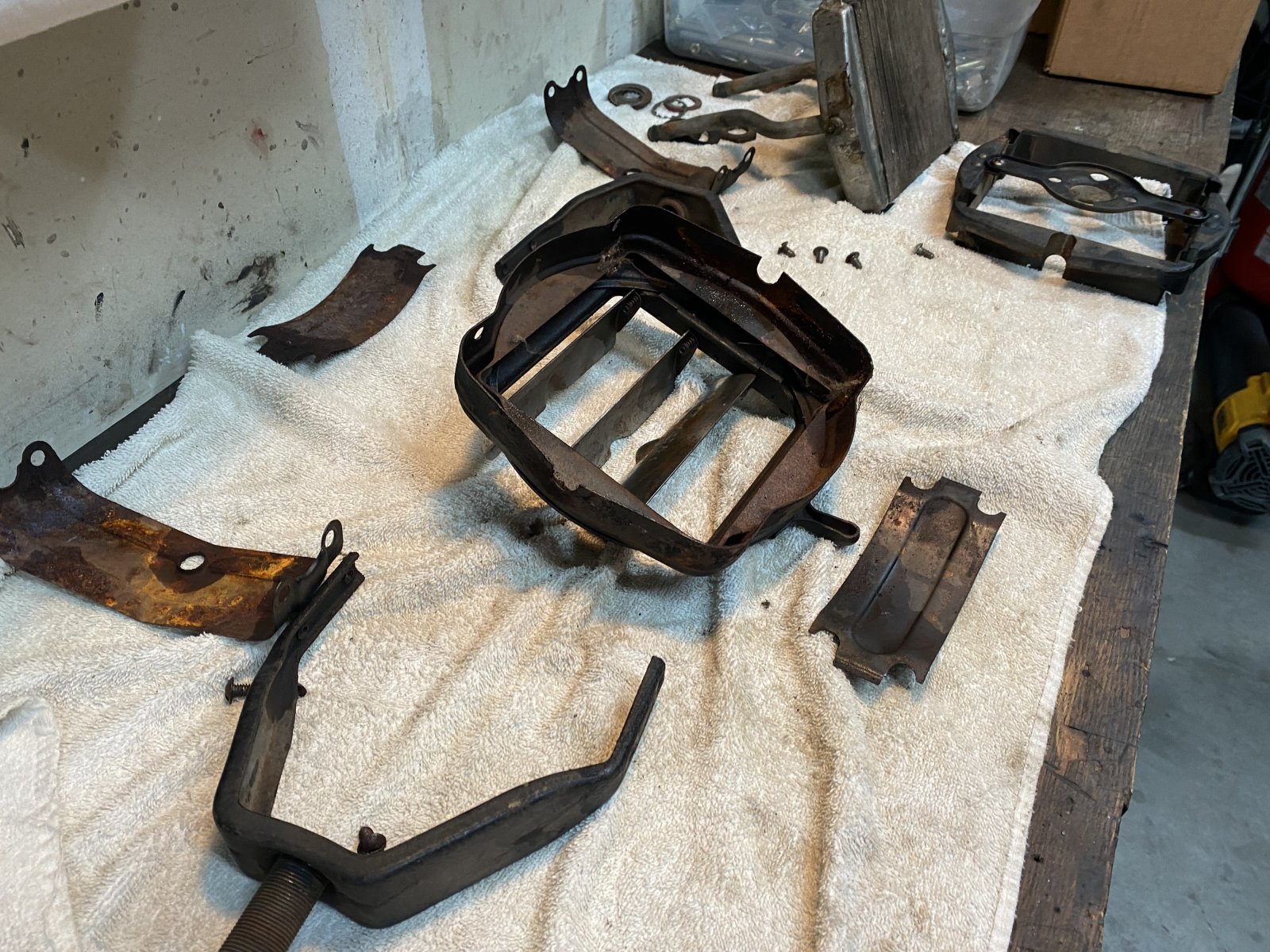

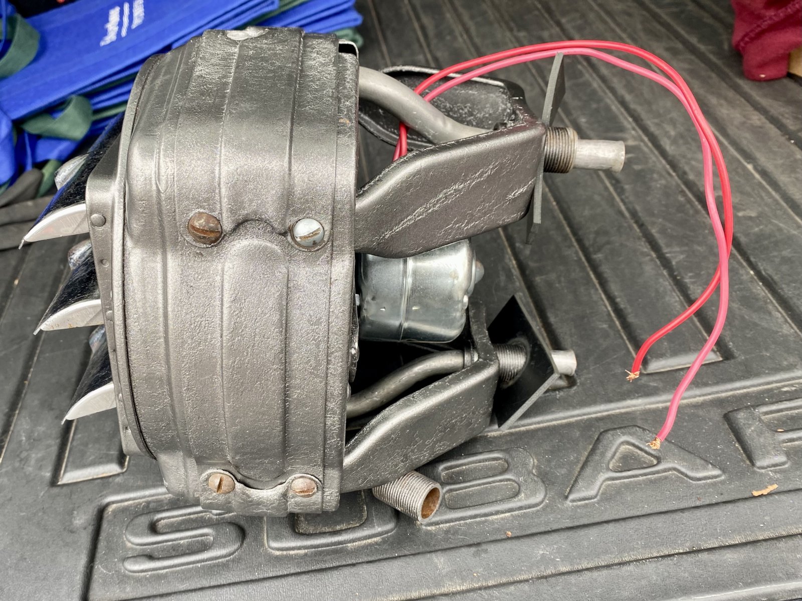

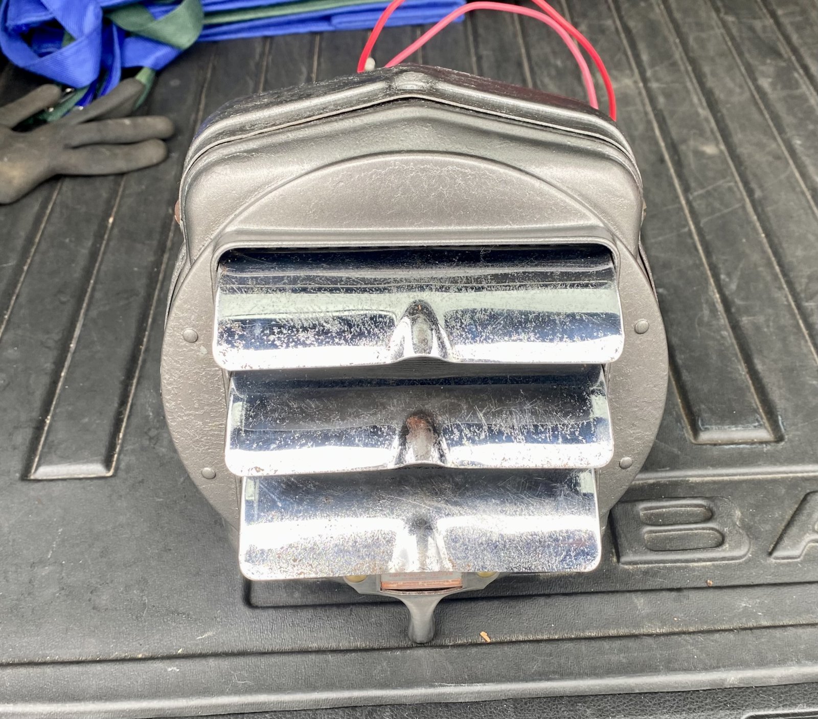

    BCD20D2D-F031-401C-8F28-47437DEF8190.jpeg 20F42486-9D03-45FF-AA0B-287EBED78727.jpeg BCCAE7C2-6FC8-487D-87A8-9ED77C830F67.jpeg 83C4BD8B-BC25-413D-9EEC-829D10ABF732.jpeg 05EF6D3E-BB47-429B-98A6-101C822F0B4E.jpeg 20319AE1-AA02-4EAD-9932-755A328FC685.jpeg C407B6CD-E046-4287-A990-70AF90CBB34E.jpeg 64A04ED1-E4DA-450D-B1D7-AF6085D3F3A0.jpeg 3B5207A9-5153-473C-AA94-1AC5726D6C7E.jpeg CFF0FB0F-5729-4874-A3E8-695CBFEB57AA.jpeg 9D5E669D-2A62-4C13-8960-3AEF6E6854BE.jpeg Heres Mine!
    It’s got some mileage on it, but it’s in really good shape. I cleaned it up painted it polished chrome even though it’s pitted it goes with my Worn-look anyway.
    12 V motor I got off of eBay a long time ago have no idea what brand it is?
    It’s counter clockwise though luckily, I had another 6 V heater that was counter clockwise, so I stole the fan off of it!
    I shorten the threads and the tubes and re-flared the ends.
    It’s roughly a 1930-35 Arvin mini heater. I got a Mustang/bronco 60s 70s manual control valve with a choke cable I’m gonna use,
    For throttling the heat.
