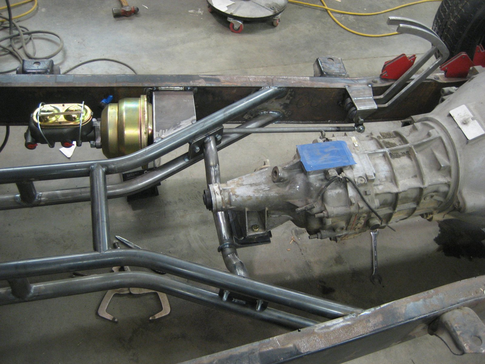

    Finally got my pedals mounted, and now more questions. The booster will be 18" away from the pedal, and the rod will have about a 1/2" rise to it. Will this be a problem? I can change it, but then it puts the booster closer to the ground. Is there anything else that you see wrong in the pictures? Just tacked in for now, so changing things is easy. 37 dodge 003.JPG 37 dodge 009.JPG 37 dodge 011.JPG

    At that distance ( 16" to 24") I'd use minimum 1/2" thick wall rod. I would be OK with 1/2" rise over that distance (18") as the stroke would be close enough to being on line with the bore centreline. If possible, adjust booster slightly to ensure a straight push.
    Also consider a simple return spring at the M/C booster end.

    You want the input to the booster to be as straight as possible. I would angle the booster to eliminate/minimize any angle between the long pedal push rod and booster input rod.
    I would strongly recommend adding a bushing or bearing support at the end of the new push rod, very close to the new junction, to prevent the factory booster rod from being forced out of alignment and damaging the booster control valve or binding.

    1/2" over 18" is fine. On a spring, just make sure it also doesnt push the rod out of the hole by using stops.

    1937 brakes 001.JPG 1937 brakes 004.JPG I got my booster and m/c mounted last night, then noticed that the m/c was leaning down towards the p***enger side of the truck by about a 1/4 inch, I thought it should be level. Went out this morning to cut my mount off and redo it, but it is level and where it should be. Upon further inspection, I found that the problem is in the mounting bolts of the booster. Is this normal, or do I have a screwed up booster? Are they designed this way for air to get to the top? In these pictures the 4 mounting bolts are level, and the m/c bolts are not.
  20. F&J
    Joined: Apr 5, 2007
    Posts: 13,291
    F&J
    It's up to you if you want to cut off the bracket to level it.
    Many factory masters are tilted front or back without an issue, so a tilt to one side will also work fine.
    or....Can you elongate the holes in your welded bracket, to rotate the booster a bit?

    Yes, I can elongate the holes, but I prefer not to. I am wondering if this is normal, or if the booster was made wrong?

    Will I break something in the booster if I bolt it down and rotate half of it to get the m/c sitting level?

    Most likely it will split the membrane like a condom on "load". Your call if it is worth the risk, or you can live with slanted master.
    If it drives you crazy, fix it of swap it.
  24. That's the way to ***emble and dis***emble the booster. It's possible to rotate it, it's possible that it's over or under rotated out of the box

    I agree on that there is two parts of the housing, and between them there is a rubber part. And it should be possible to separate the two parts and put them back together.
    It can end up as you want it to be, or with a leek.
    And they are put together in to half over the rubber. So fare, so good.
    But with a lot of muscle just moving/turning it to the right position, will most likely cause the rubber to break/shear.
    80-20 is the best odds, and that's against you.
    But separating the two half is 50/40/10 being success/small leak/failure.
    I know how little it take to damage the rubber in an actuator for air brakes (large trucks), but what you are asking I never seen done. But I think very few people have.
    I'm not saying this to undermine you, just bringing my experians to the table. We might be in agreement about this, and I just might have misread you post.
  27. If the booster was recently put together, I don't think you'd have one iota of trouble rotating it. It was rotated into position during ***embly-right.
    If the booster was older and used and saw many underhood heat cycles you are likely to damage the seal.

    It is a new 8 "dual diaphragm booster.

    I got everything mounted and level and am happy with it. I took a chance and rotated the booster, let you know how it turns out when I finish the brake system. 37 dodge 006.JPG 37 dodge 009.JPG It was a productive couple days in the garage. Brake and clutch pedal mounted. ****** mount done. This is the first time in 2 1/2 years that the motor and ****** is in the truck with no wooden blocks holding it up. I can officially push the truck around, THANKS H.A.M.B.
