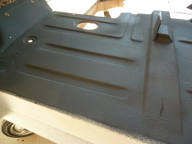

    Everybody likes pictures so here's a couple of my 56 F100 cab. I sprayed the floor, top and bottom, with the lizardskin and then coated the underside with bedliner. I use the 3M/Marhyde Truck Guard Pro...no sense messing around with roll on non-catalyzed stuff when you can get the good stuff for not much more $$$.

    Thanks for the pics Charlie! Out of curiosity, is LS sandable?

    It is but if you did sand it then you would be destoying some of the insulating spheres and reducing its effectiveness. If you wanted a smoother finish then I would suggest spraying a coat of high-build 2K primer over it and then sanding it smooth if necessary.

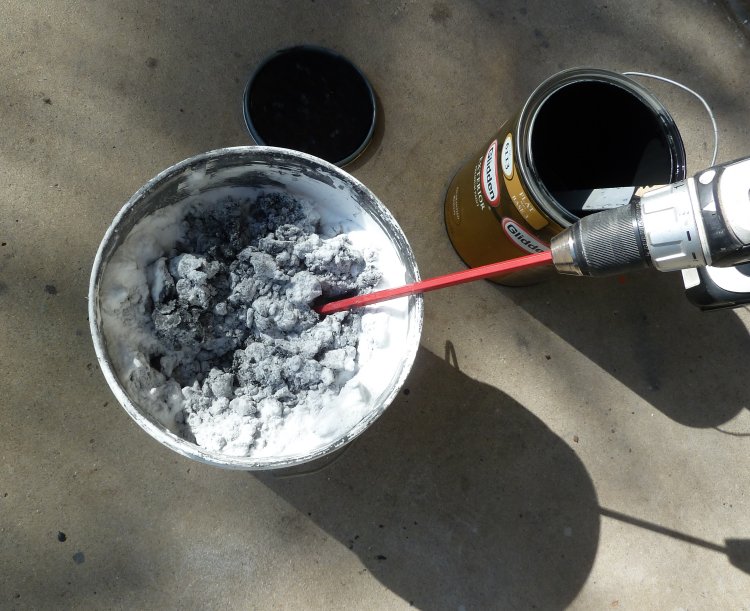

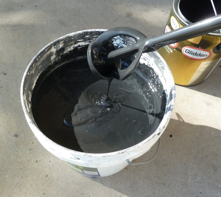

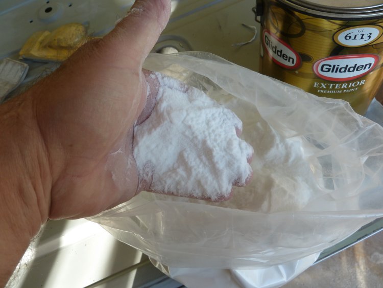

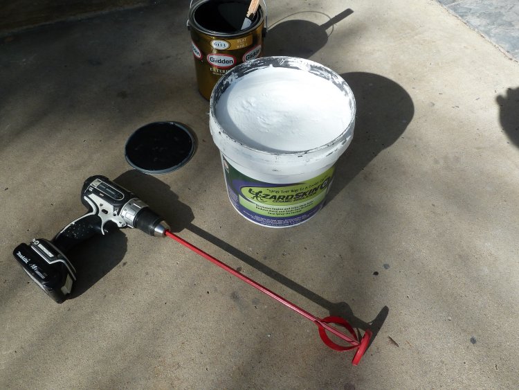

    Making the "lizardskin" is relatively simple, it takes a little while to get the spheres mixed into the paint but a drill mounted paddle mixer makes the job easier. In the pictures below there is a 1 pound bag of spheres (some call them balloons or bubbles, all the same) sitting next to a gallon of the paint (I use black but any color will work) I use. As you can see, when these two components are mixed together they will make about 2 gallons of "lizardskin". The consistency should be like cake batter when you spray it. The other picture hows how fine these spheres are...they just float off your hand like granulated sugar only lighter in weight.

    Since I am on the subject I figured that I would go ahead and mix up a batch just to do***ent how it's done and what you can expect if you do it yourself. In photo 1 I have poured in the 1 pound bag of microspheres and the gallon of paint...as you can see the microspheres sit up on the top of the paint and the level is close to the top of the bucket (this is an empty Lizardskin 2 gallon bucket by the way). In photo 2 I have mixed the paint/microspheres with the drill and paddle attachment for about 5 minutes, you can see how lumpy it appears...NOTE: no matter how much you feel that you need to add water or to in any way thin this mixture DON"T DO IT! In photo 3 you will see how nice and smooth the mixture has become with just a few more minutes of mixing. Don't overmix, once it's to this point you are done.
    At this stage the mixture is ready to spray, if you want to push the envelope you can add in even more microspheres...you are only limited by the viscosity of the mixture, add as much as you want until the mixture gets too thick to spray. A lot will depend on the viscosity of the paint that you start with.
