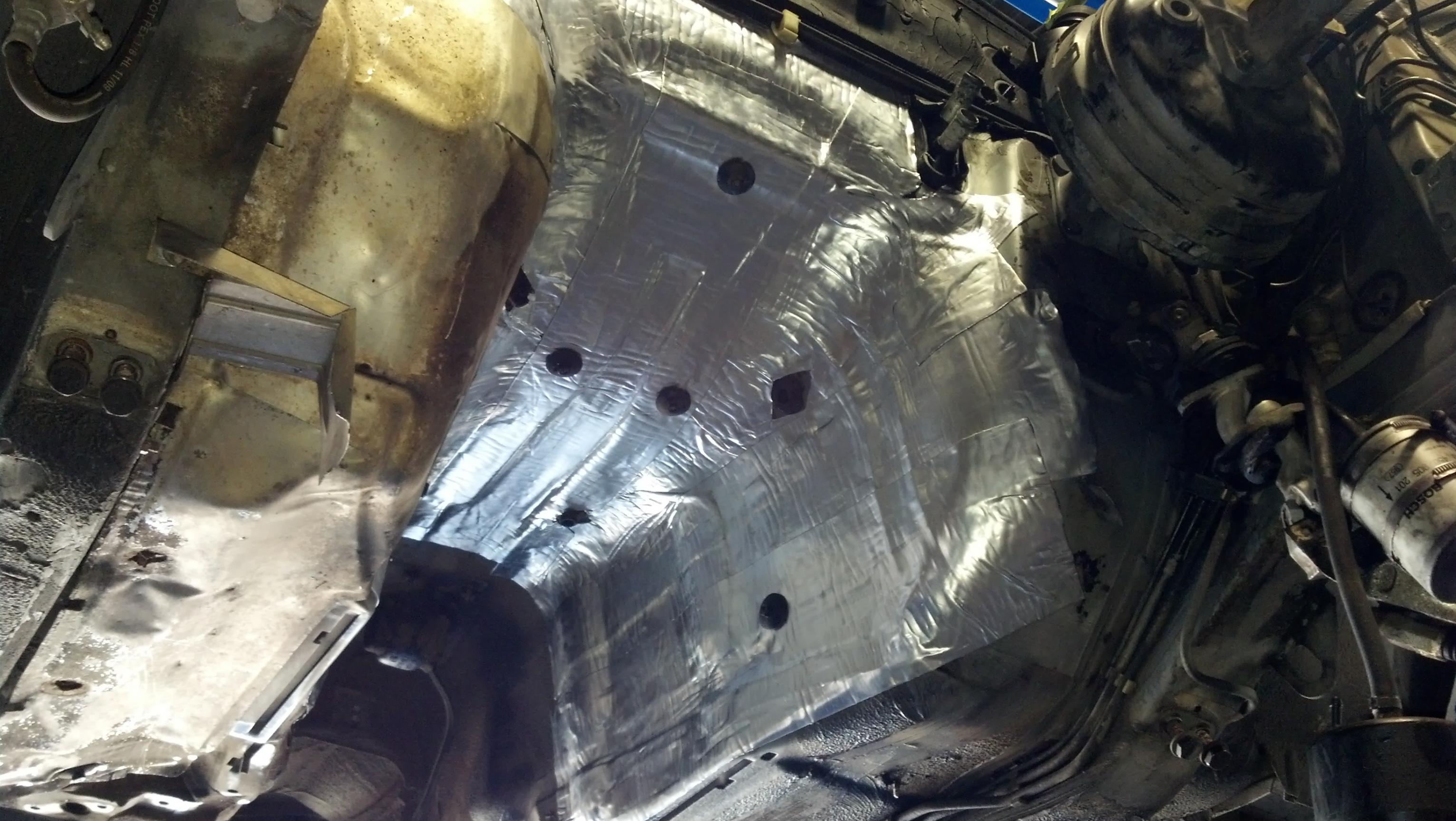

    Quick and easy. Works great. Available everywhere. Cheap. Easy to apply. :D
    Way better to have it inside under carpet, cause it can be layered and just bombed everywhere, but this interior isn't getting stripped.
    Ain't an old hot rod, but an old BMW I'm putting a different drivetrain in it. Nailed it with the crud thug, brake cleaned it and scrubbed it down. Applied.
