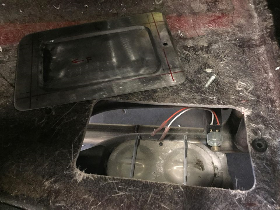

  11. Just Gary
    Joined: Oct 9, 2002
    Posts: 5,911
    Just Gary
    1) Metal floor.
    2) Rectangular hole with a flanged edge.
    3) Screw-on cover.

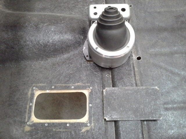

  14. tfeverfred
    Joined: Nov 11, 2006
    Posts: 15,788
    tfeverfred
    In my T Bucket, I cut my hole out. I attached the removed piece of fibergl*** to a sheet of metal cut slightly over sized. It fits flush to the floor. K.I.S.S.
