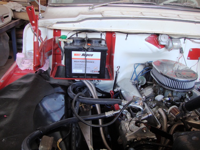

    In your picture of the compressor mounted on the small block Chevy. You have it mounted so the hoses exit down. They recommend that they be mounted with hose outlets no more than 90 degrees down from vertical. Call Cl***ic auto Air or Vintage Air for their opinion.

    Thanks for the heads up on my compressor orientation.
    It is a bad pic really, as it was never finally installed that way. Now the outlets are pointed up and the previous pic's were taken during making the mounts.
    For the record, the compressor outlets need to point upwards from what I know to prevent loss of oil that is contained within the gas system for lubrication.
    With outlets pointed up rather than down the oil will always run back down and remain in the compressor body.
    In hindsight I probably should not have even posted those compressor pics as I would not want to give a newbie the wrong idea...

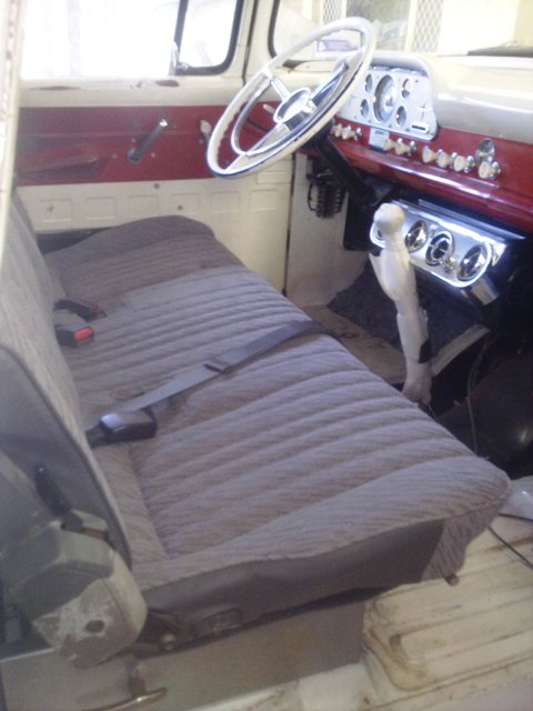

    Location of the under dash evaporator box make a big difference. This car has a small footwell and the box is mounted to the right (p***enger side) of the shift lever (in 3rd gear). Yesterdays test drive proved that this location does a great job of cooling my right ear lobe.
    Ideally, center mount the evaporator box, both driver and p***enger get an equal shot at the cool air. In this case, the shift lever is in the way, I will have to twist the box toward the driver - still pondering the "how"...
    Air conditioning is 10 # of "stuff" in a 5# sack. This is the smallest evaporator box (from a vendor that I trust) in my searching.

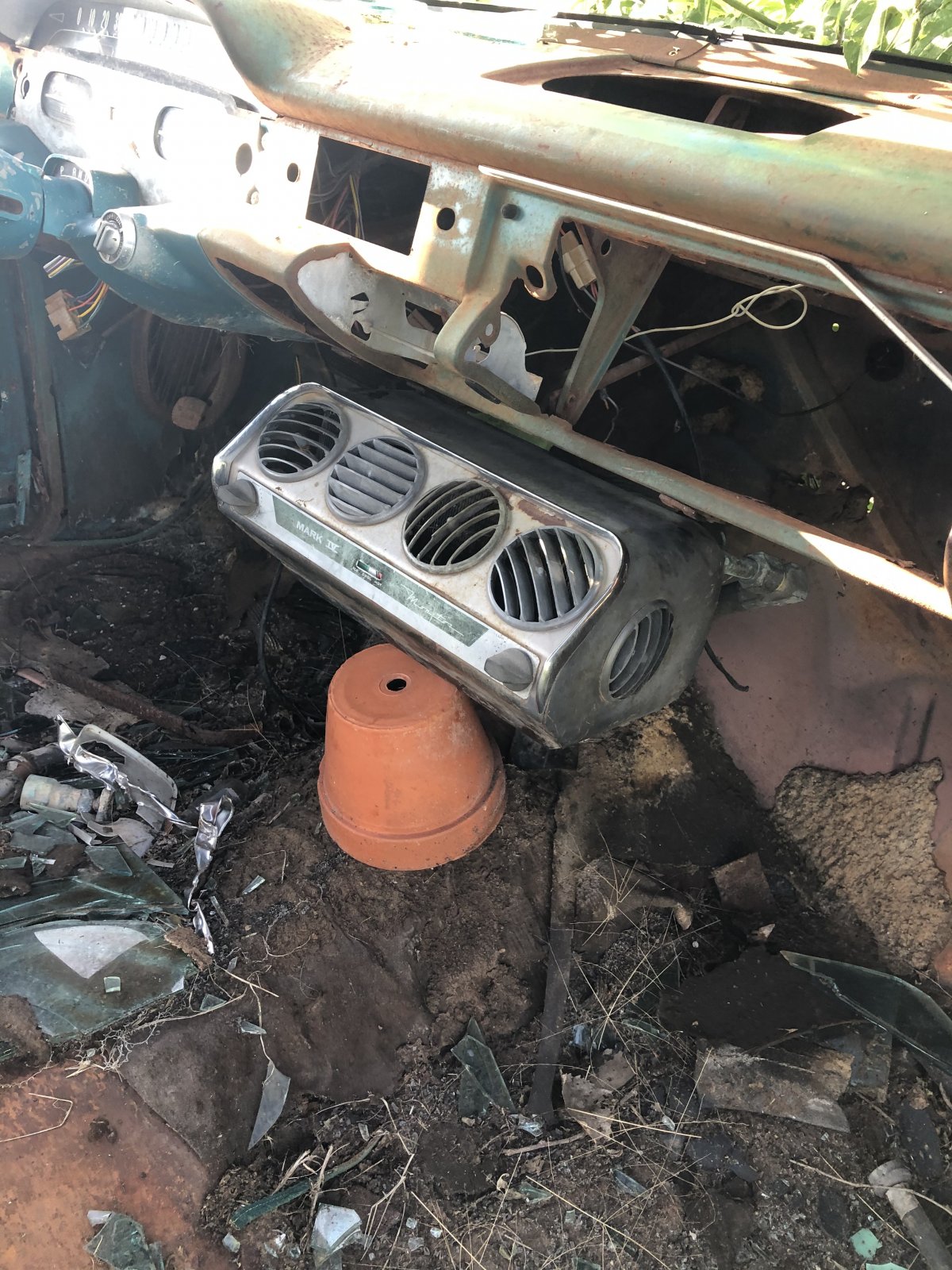

    Scored another unit at the Paso Robles swap this morning for 35 bucks.same as the one in my 64 elky 20200829_085930.jpg

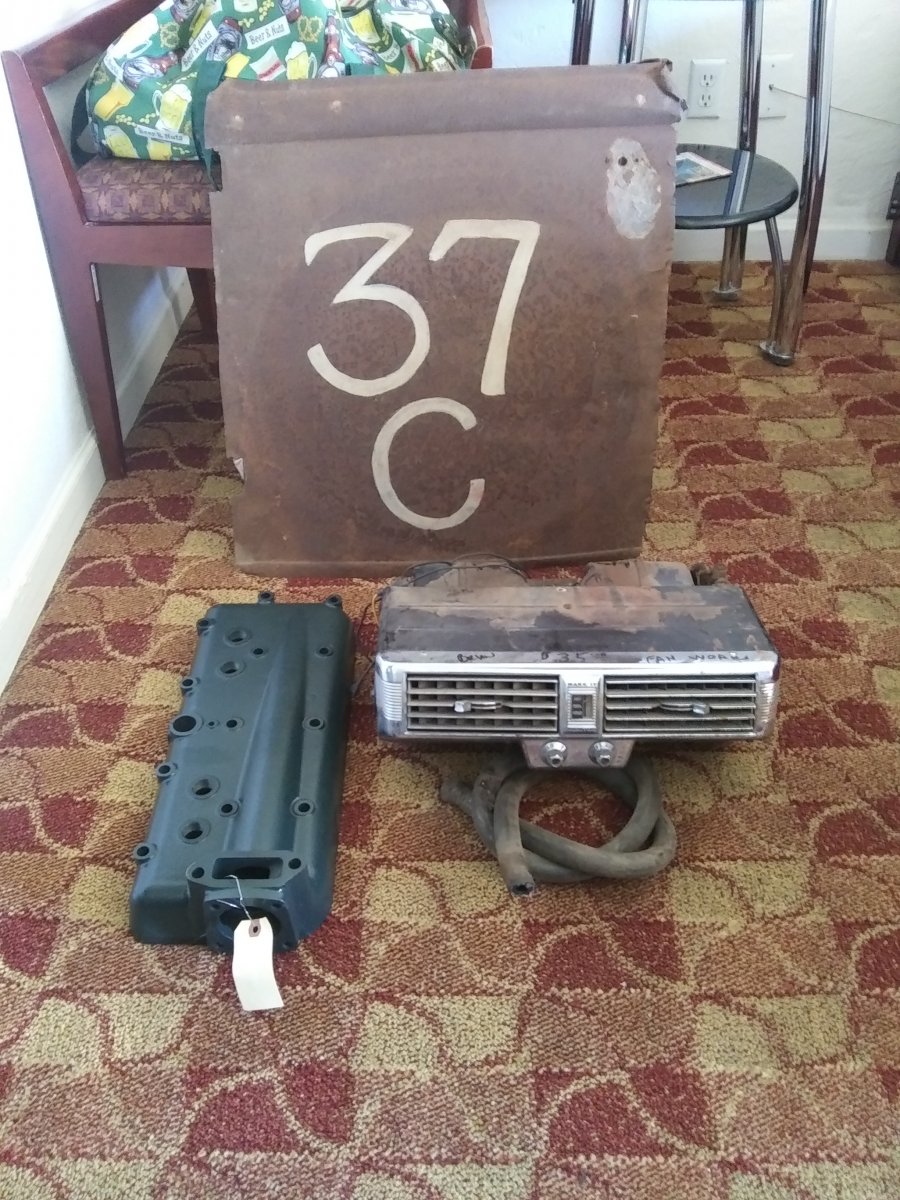

    Friend of mine gave me this artic kar. He said it was in a 63’ Cadillac he****. Looks good when I put it in my 57 Pontiac. Tested the fan it’s smooth. IMG_4965.JPG
