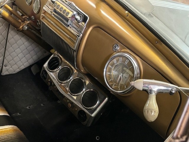

  10. williebill
    Joined: Mar 1, 2004
    Posts: 3,551
    williebill
    Saw this under dash A/C in a Mercury Park Lane at the national Edsel show in my town last weekend, thought it was better looking than a lot I've seen. Never seen this one before. Anyone know what it is? mercuryparklaneaitconditioner.jpg
    skooch likes this.
