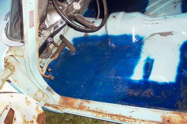

    Record-breaking heat and humidity today on the day I decided to weld my floor pans in. Oh well, gotta do it some time.
    Before pics show what the last guy did, he shoved a sheet of aluminum between the floor pans and the rails, shot it up with expanding foam, then sandwich'd another piece of aluminum on top, drilled the whole thing out and bolted it together with some big long bolts. Not only did it trap moisture and make it much worse than it probably was to begin with, but it was a real bear to get it all cleaned out.
    By the time I got it all cut out, there was very little left, and some damage to the floor mounts and substructure that had to be fixed before my new pans could go in. Picture is really shadowy but I couldn't wait for the sun to go down to take a good one, gotta keep moving.
    Here they are finished, at least, good enough for now. I beat the beads in using the method outlined on this tech piece, worked out great. No need to buy a bead roller to make floor pans.
    http://www.jalopyjournal.com/forum/showthread.php?t=435411
    The beads don't show up that well in the picture, but they are actually very crisp. I might clean these floors up once more really well and paint them again before carpet goes down just to make sure everything is clean and protected, but they're all in.
    Got a little heavy handed with the seam sealer but I don't want it to have leaks. Should have some more updates on the build on Friday night hopefully.
