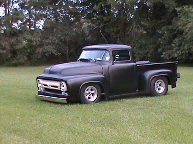

  7. Here is my personal Truck. It may not be as low as you want to go but I'm a little different than most. (I think that's OK) My running board is 6" off the ground at front corner and 7" at the rear 29.5" tall tire. Axle under the stock spring and stock shackle. I just moved the hangers up on the frame. Rear mount required notching the frame. I'm running a 57-62 F-100 9" rear axle 3" tube and it had 1 7/8" between frame and housing, I notched the frame 2 1/2". Just basic Fab 101, no big deal.
    I think you made a good choice in what you did. Good luck with your project.

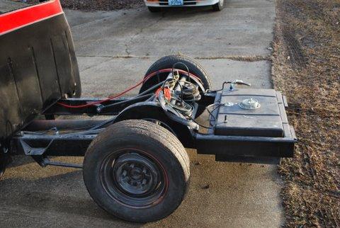

    i did a bolt in notch on mine first and it just didnt work out i wanted mine on the ground. so i replaced it with some huge c notches
