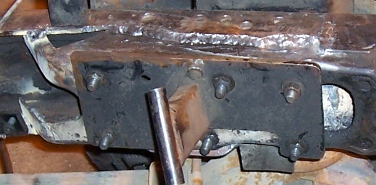

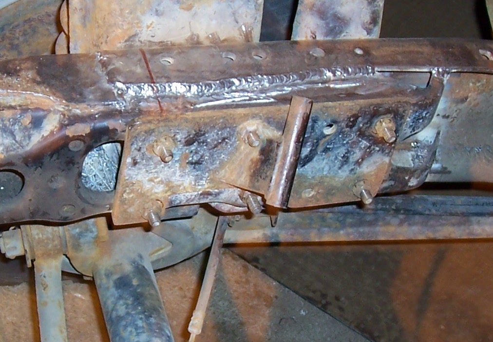

    Here are a couple pics from when I subframed my 76 f250 supercab 2 wheel drive with 77 f150 4x4 suspension
    on this application the spring is mounted to the virgin f250 rail and the subframe only supports the front sheetmetal and steering box and gives me my 4x4 front crossmember replacing the 2x one that would have interfered with the axle. the geometry here removes my welds from significant forces and the frame sections are boxed in an interlaced fashion as well.
    If your 110 welders a good one and your house power is good and you keep the extension cordage to a minimum and use a heavy guage one you should have no problem making a good weld with skills.
    fishplate the weld to distribute forces that might try to tear at the weld.

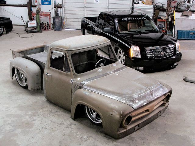

    Photochopped an old sketch of my truck. I think this is what you're looking for:

    Yes the sketch is it. I looked is to a s10 swap but i realy would like to keep my f100 frame i bought this truck for 400.00 and it already had a sbc swap kit, power breaks, and discbreak kit. The only bad thing is the motor was bad and it needs floor and cab corners pacht but came with new cab corners.
