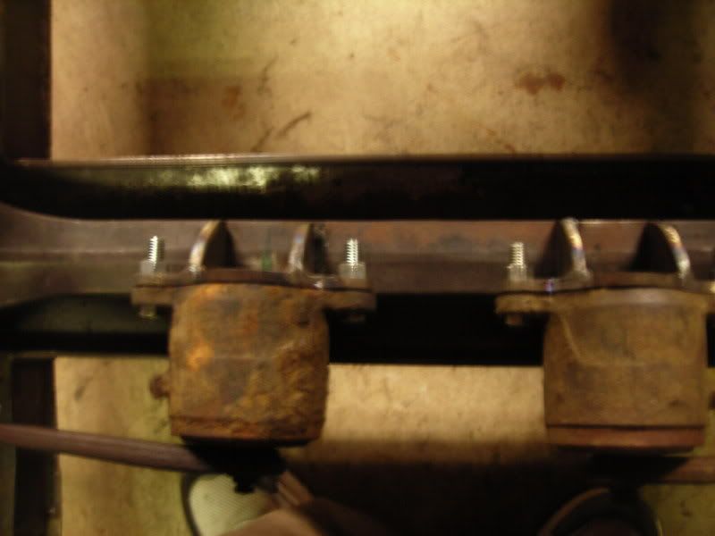

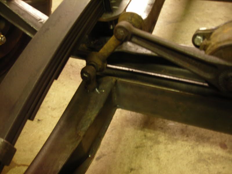

    its been too long! here are some updates. things are coming along. i got my front axle set up etched in stone i decided to mount the late model ford shocks on the axle and took a different approach to securing the axle as well. i still would like to put some lower link bars in to address the issues some were concerned about under hard braking. i also finished the rear shock mounts, and worked on the watts link. its not finished but taking shape. just have to get a center pivot section and make it double shear to finalize it. the next step, and when it stays warmer out side, will be putting a floor in the car.

    I am really enjoying your thread! I am curious if the underslung setup needs any type of panhard bar, or one of those anti-shimmy steering shock thingies like I had on my leaf spring 64 econoline. Also does any of the design theory from the underslung carry over to quarter eliptical set ups? I believe I see both suspension setups often when the wife and I watch the old british mystery shows on two and four seat roadsters (so you can see the actors). They seem to handle pretty well cornering and driving on gravel roads in the series.

    but i just ain't feeling the watts link. i like the whole rear setup, except that, and it'll be so visible once car is done.
    it might be alittle late in the build, but have you considered a track bar instead?

    Nice work! Just stumbled across this thread and read it end to end (well, I don't get online much, rather be out in the shop!) Sorry you had to put up with some of those comments, too bad there are so many idiots around with access to computers! My own experience is mostly 50 years of old choppers and 50's era Chevy trucks and sedans, so not a lot of time spent on the street rod stuff. But a career as a mechanical engineer (farm equipment mostly, licensed PE) lets me say I like your work, you are taking your time, thinking it out, and the work is solid. I've always looked for the cleanest stuff to start with, and modified from there, like you are doing. Technically there is no problem with the underslung setup, and I do like the looks a lot! Got no time for the purists who think it's a sin to build what we want starting with something clean instead of a rusted out piece of junk, but I've done both.
    There was one comment I saw, that you addressed, is regarding the spacer setup between the front axle and the springs, and the problems that will occur with hard braking. Dearching the springs is probably the best way to go, but maybe I can add something on that. I saw a setup once that might apply to your front end. The axle and springs were mounted in "normal" style under the frame, but the frame was notched and reinforced, and the axle was mounted a ways above the leaf springs with a stout link, built like a shackle, on each side, that was hinged with a bolt and a bushing located at the spring end, and welded solid to the axle. The axle also had stout links bolted solidly on each side going back to the frame, which kept the axle solidly located with respect to the frame, but with the pivoted link to the springs, allowed the whole ***embly to move up and down freely without binding. The torque applied by hard braking to the whole ***embly was safely and easily handled. I drove the rig, it handled well and cornered flat without any apparent problems. This was long ago, I looked to see if I still had any photos, couldn't find any, but I can try to draw it up if you want. But I'll bet you follow what I was trying to explain.

    PS, I will add that I've built quite a few Watts links, and seen some bad ones that weren't set up right. The main problem I've seen with the ones that were set up right was wear. There's five pivot points on those setups that wear, and if you're a driver like me, you'll put a lot of miles on, and they tend to wear pretty fast in my experience, eventually giving you a lot of loose movement back there. I've pretty much gone back to all panhard bars for the street, only two wear points and they seem to last longer before needing a rebuild.
