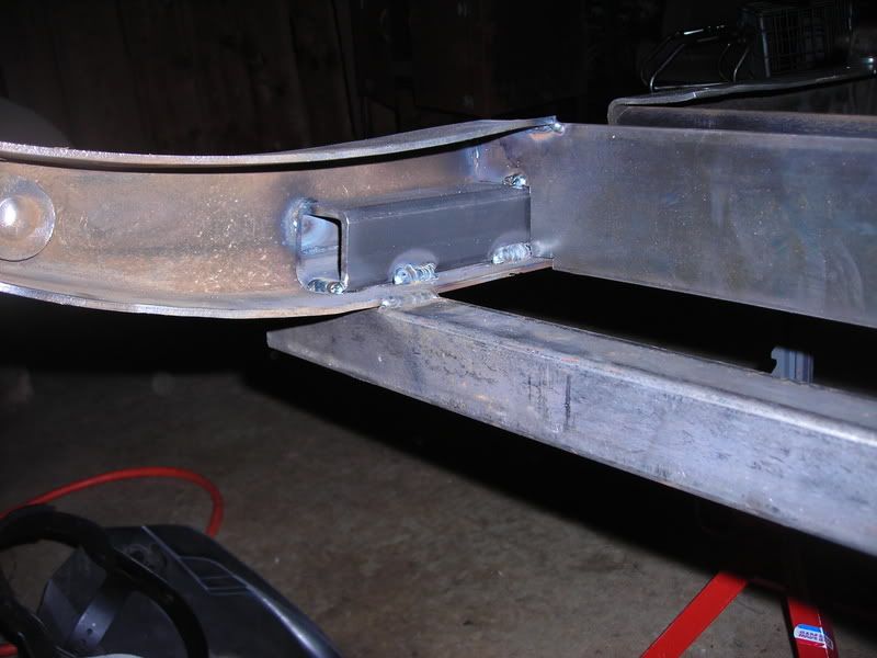

    front notch and some reinforcment

    before and after gusset and filler to hid the ugly box tubing.

    pics of the pieces welded in place

    i really think box tubing on an old rod looks outta place so i opted to make an ibeam to match the front axle and possibly make it look like GM did it.

    welds also look outta place to me on an old car so i made sure i was able to weld the corners and be able to have enough metal to grind down. all corners are radius to a 45 degree angle. i decided the ibeam just didnt look smooth from the top so along process but i did about 3 p***es with the welder and ground it all down to a 45.
