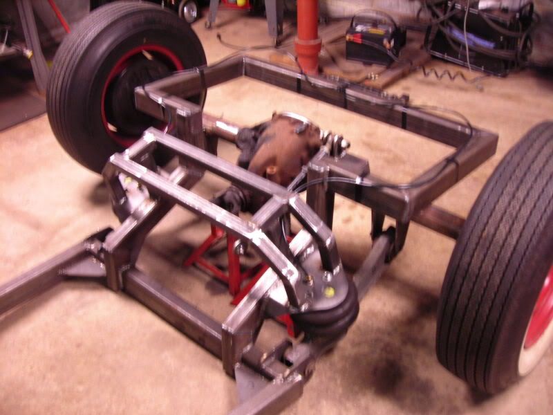

    hey you found me! the rope was a quick attempt to find the IC. after looking at that tubing i put on the axle for a few weeks now i really cant stand it. im just gona put the bars wide on the axle and narrow on the frame with some bunny ears. i have to take out that lower frame cross bar anyway since it was just there to keep stuff true and aligned. it will hit the shaft. if i put a crossmember there i think ill solve 3 problems. drive shaft loop. some where to attach the upper link bars. and it will keep the frame strong.

    Mounting the bars wider on the axle and narrow on the frame is a better approach. Your roll center will always be in the same location and will
    be more predictable in turns.

    Clean welds. What type of MIG welder are you using? I'm digging the project more and more.

    hey thanks im getting amped to drive this thing already. the welder i am using is a hobart handler 135. 110 volt. i have had it for about 10 years now. its pretty good for what i am doing. it will put a hole in 1/4.

    tonights update the frame is lift with out a floor jack for the first time!
    i about 95 percent finishing just have to hang the linkage. also does any one have any specs for a watts link? i need the i2i on the rocker?<center>

    It looks like its coming along.That pinion angle looks like its pointing downward.

    i dig your project. excellent info! what i was curious about though was, how can someone lay down such a beautiful straight weld bead, jiggle a camera and get such blurry pics.:D:D:D

    Question - On your rear suspension it appears you're using a 3-Link, yes?
    If so then you might want to move the link to the right side axle tube (if not being centered over the housing in its final placement) instead of on the left side tube as it appears in the picture.
    It'll work better there with the natural (vehicle) dynamics of/during acceleration.

    Nice job on the rear Scotty, lots of good quality work. Only thing I'd maybe do a little different is put bracesfrom the main rail to the middle of the kick. It just looks like a weak spot having the whole rear of the frame tied to the one tube welded to the end of the frame.

    I never caught the link on the left. It would be better. Your geometry looks good otherwise.
    I'm wondering how this one worked.
    With the upper and lower arms pointed down, there is squat built into it. Lots of wheelhopping potential there. Be way better having the lower arm brackets on the housing longer.

    Unless my eyes deceive me it looks like the lower arms in that pic are more downhill than the uppers - No anti squat there.
    Unless the center of gravity is really really really low that particular car will likely have lots of body roll (requiring stiff rear springs) as the panhard bar is pretty low also; the rear roll center is low and offset to the right as it is laid out there so one rear spring will have to be stiffer than the other to compensate.
