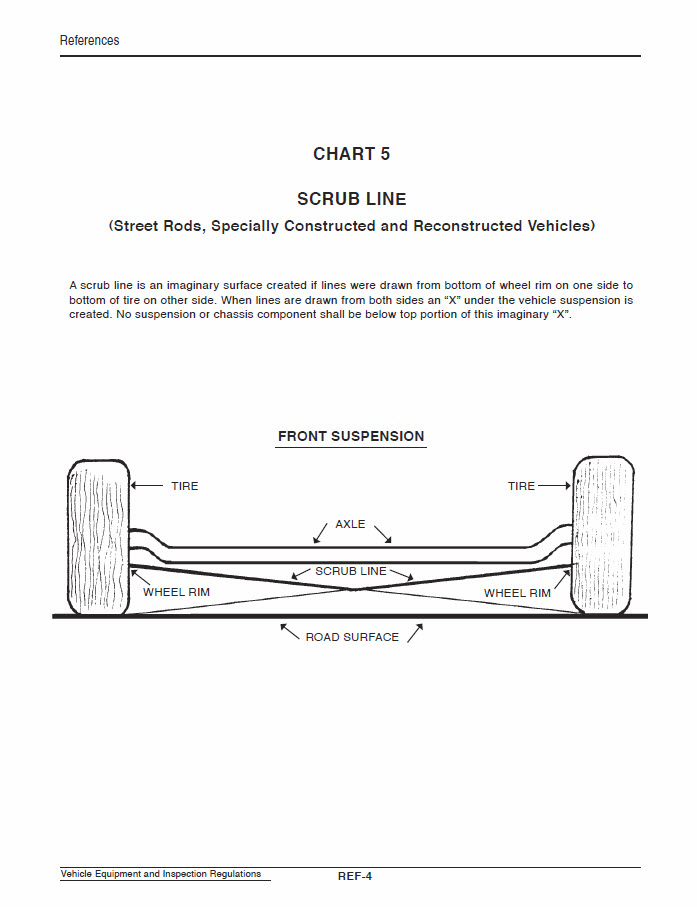

    As for understanding scrub line. Imagine the car going down the road and getting a flat tire, when that tire is flat and on the rim anything on the ground is at or below scrub. So yes, springs under the axle could violate that line.

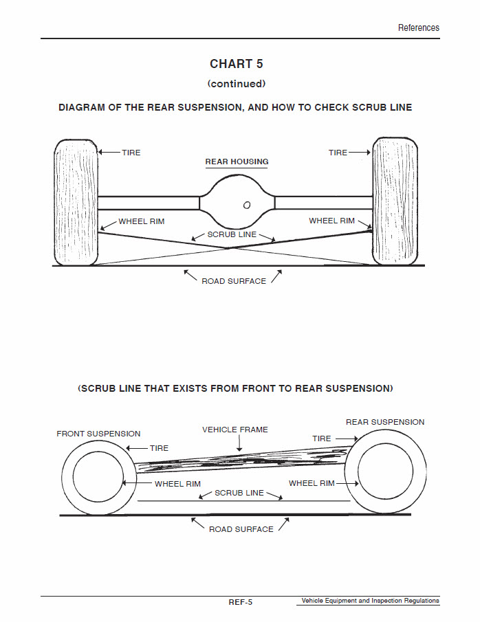

  7. Ok you need to have 8 1/8 from the axle center minimum 8 3/8 would give you a little wiggle room. I think that you would be alrght with the 3" blocks but those are some numbers for you to work with.
    By the way only amatures neglect to trim the bolts once everything is pulled up tight. If you don't use long nuts you can actually end up with about 3/4" below the axle plate, maybe as little as 5/8".
    Ok I said that wrong, 8 1/8 would be your maximum length from axle center to longest hanging down part. I hate it when that happens.
    You are less than 7" to the plate so with nuts and washers I think you would still have an inch of clearance.

    Here are some pictures for reference. I like that website link in the previous post.
