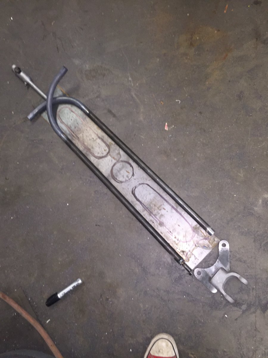

    Started making my front and rear batwings for home made hair pins- drew these up on CAD and had the plasma table up the road slice them out of 3/8" flat stock.

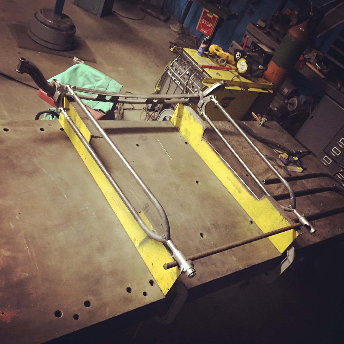

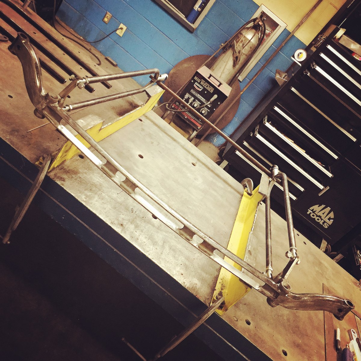

    Have everything tacked together- need to make the inserts for the bones. I bent and tapped the bones myself. Using two ends of f-1 drag links- the ends are different so I used two draglinks the hairpins I'm making for the rear will use the other matching pair. Really dig the looks of it so far-

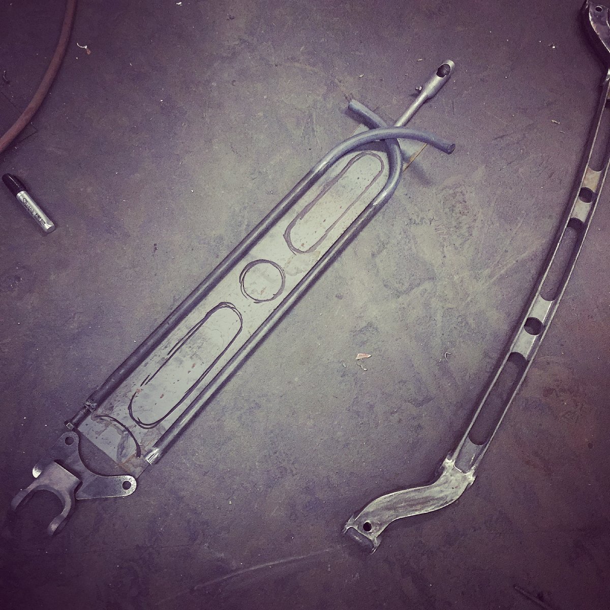

    Tuck i'm really hesitant to critique your work and creativity but... Have you considered minimizing the front axle inspired gussets to more closely resemble its spindly almost nothing left look? Like only using the middle and end shapes not the whole pieces that make up the capsule shaped long holes? Or just enlarging all three per hairpin?
    My best regards, Wyatt.
  13. Tuck
    Joined: May 14, 2001
    Posts: 5,873
    Tuck
    Tech Editor
    from MINNESOTA
    Wyatt- yeah I think the insert piece is going to have one hole the diameter of the opening of the hairpins and have that same radius on each side more like the axle- I think we're on the same page. I'll do some paper templates before I decide on the final.

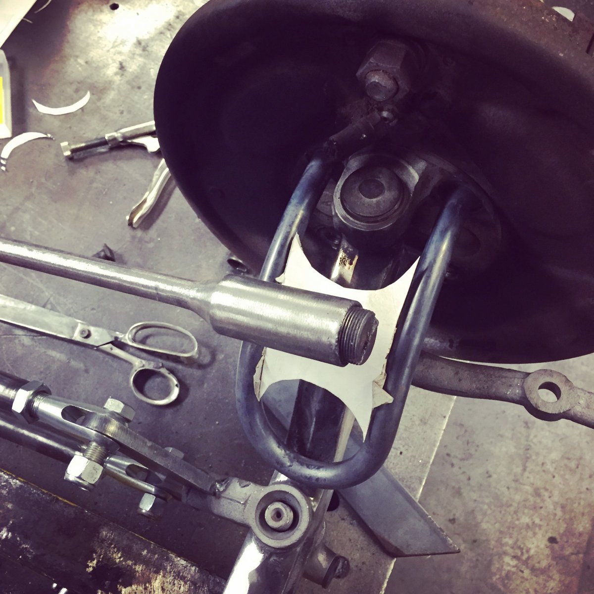

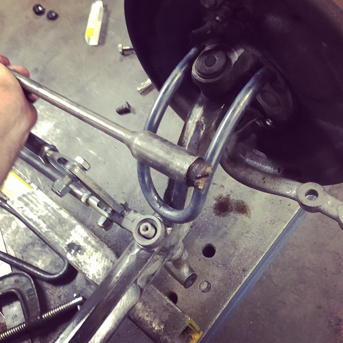

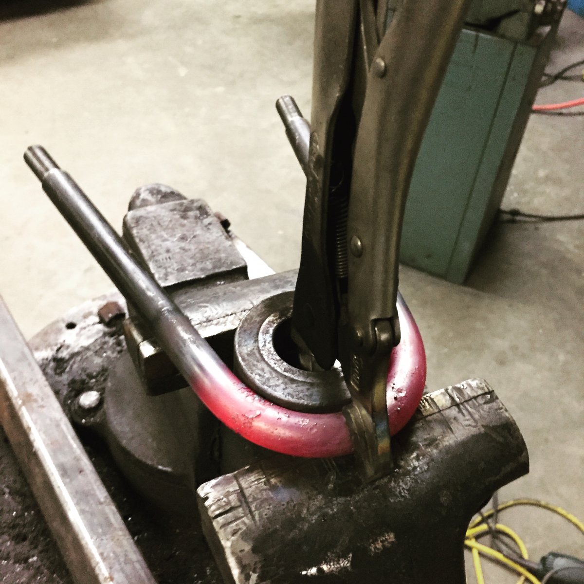

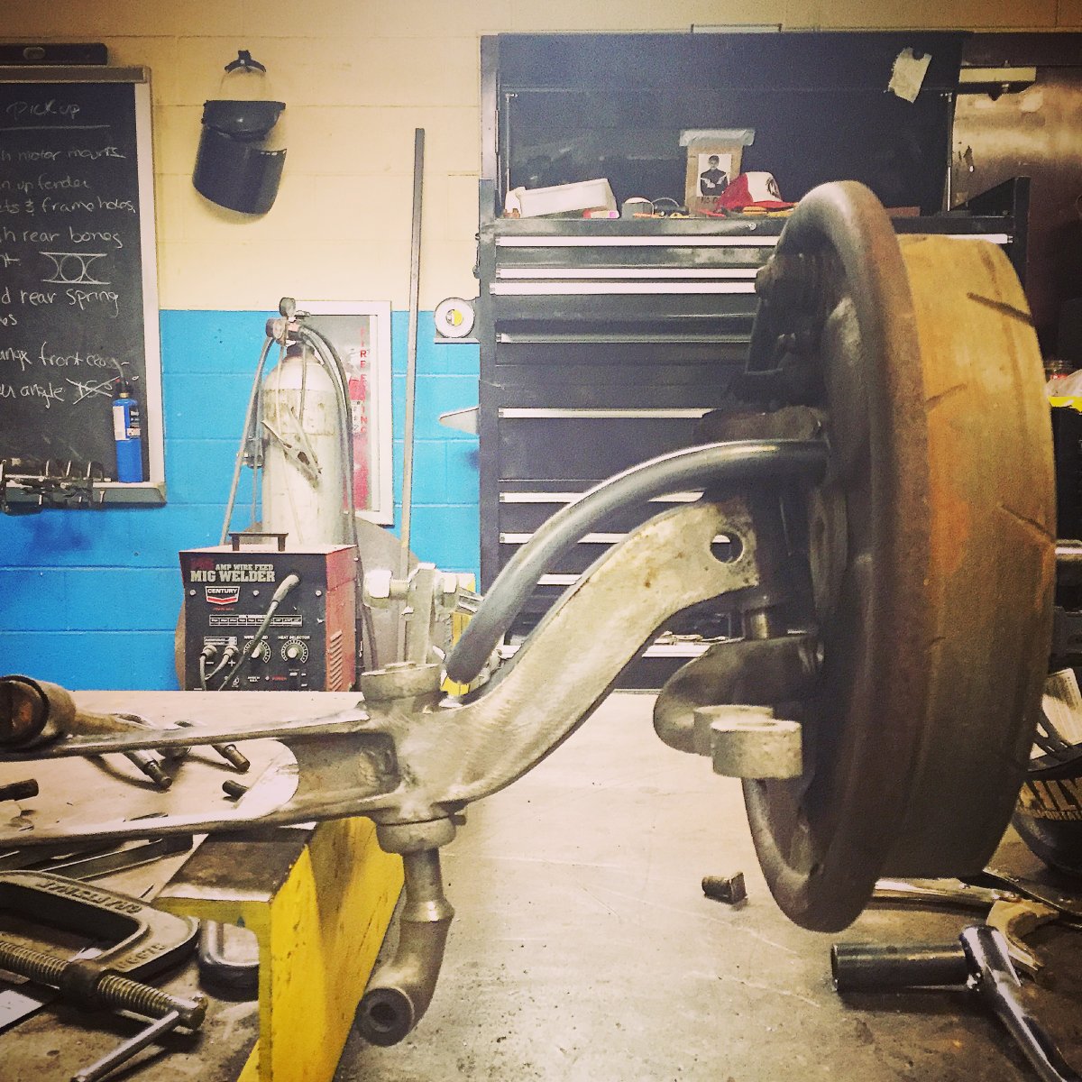

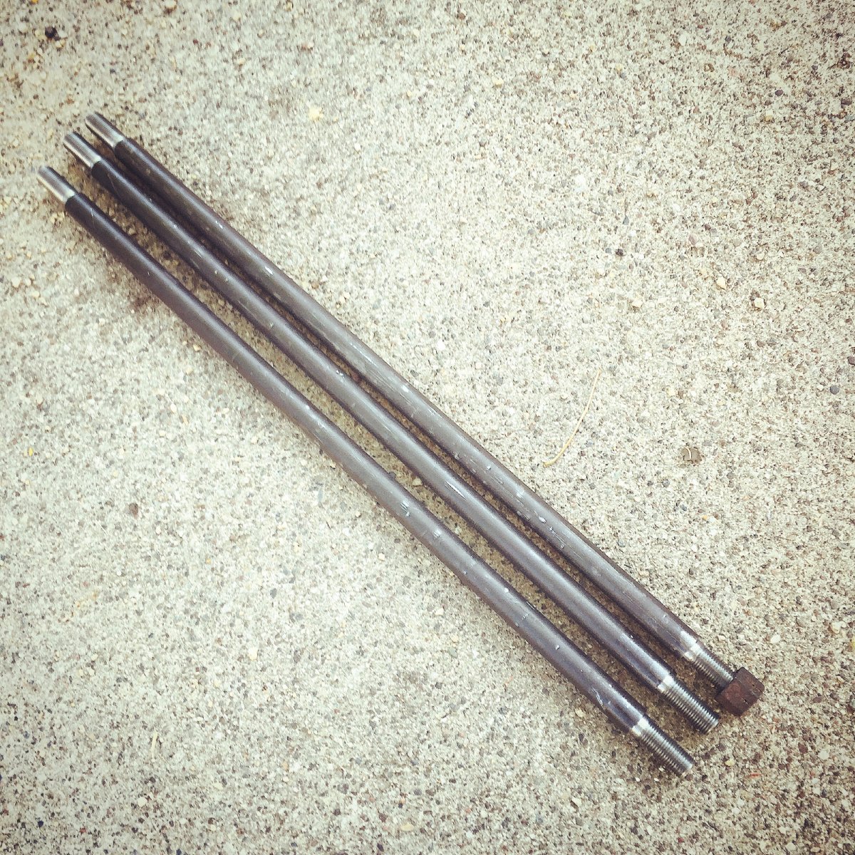

    Cut up some 1/2 rod and turned and threaded the ends. Marked the center and bent them around a radius- then I bent it to flow with the axle- it's got about a half inch clearance everywhere I know it doesn't look like it in the pic. I'll make an insert for it with a tapered hole for the tie rod end.

    Ignore the backward spindle and the upside down shackle I needed that stuff out of the way when I was bending-

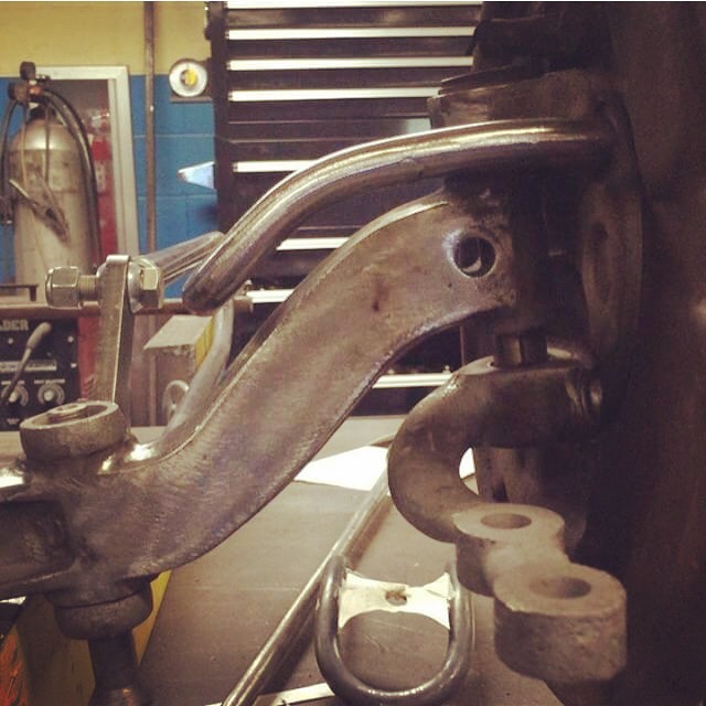

    Was thinking something like this with a ball mount and chromed- Instead of running a bolt in ball I'm just going to weld a ball end in the gusset insert. Plan on running a 32 drag link to a f-1 box.
