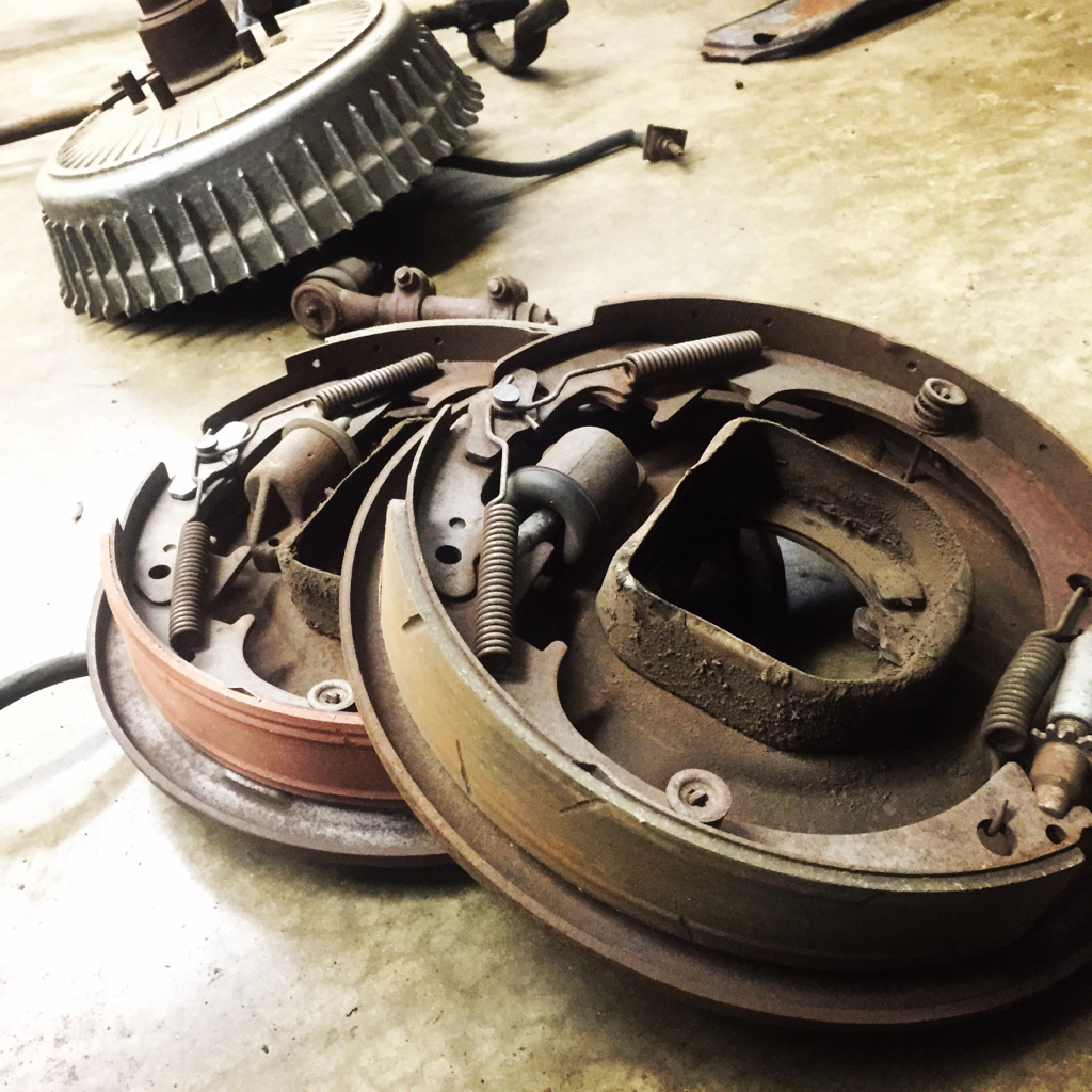

    The junk guy up the road hooked me up with self energizing backing plates for my Buick conversion- stoked on these! Still planning on running the Buick hubs. These came off an early 50's F-3.

    I was going to do Lincolns on the front of my '39, lately I have been REALLY thinking about F-3's it would sure save some $$.
    So if I want to use self energizing F-3 backing plates and hardware with '39 spindles and '40 hubs and drums, I need '54/'56?? Was '54 the first year for self energizing brakes on F-3s?

    ^^^hell yeah! I just got these today.

    I scored a full set of those plates as well. Fronts and rears. I need to find one more '46-'48 hub to have everything I need..

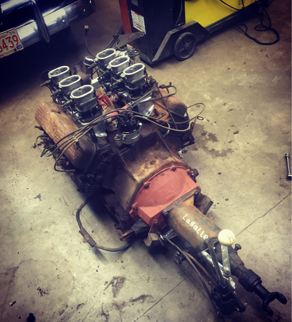

    Had @***us drop an a axle for the coupe!
    I have a plan for the frame- I'm going to build this car with the same stance as the **** Rash coupe- zing the frame just behind the firewall so it looks channeled 8" and a slight kick in the rear so the tires don't go above the fender line-

    I have more pics of this I'll post later! This car is so bad ***!
