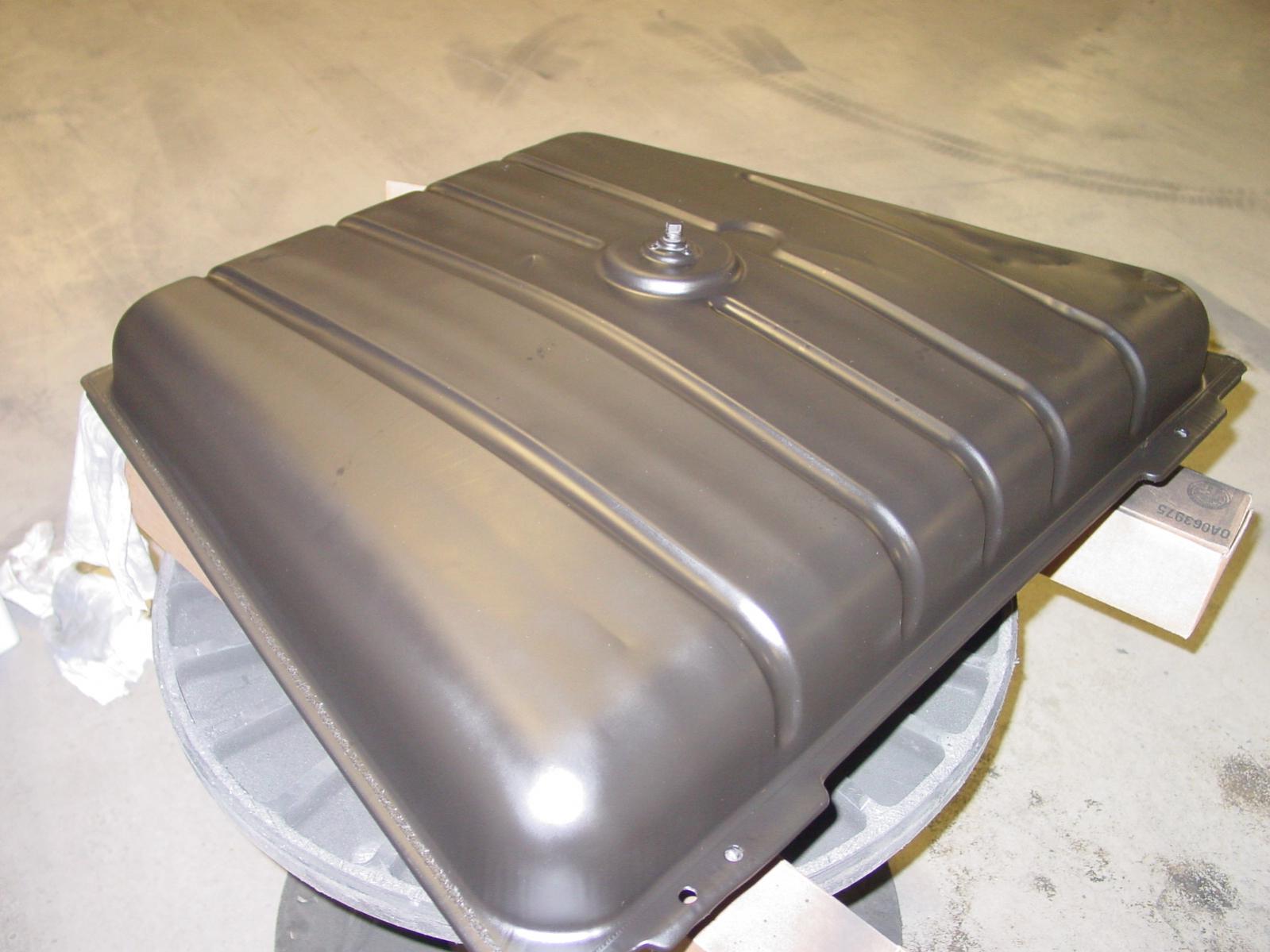

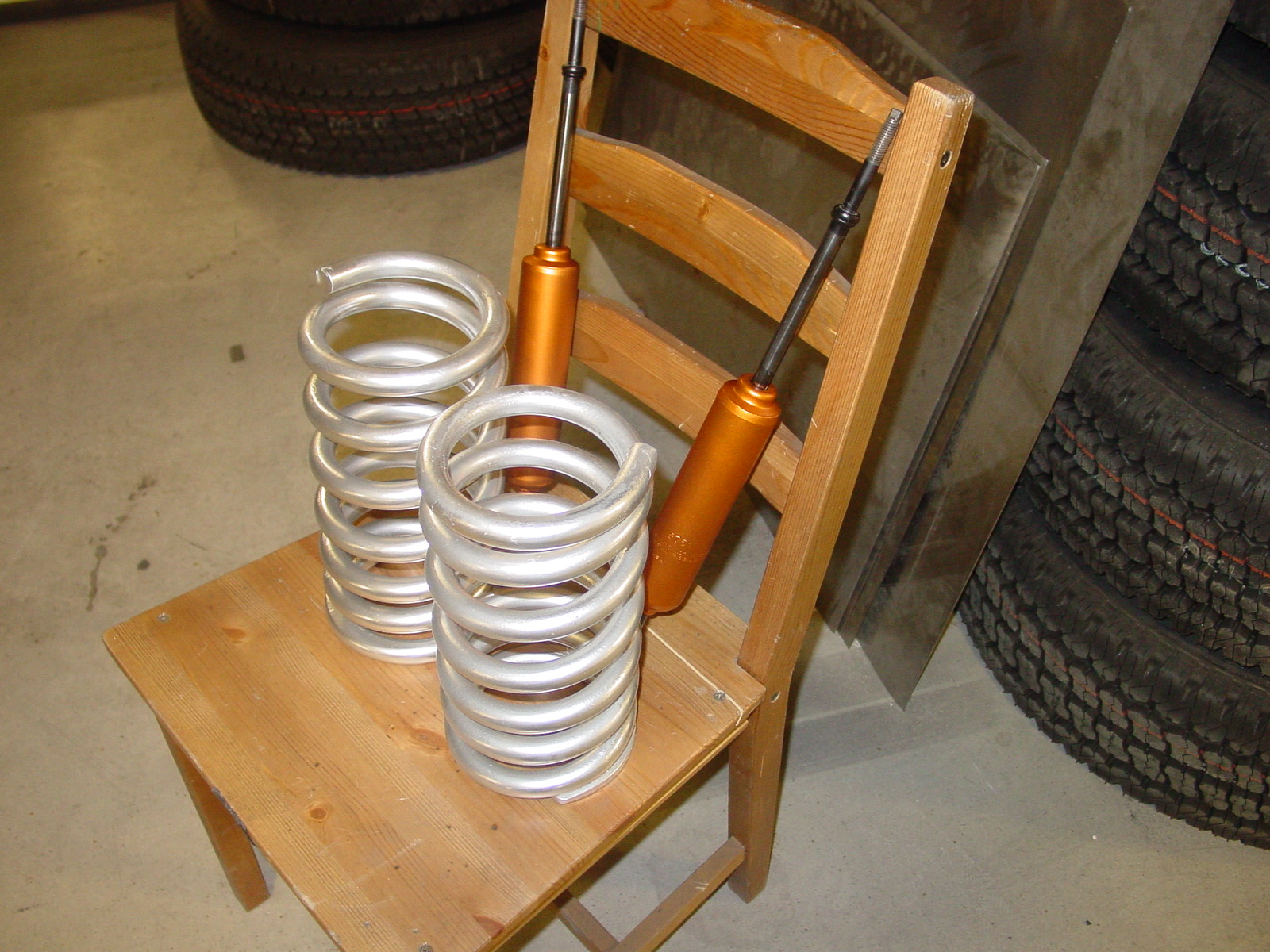

    Project Update: Exhaust fabrication and brake line, fuel line routing going on currently. Recently mounted the fuel tank, and had the radiator pressure checked, and fuel tank cleaned and lined. Determined seatbelt locations for front and rear retractable shoulder belts, painted the driveshaft and pinions, master cylinder bracket and master cylinder. I'm using the original fuel tank, with a few dents for character. I had to pull out the 1" lowering blocks up front because the Aerostar springs were loose and not seating when the front suspension was unsprung. With the blocks in, one of the front springs wedged itself in the front spring pocket area, which turned a 30 minute job into a much longer job because I had to get a spring compressor that went inside the coil. All that meant I had to repaint the front springs and shocks. Recently got my hands on a replacement RH fender because the old one had a substantial amount of sideswipe damage. My 12" Brockman Mellowtones arrived today.....

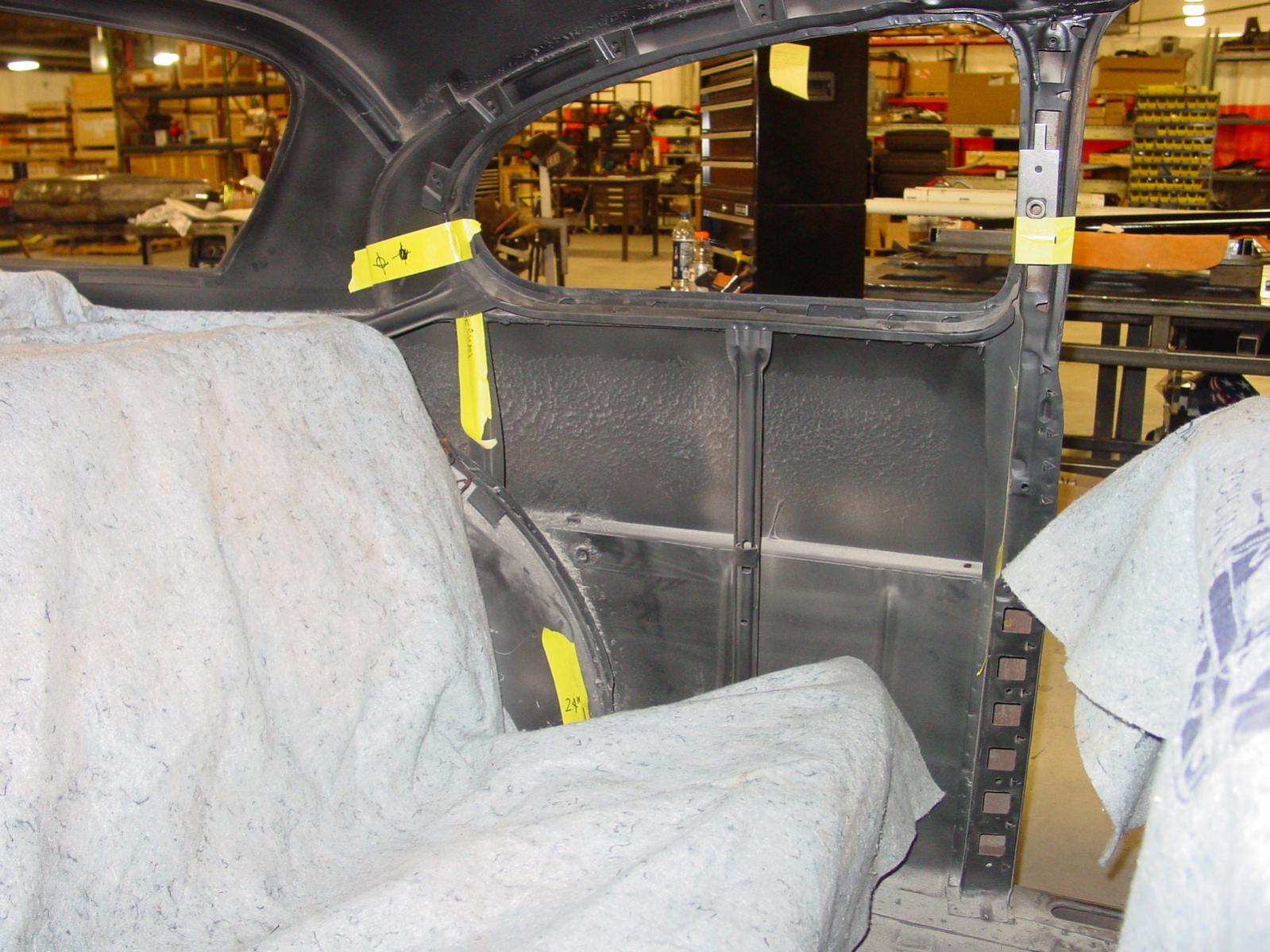

    Project Update: It's been about two months since my last update, and things are still moving along. The major part of what I've done since my last post is replacing floor sheetmetal, along with other body related projects. Last fall I took the body to a body shop, a real business, not just some guy in a garage, to have some minor rust fixed in the floor. It required cutting out the old, and welding in the new - something easy for someone who has an entire body shop and years and years of experience. I thought it would help move the project along while I focused on a lot of chassis related projects. Well this asshole did a terrible job. It had me pissed off for a few months. Finally in January, I decided to cut it all out and do it myself. I've never done this before, but you know what, I'm pretty happy with the job I did. I learned a hell of a lot. Sure, most of you could have done a better job, but I'm pretty satisfied with the 30+ hours I spent repairing the floor. I also welded in seatbelt brackets, weld studs in various locations to mounting the battery in the trunk, for some sort of audio equipment, etc. I had to get all of this out of the way because last weekend, I was finally prepared to paint underneath the car. A few coats of black Corlar 2.1 PRP with seam sealer in between, followed by a few coats of Silver Metallic Imron 3.5 HG (high gloss), and it looks pretty friggin' awesome. It was a long weekend of working on it more than 30 hours from Friday - Saturday - Sunday, but it was worth it. On Friday night, around 1:00am I wanted to finish up a few more things before I was done for the night. I wasn't paying attention to the clock. When I was done I assumed it might be 3:30am. I checked the time, it was 6:00am. I had a laugh, and drove home in the morning light. Now I can get serious about putting the body back on the frame. I'm pretty happy about it.

    A few more photos of working on the floor, seatbelt bracket layout, etc...

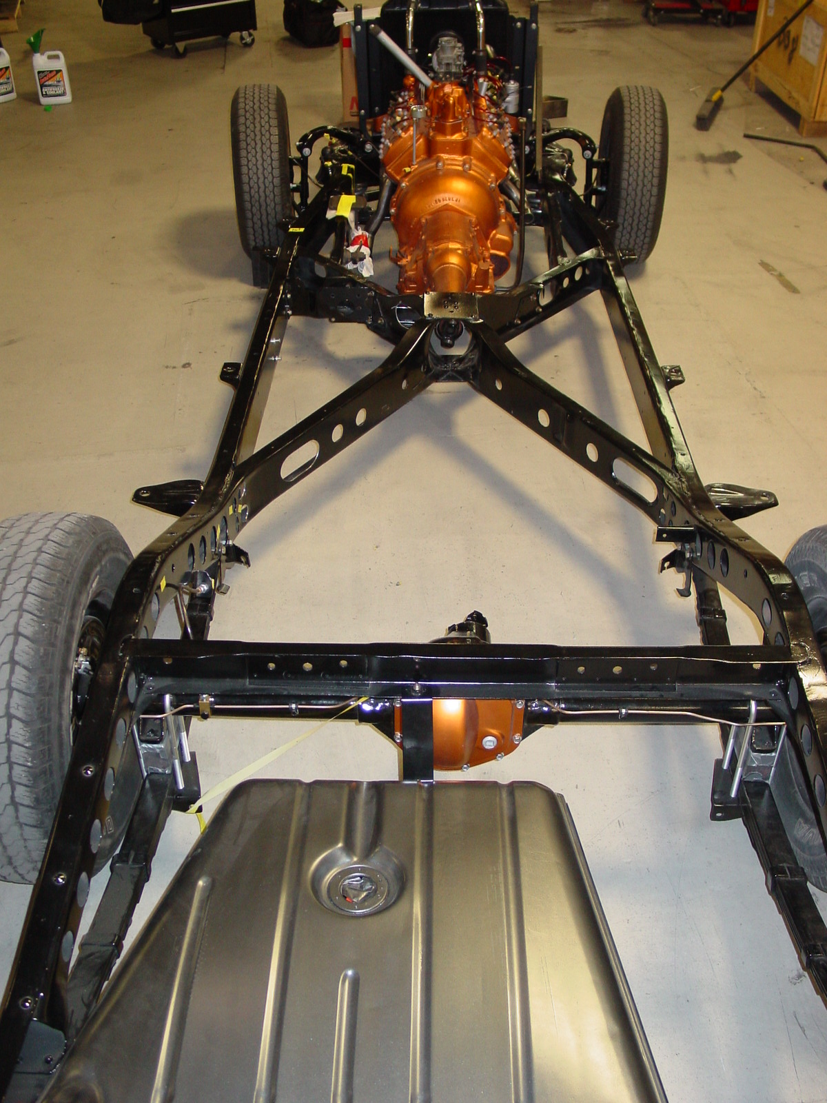

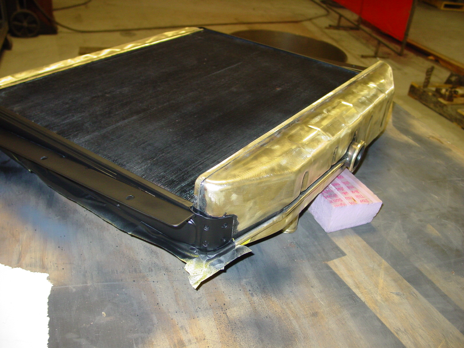

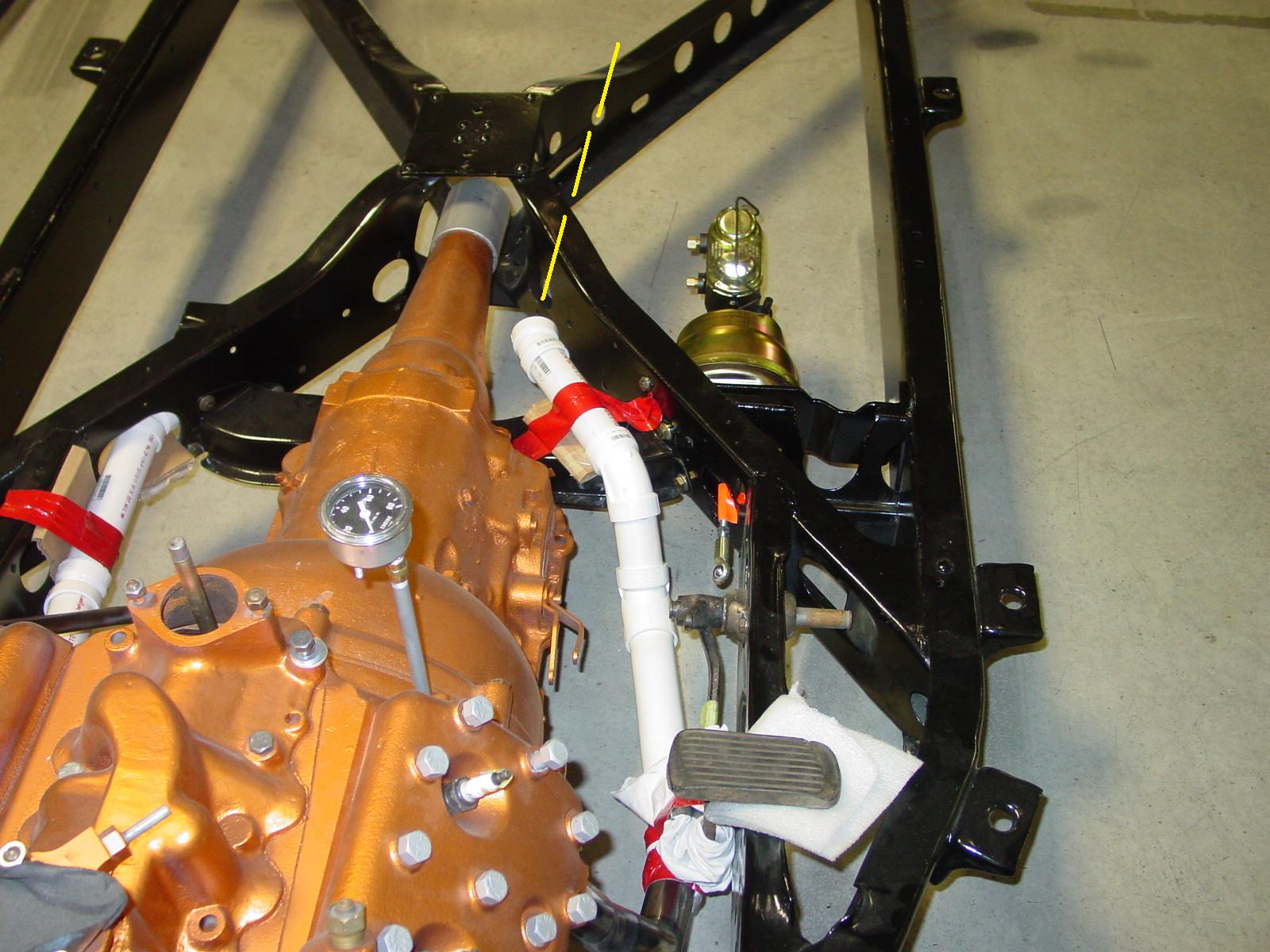

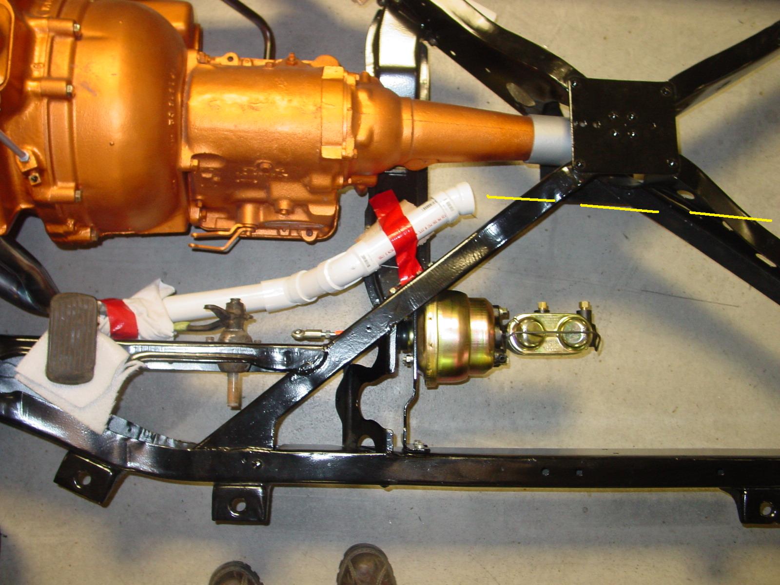

    Progress pictures.... Brake lines are bent, but not installed in this picture. Shortly after I took this picture, to show radiator mounting and install, I was moving the chassis by pulling it with a forklift. The garage door started to close and I stopped the forklift quick, but the chassis kept rolling, and the forks went into the radiator. So now the radiator has damage on both sides because it was pushed against the fan. I was extremely happy with that. It might be able to be fixed, but I doubt it will be cheap. Radiator is now out of the car.

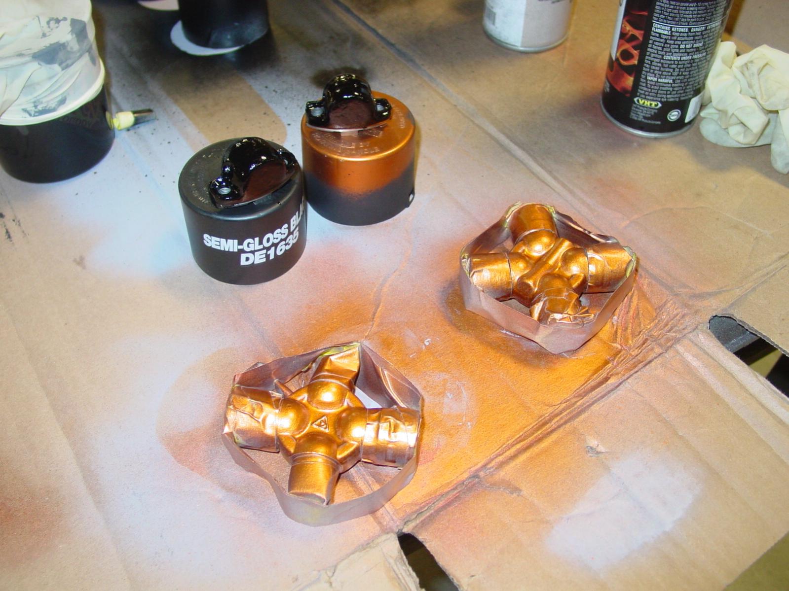

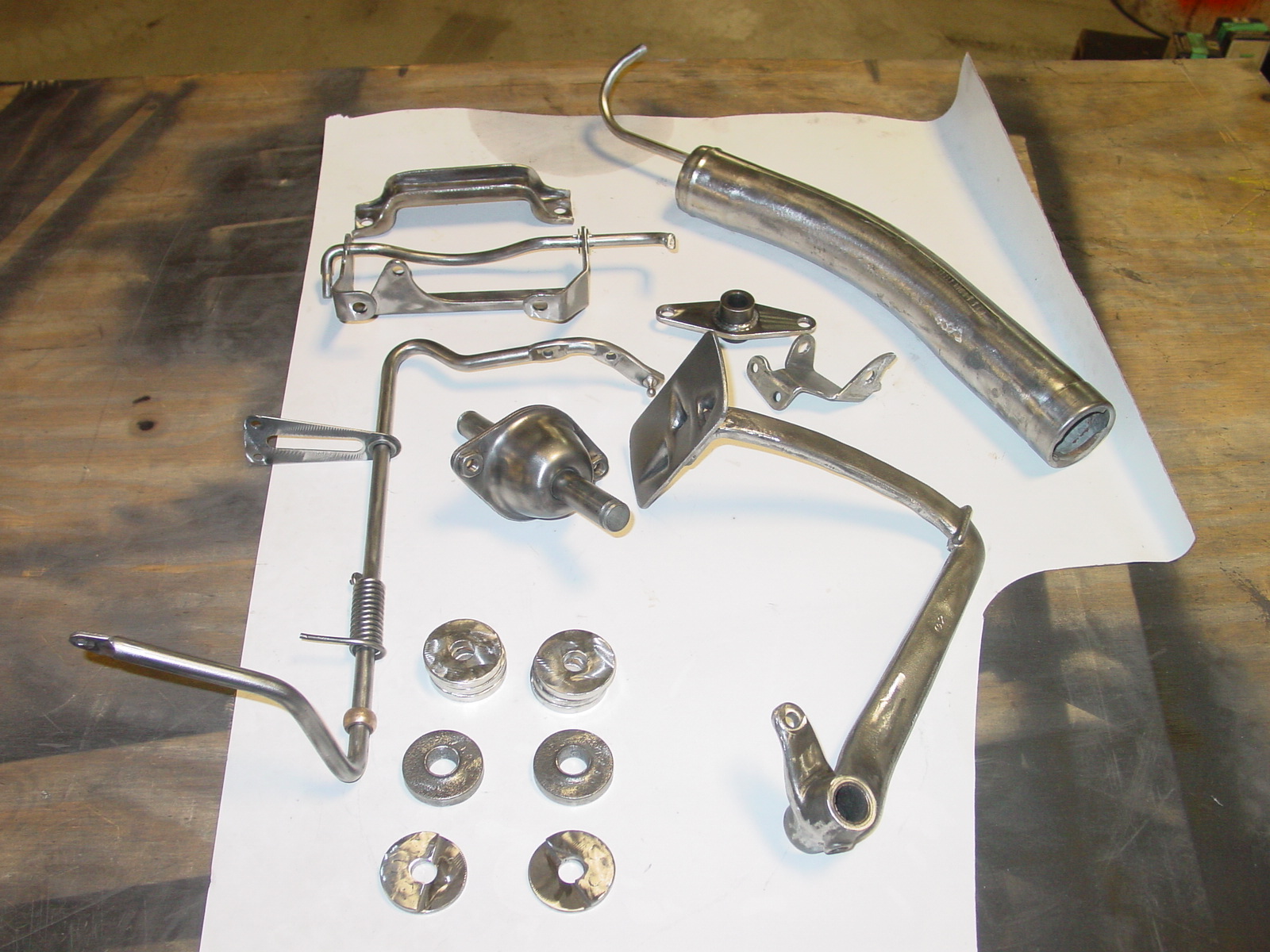

    I also cleaned up some other parts, both old and newly fabricated. Does anyone else find plenty of enjoyment in disassembling dirty, old rusty parts, cleaning them with a wire wheel down to bare steel so they look like new? I do. Throw in a few coats of paint and I call it a good day.

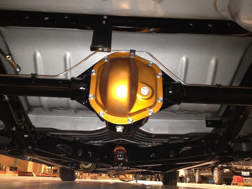

    Finally finished polishing up the brake lines, installed them, bench bled the master cylinder, built all the drum brakes, and got the body back on the frame.....

    A few photos underneath...
