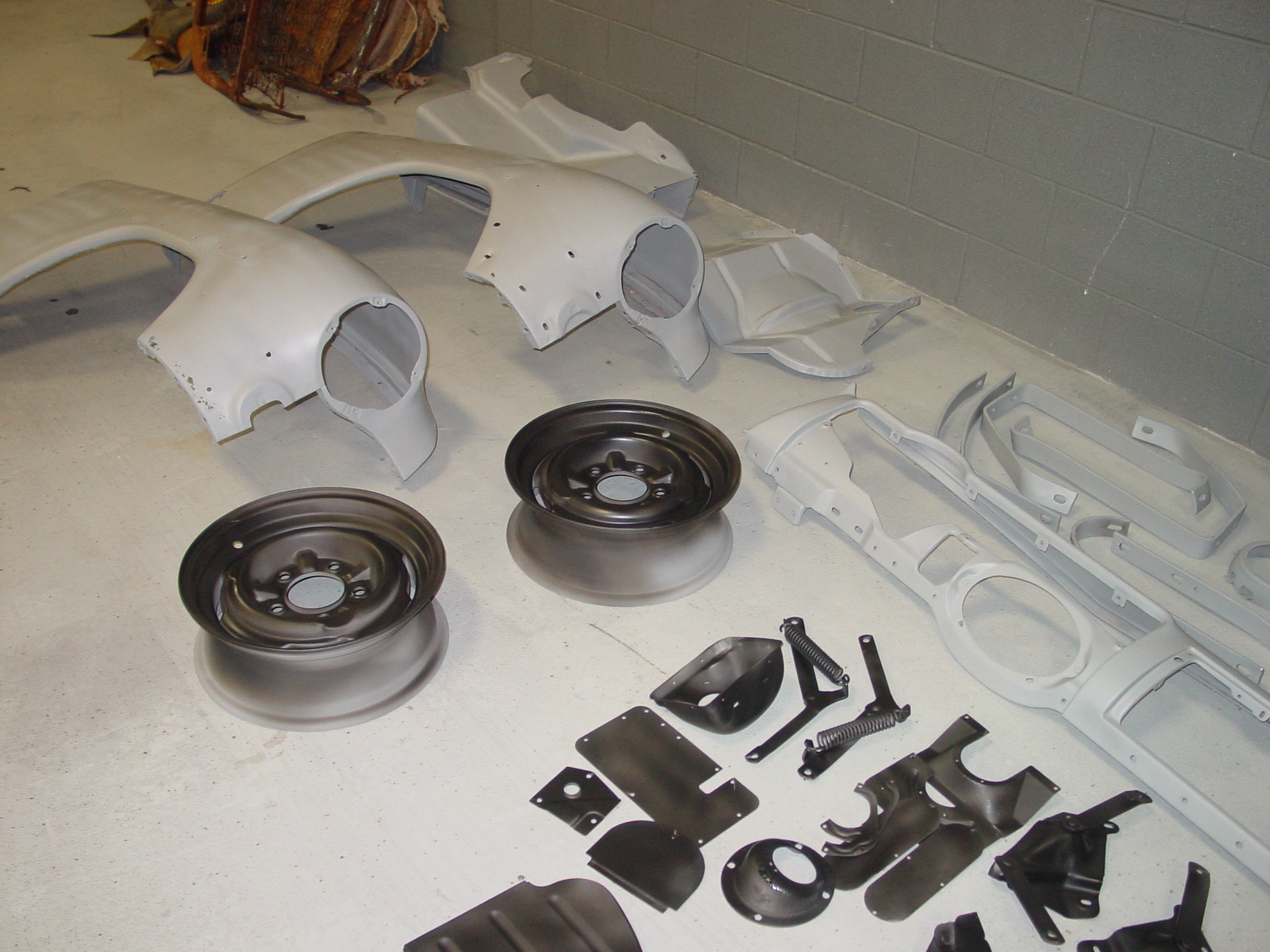

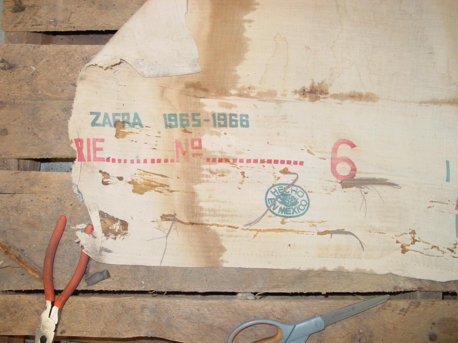

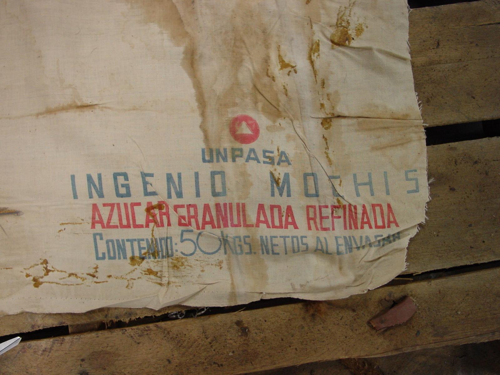

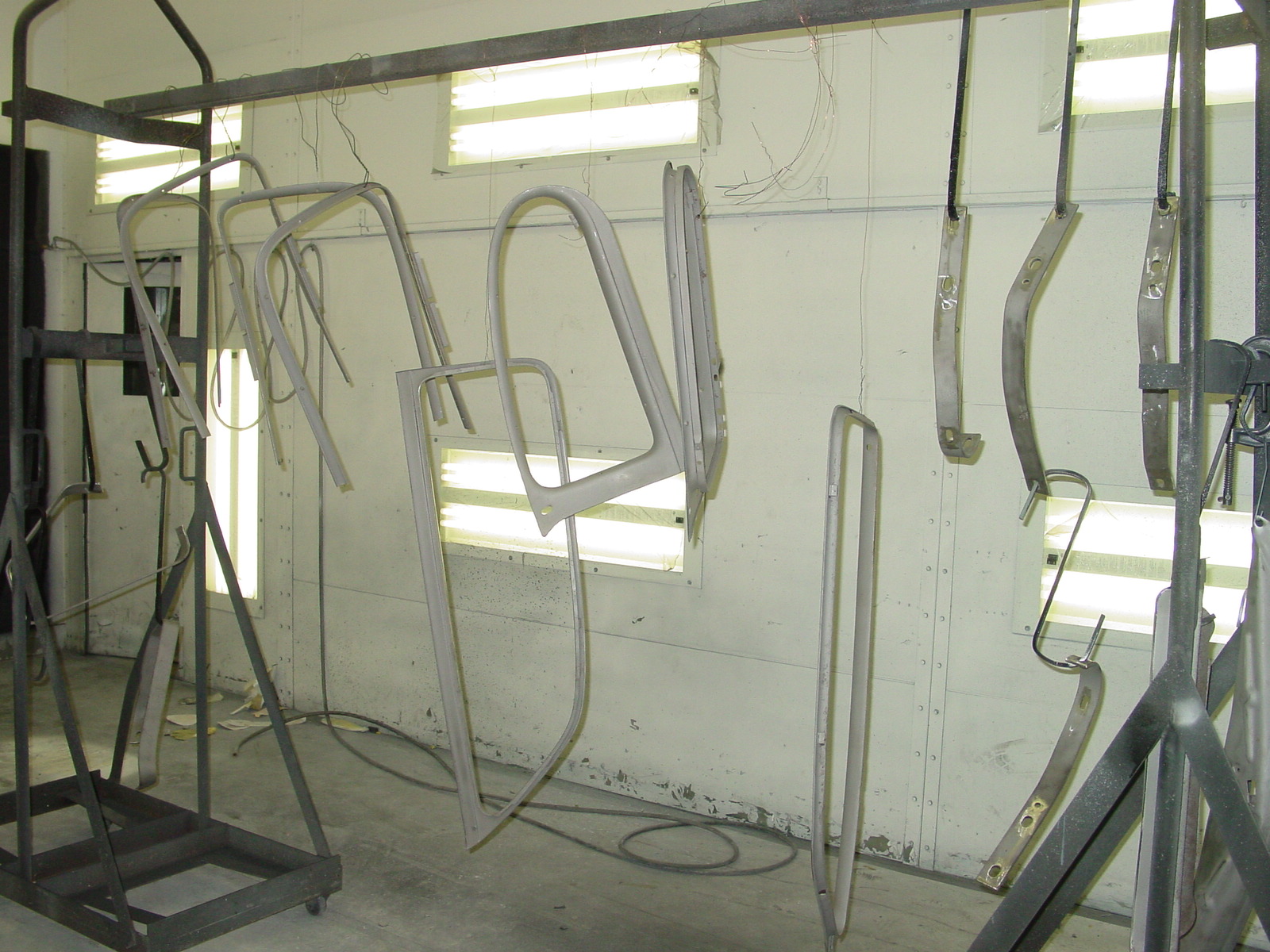

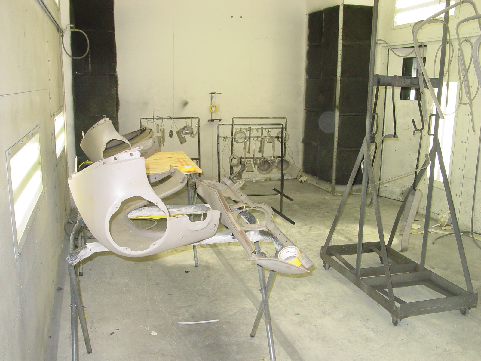

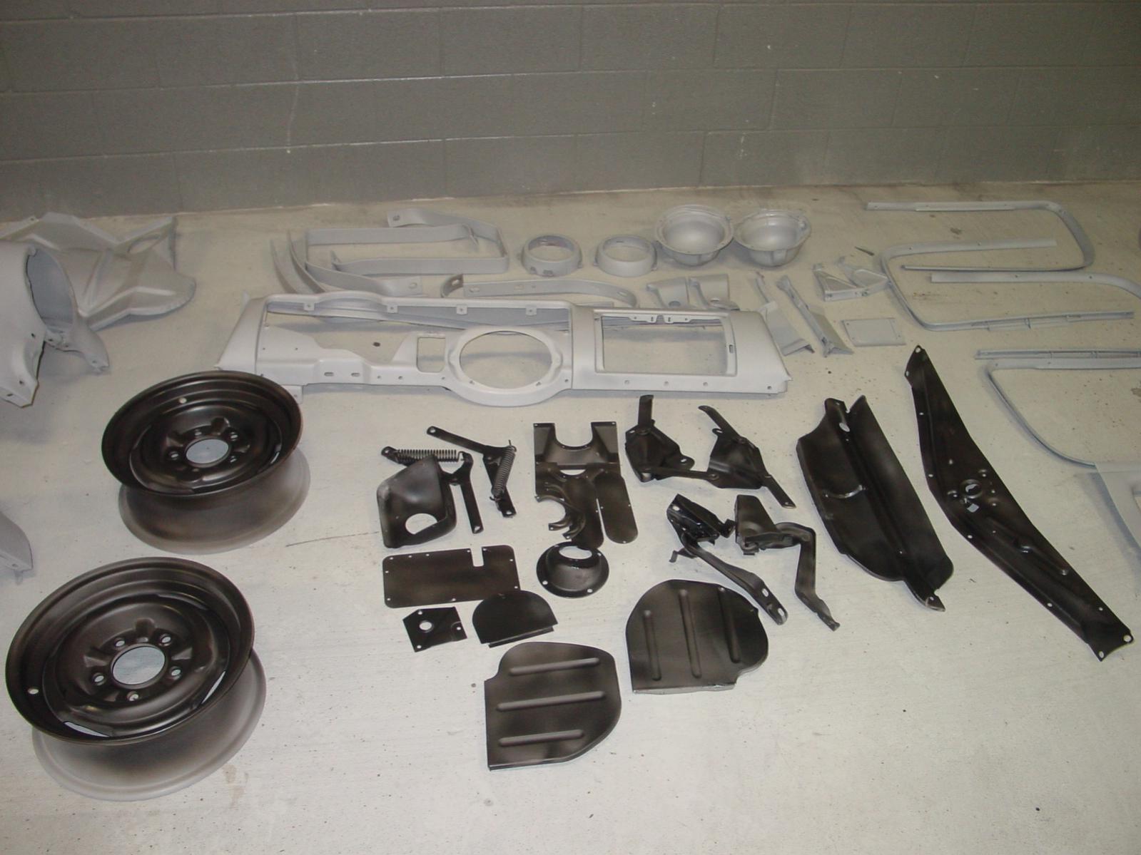

    Recently got a bunch of parts back from the media blaster.... about 50 pcs or so. Threw a coat of epoxy primer on them. Tore my seats apart, to find a pretty cool little artifact. They vinyl seat covers that I took off revealed the original fabric underneath. The material from a sack of sugar was used to cover holes in the original fabric. The sack was dated 1965-66 so it wasn't a traditional sack, unfortunately.
