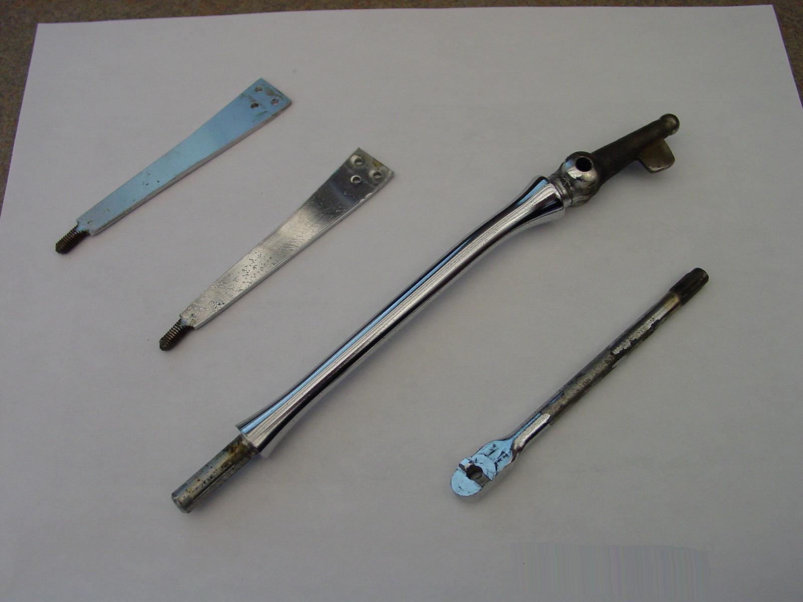

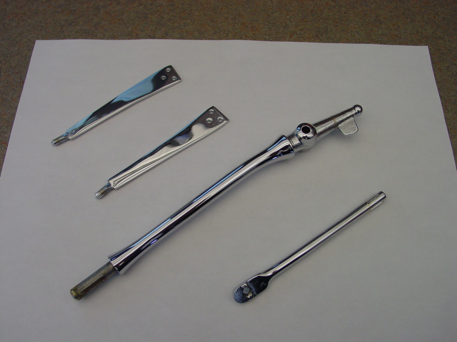

    Before & After pictures of the pieces I had rechromed:
    Two levers for the heater controls, the gearshift lever for a Merc-o-matic steering column, and the turn signal lever. The before picture makes them look in better condition than they actually were.

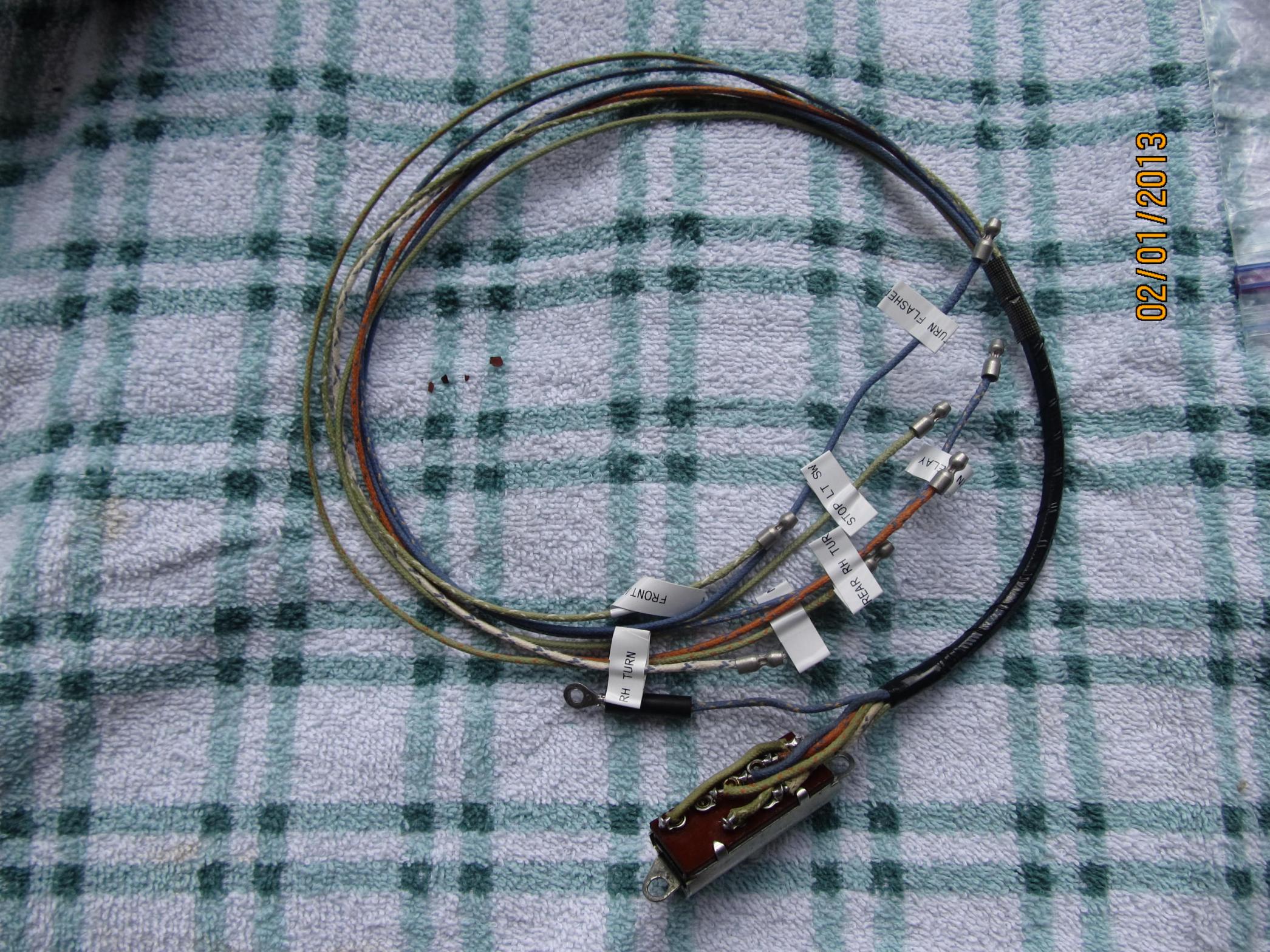

    Notes on steering column wiring and reassembling the steering column:
    Running the turn signal wires down the steering column is major pain in the ass. I tried a few different ways, and spent four hours trying to accomplish this. Let me save you some time. My recommendation is get yourself some 50lb test fishing line. Tie a really long piece, about 3 or 4 feet long, onto each of the eight wires (see the picture). To get the loose ends of the fishing line down the channel, I tied the loose end onto a washer and dropped it down the channel. The weight of the washer pulled the fishing line through. Now you should have eight loose ends tied to a washer threaded down the channel, exiting the hole in the middle of the column. The other ends of the fishing line should be coming out of the top end of the channel, and attached to eight individual wires. Slowly pull one wire at a time into the channel. Only pull it into the channel enough to get the metal connector tip into the channel. The first five wires will go in easy. The last three are difficult because it's getting tight in there. Use dish soap as a lubricant to help slide the wires into the channel. After you've got all eight wires in there, gently pull all eight pieces of fishing line and pull them down the channel as a bundle. This may or may not work. Next, you'll need to pull individual wires down the rest of the way. I pulled on the fishing line that felt loose, until one was all the way through the channel, then worked on the next one. If you pull too hard and the fishing line slips off or breaks, you'll probably have to start over. One more note... don't forget to put the big firewall grommet into your steering column before you run the wires down the column. If you forget, you'll get to take everything apart and do it all over again, like I did.
