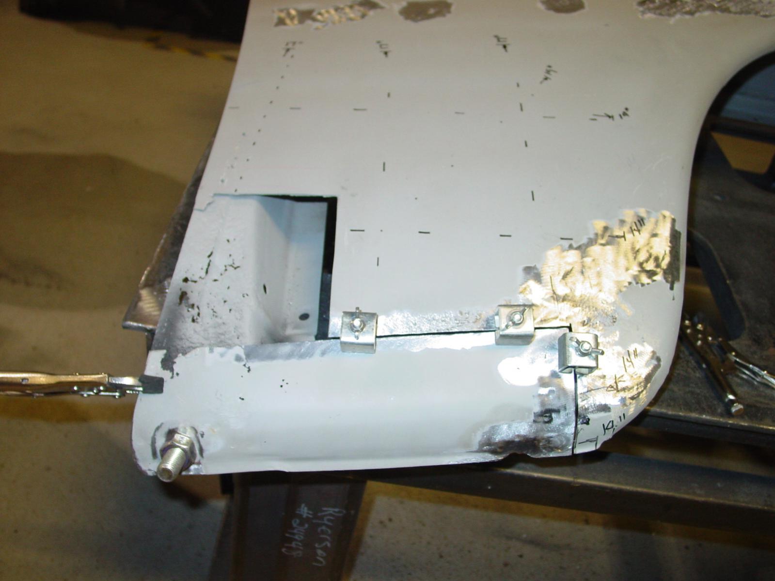

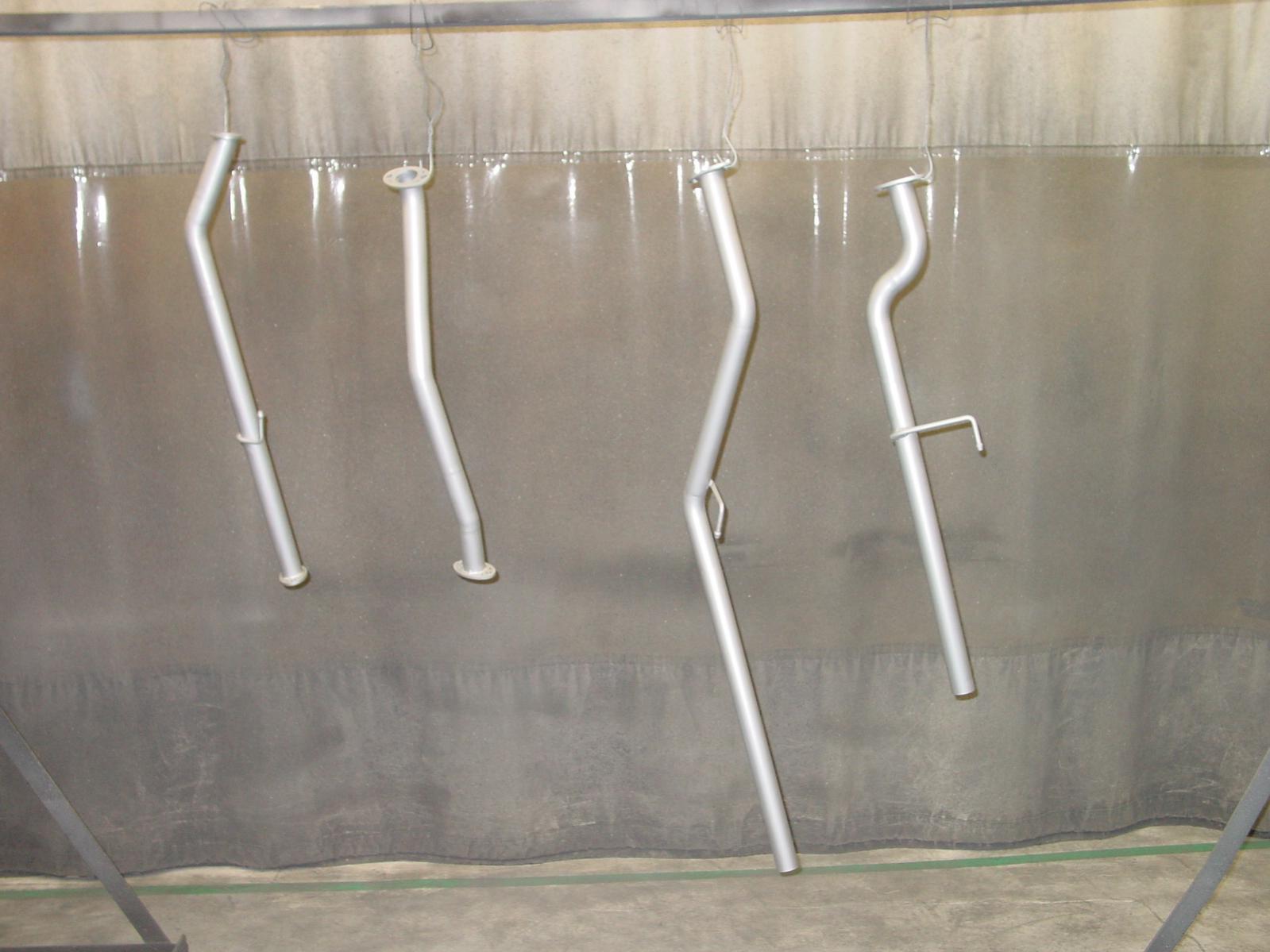

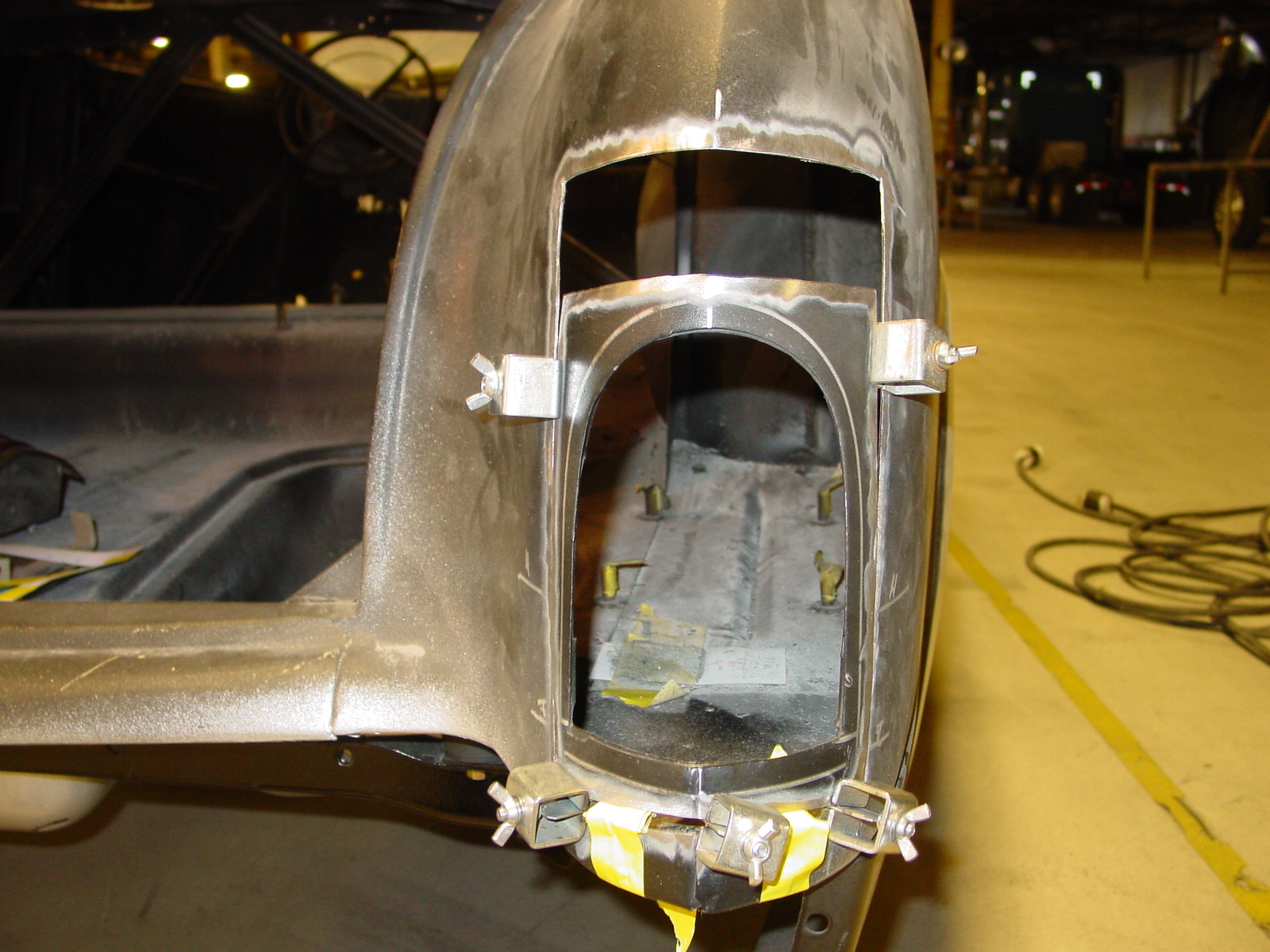

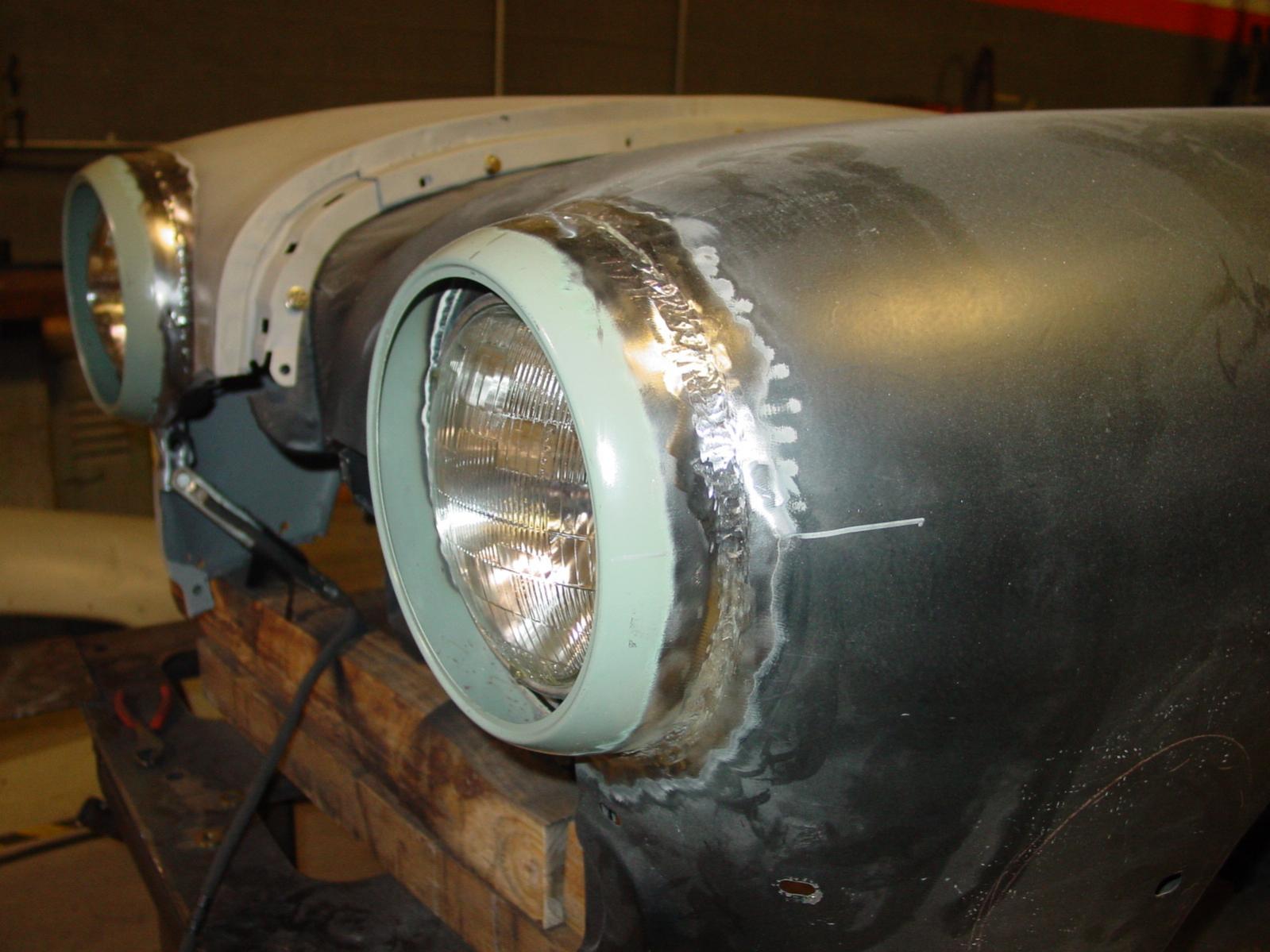

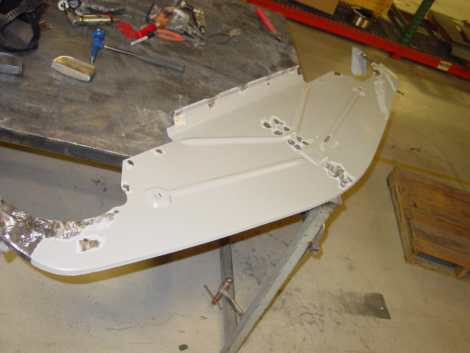

    I've also continued to do body work... frenched the headlights, minor rust repair on the fenders, filled in trim holes on the fenders. Originally, I was going to use the factory Merc grille extensions (aka elephant ears), but I've decided to get rid of them and the parking lights. Those holes were filled too. I had to use two different splash panels to create one good one, since each one had it's own issues. I'm in the process of lowering the taillights too, since I won't be using '51 Merc taillights either. I'm going with '51 Lincoln/'51 Monarch taillights that fit into the same sheetmetal hole, but are not as tall. I've installed the exhaust that I fabricated at well. It currently ends just before the rear axle. I have Brockman Mellowtones to add to the exhaust, once I finish the fabrication so it travels over the rear axle to the rear bumper.

    Yesterday I got the brakes bled, adjusted, parking brake cable installed. Did some front end adjustments to get the alignment close, installed the pitman arm. Once I install the linkage from the column to transmission, this thing just might be ready to move and stop under it's own power. I have to finish up welding on the rear of the car where I am lowering the taillights. After that, I can put gas in the tank and start it, instead of running a rubber hose to a small tank. I don't want to put any gas in, then weld back there after.

    Finished lowering the taillights, eliminated the fuel door, and got my hands on an NOS '50-'51 Merc p***enger door. Friggin' amazing this thing has never been mounted in 62 years. Still has the number stamped on it. I also added rear shocks, and included a picture of the box. I have 4" dropped springs plus 2" blocks for a total of 6" lowered in the rear. Gabriel Guardian 82060 is the correct extended and compressed length for this set up.
