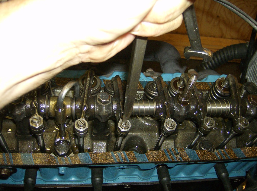

    Cylinder 3 exhaust adjustment, requires a bit of a “knock” in order to achieve the highest vacuum? If I adjust it as quiet as the others, It causes an otherwise nonexistent mild cough...I found a happy compromise.
    Just happen to have a copy of Popular Mechanics Nov 1948. Talks about wedging a screwdriver in the valve spring to increase tension to eliminate a knock, then shim to tighten spring. Screwdriver on Cyl 3 exhaust spring made a difference. Let’s see what happens before I pass out cigars. I will post the result.
    Posted some photos and videos. One photo shows the difference in the quality of the new push rods,another how I use a very large 12” screwdriver and a 5/8” combo wrench. In a video I show how I take the oil temperature. I use a lab thermometer with the tip in the stream of oil coming from the valve train over-flow pipe. (I don’t adjust anything unless I see 140 deg F first, requires frequent reheating.) You can see a couple old push-rods spinning out of round.Another video shows the adjusted result. (Don’t know if you can hear what it sounds like?) Also shown a rigged up a piece of cardboard to amplify the vibrations coming out the exhaust. Luckily with only 2 steps be outside and feel it with my hand. These coughs may or may not show upon the vacuum gauge.]
    I appreciate the comment about giving it a go, rather than ust ask how to do it. However, You obviously haven’t read some of my first posts to the HAMB….lol. I will say, I have made great progress as an amateur mechanic since. Yes, Oil seems to find its way into the air especially at warming RPM’s. It appears to be non-existent at first. The cut-out on a spare-valve-cover is a great idea. I wish I had an extra. Great explanation for shimming, a good thing to know! As far as order of adjustment, this time I use the firing order, and always adjust the exhaust valve first.
