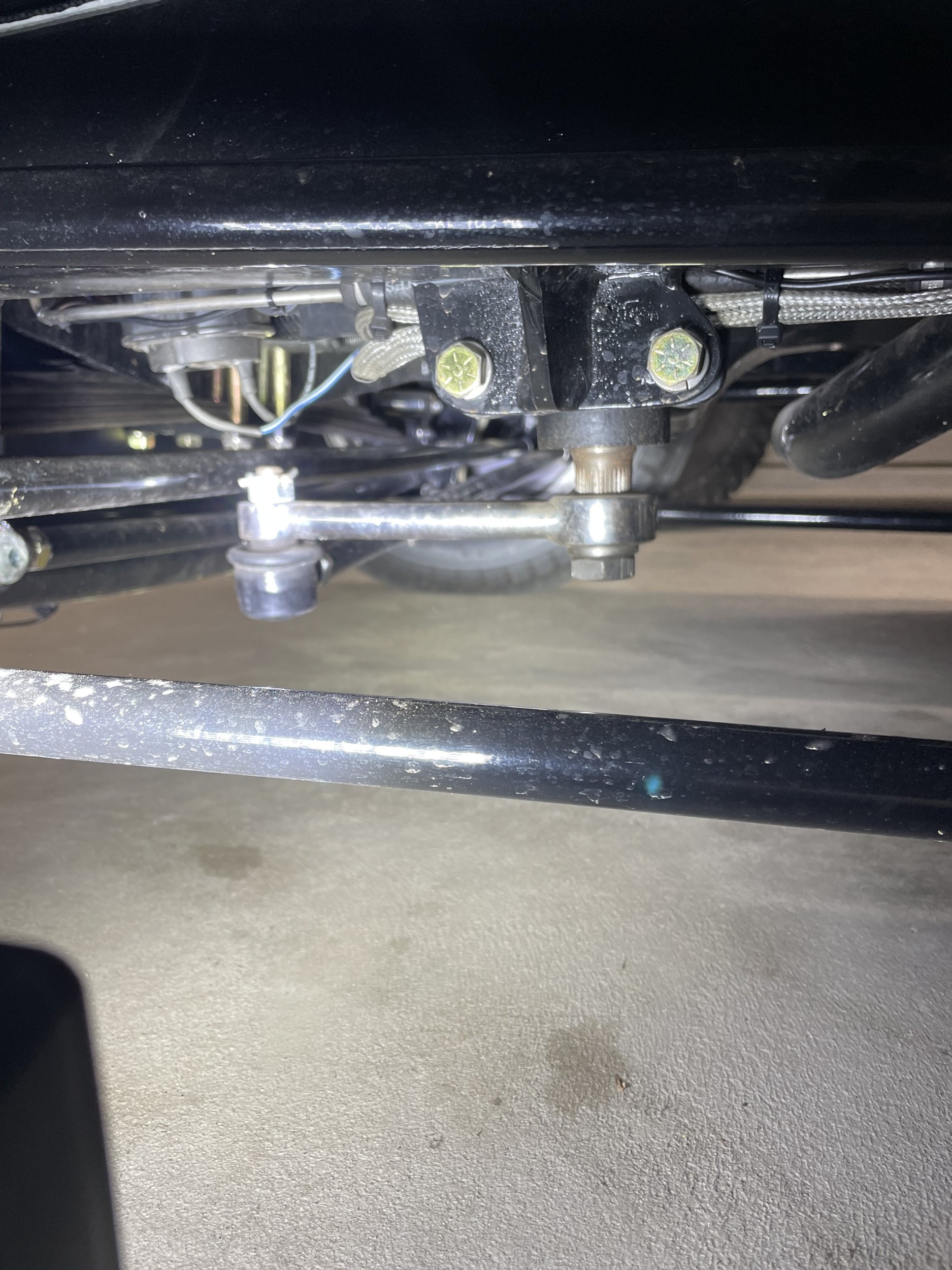

  18. Happydaze
    Joined: Aug 21, 2009
    Posts: 2,453
    Happydaze
    I was going to say Unisteer had folded some time ago, but seemingly not! Good news! I love the unisteer steering on my roadster.
    As regards the ops queries, on full lock the end protrudes from the frame about 2.5 inches, clears my hairpins. In plan view whether the swap alters the parallelism is a mute point. Must depend on the position of the vega mount and the related pitman arm length. I can't recall how parallel mine was with the vega box (I suspect not perfect by virtue of the motor mount) but with the unisteer it's not parallel, but not horribly out of alignment. Things remain level with the swap, but there is a shallower mount available, plus the standard mounting can always be refilled to change the height. Drives great nevertheless. I swapped from Vega to get quicker steering, and I'd say mine is perfect, for me anyways!
    Pics are worth a thousand words!
    Chris
    05snopro440 and pprather like this.
