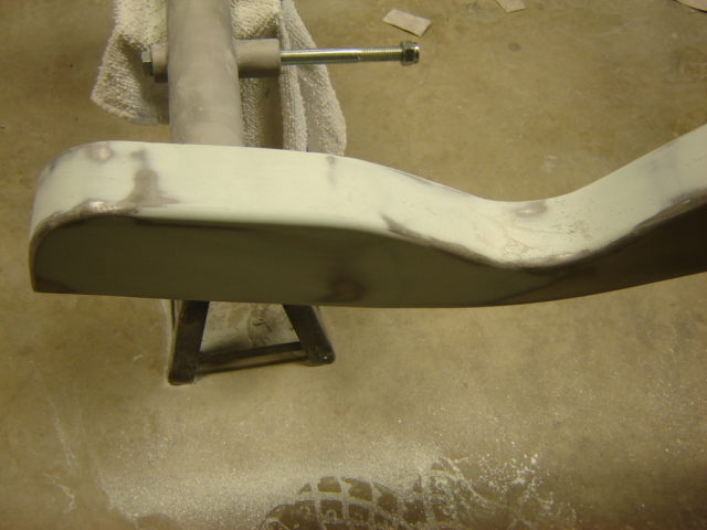

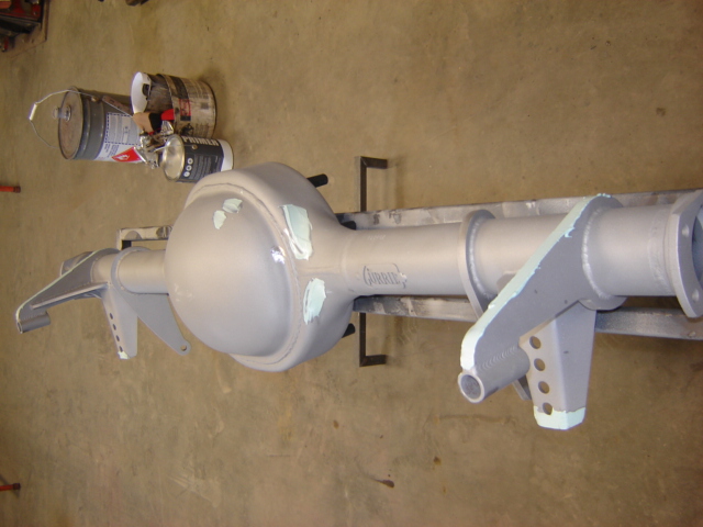

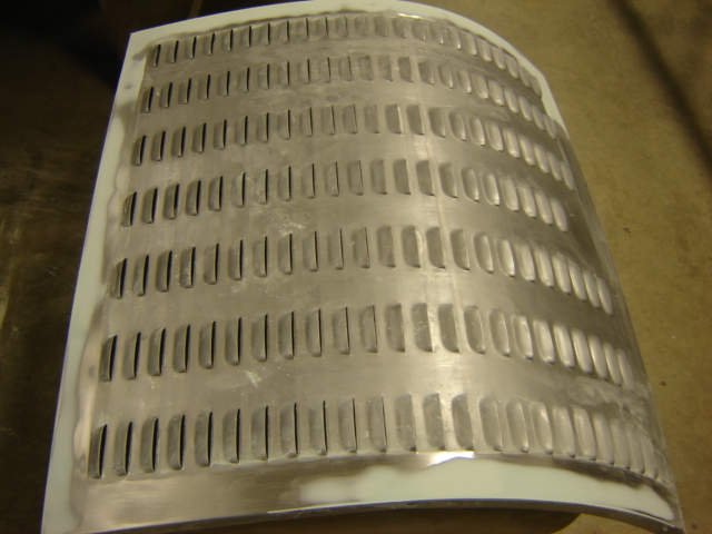

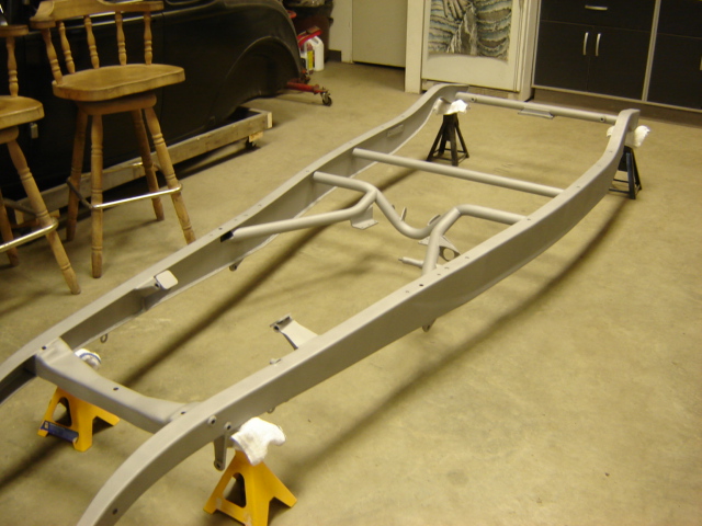

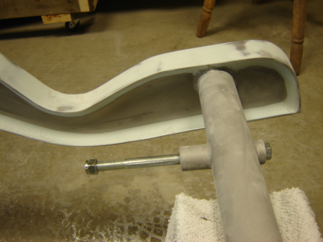

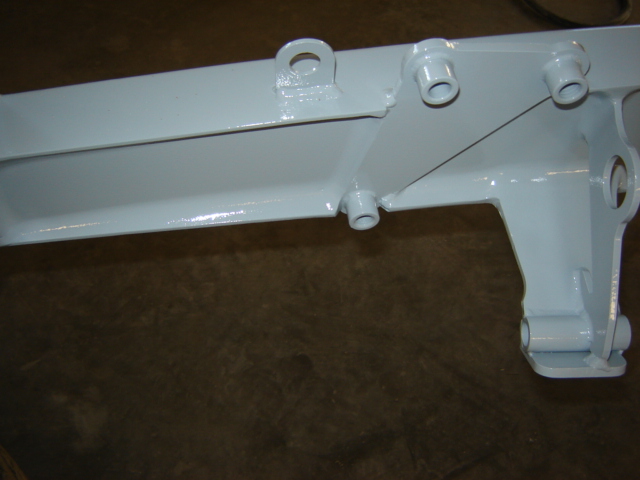

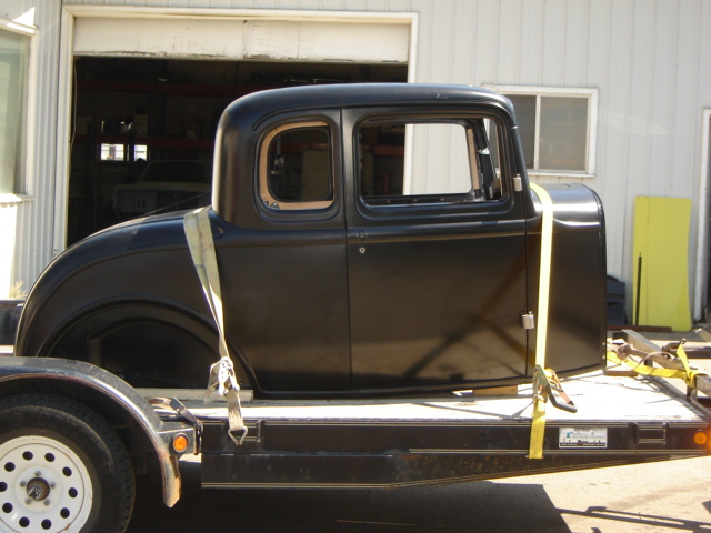

    I've started the build on the project... Roof will be chopped about 3.5" - 4". Trunk lid has been louvered. So-Cal ch***is has been sand blasted, filled and epoxy primed along with bobbing the rear frame rail to accommodate a custom made roll pan.

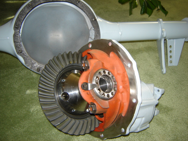

    A 350/290hp crate motor and new Tremec TKO600 and Currie 9" rear with 3.23 gears will be installed. It will ride on a traditional '32 drop axle and buggy spring rear. Brake and fuel lines have been bent up and test fitted.
    A fuel tank from Tanks inc. was purchased and just recently a set of Speedway aluminum bomber sets have been picked up.
    The car will follow the lines of a traditional Bonneville flats racer from the '50s...

    I wanted fuel economy so I went with the highway gears as I plan to do more highway driving to far away locations and meets. Small block chevys are not at all good on gas even under the best conditions. It is not practical to drive fast and crazy in my city as the roads are in deplorable condition so I knew I wouldn't mind the gearing.
