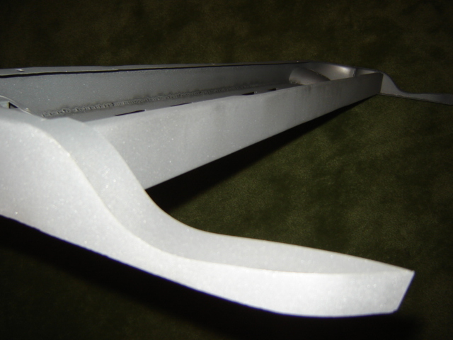

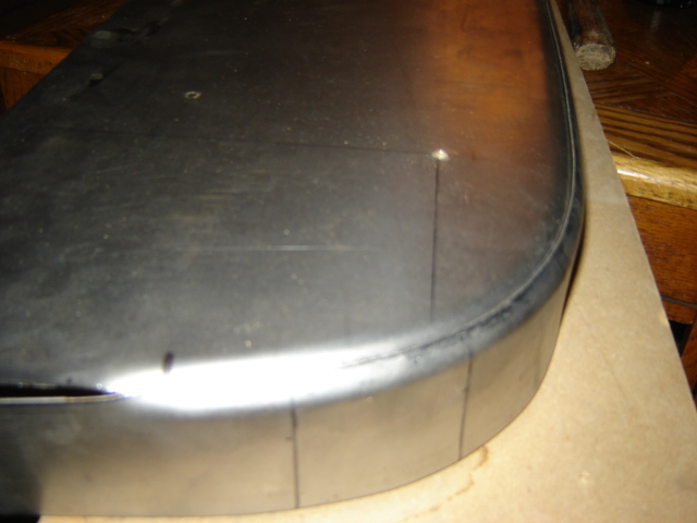

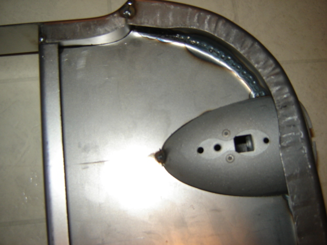

    Tonight I got the roll pan edge rolled. Next mig up the edge.

    A little more work on the roll pan...

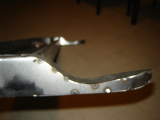

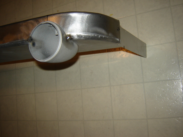

    A little more work getting the area that blends into the body bent up and tacked in place. Once that is done it is off to get a pile of louvers punched into it.

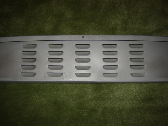

    Louvers are punched. Next step is put the body filler on it.

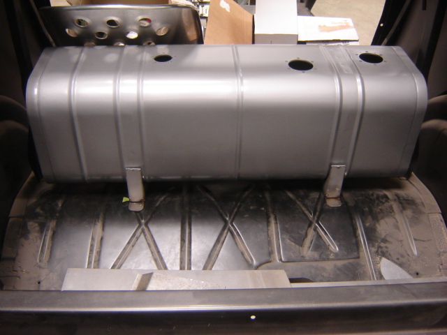

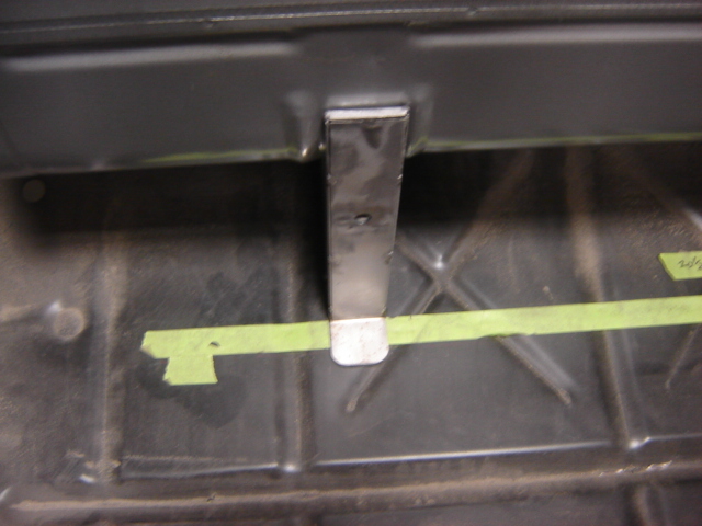

    Custom made brackets for my Tanks inc. fuel tank are spot welded together

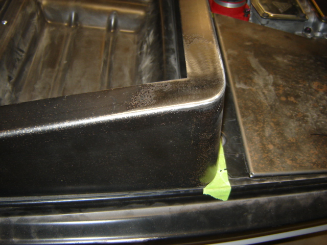

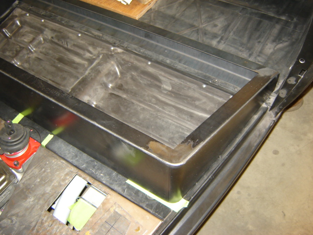

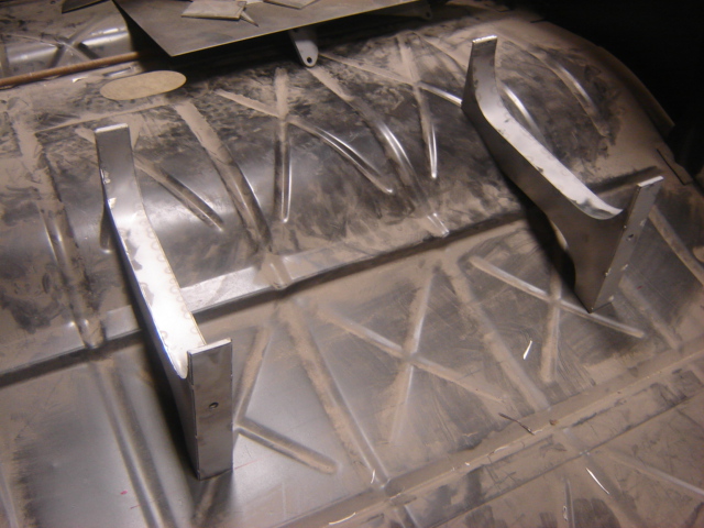

    DSC02260.JPG Forward floor trimmed and tacked in place. I had to cut the portion in front of the seat and put a downward bend in to make 1/2" drop to follow the contours better.
    Fuel tank brackets are trimmed and will have a base welded to enable them to be bolted to the floor.

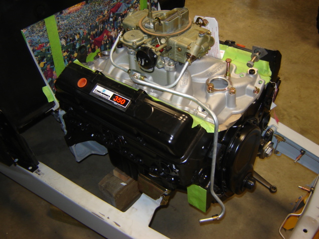

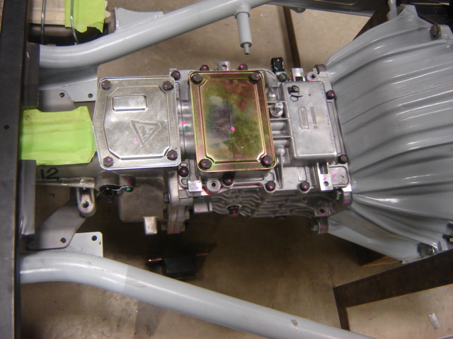

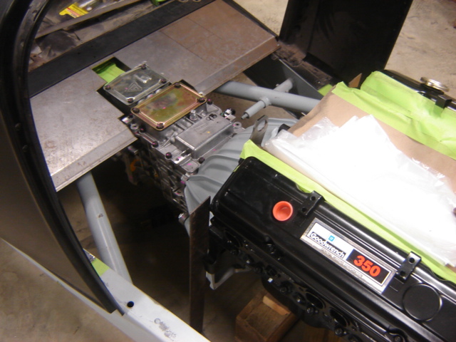

    350 ci motor and TKO600 installed for floor and firewall trimming and fitment. Fuel tank brackets mostly fitted...

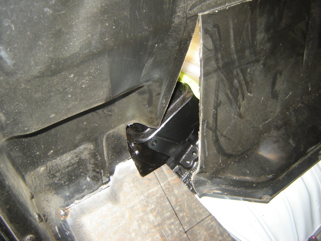

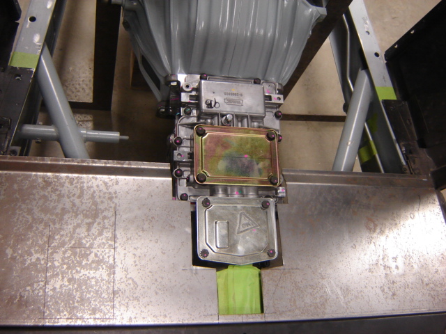

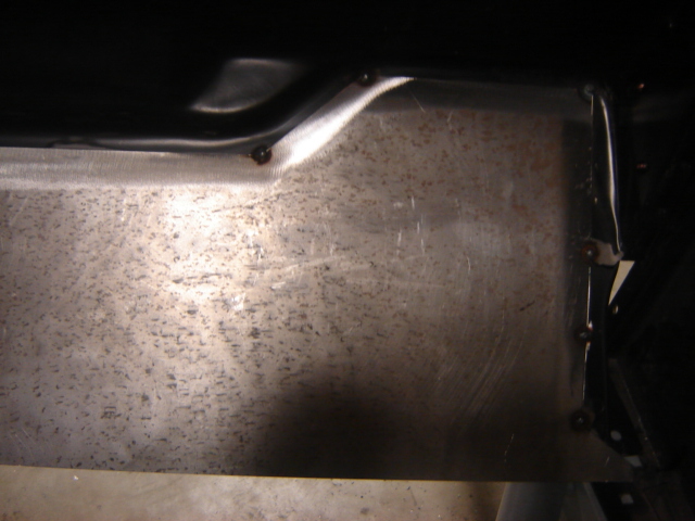

    Today the firewall was trimmed to get in place so I can determine how best to weld in replacement material to cover over the hole...

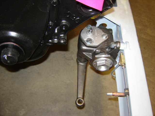

    Firewall clearance mocked up and floor trimming. Checked clearance of Zips fan riser to the LT-1 fuel line. Borgeson steering box set in place.
