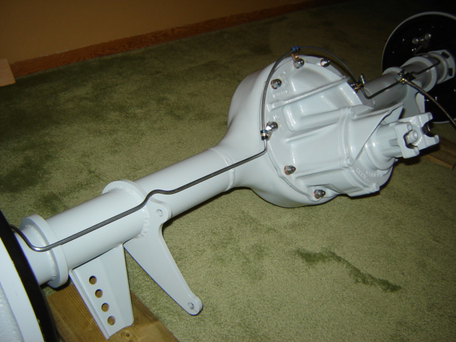

    The diff is assembled and brake lines bent up...
    brEad, kiwijeff, mgtstumpy and 4 others like this.

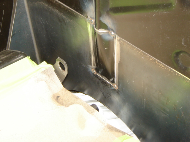

    Floors are a little further along. Making them removable...

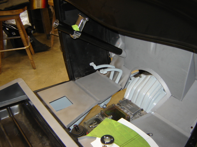

  8. Groovy
    Joined: Aug 9, 2015
    Posts: 248
    Groovy

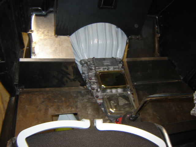

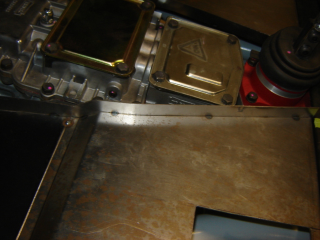

    Floors are nearing completion. Next is the trans tunnel...

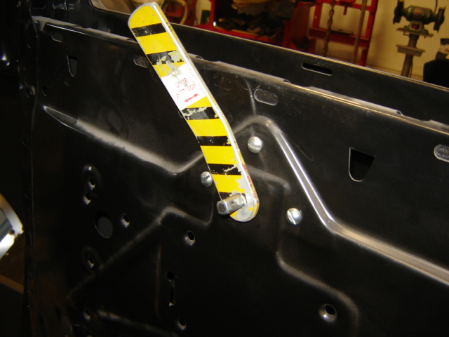

    Found some Door Jettison handles from a Dehavilland aircraft to use as door handles.

  9. loudbang
    Posts: 40,335
    Door handles are a nice touch.

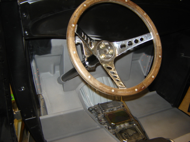

    Steering column was fitted and found a steering wheel to use. Sandblasted all the new metal in preparation for Tig welding. Seat frame has lower mounting nuts added. Next will be 1/2" square seat belt mounting nuts and completely fill top area with metal.

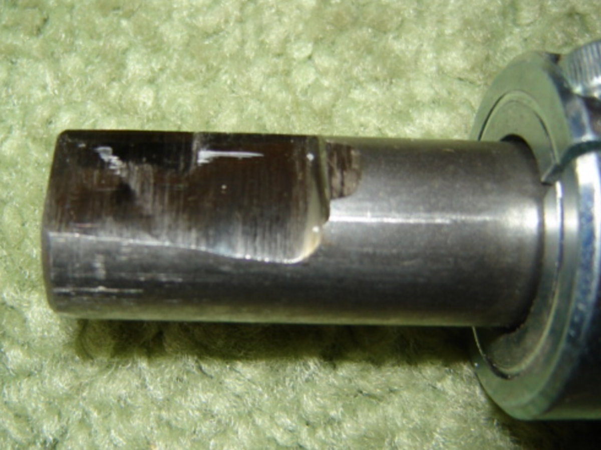

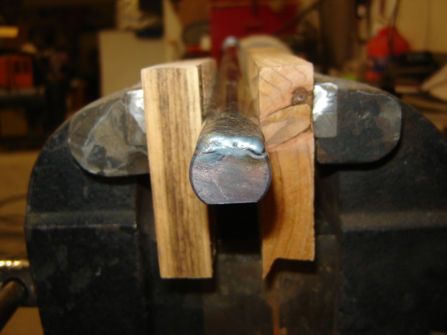

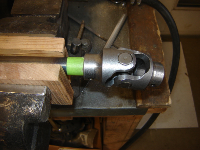

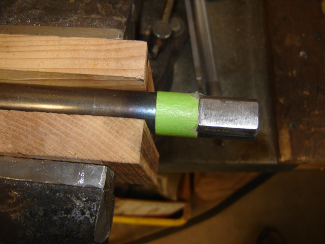

    I purchased a steering column from SPEEDWAY. The item is built well but Speedway elects to grind one side of the Double D on a belt sander while the other is machine cut??? The U-joint flopped 1/8" either way because it was done so poorely and too much material was removed. Was told that this is how they come and they won't exchange it... WTF. Talk about horrible customer service.
    I elected to get it tig welded and re shape the end myself...

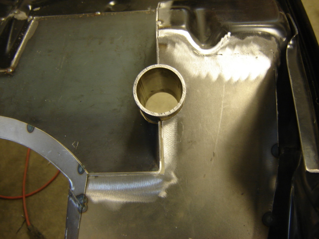

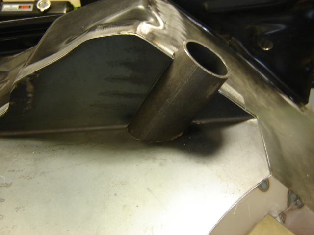

    Made a pedestal to mount the LimeWorks column support. Need to re fit firewal and column so I can trim height and weld to dash.

    im reluctant to buy from speedway.if u have paid by credit card you should be entitled to a refund not fit for purpose.

    That looks more like an idiot attacked it than it manfuctured like that, maybe someone butchered it then returned it? Did you send a photo of that to Speedway?

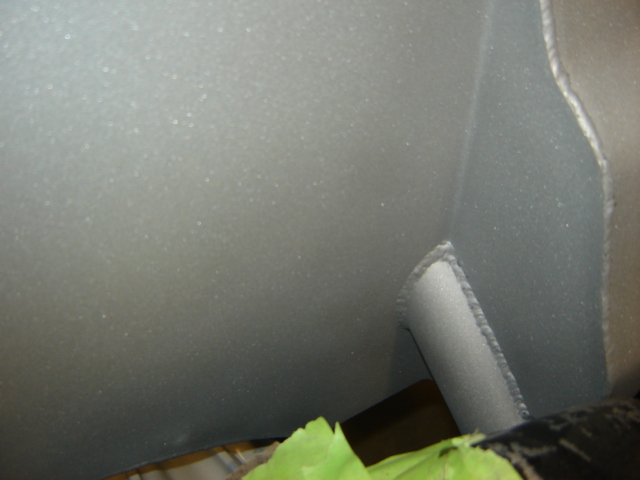

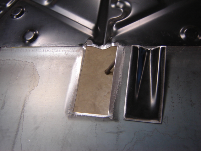

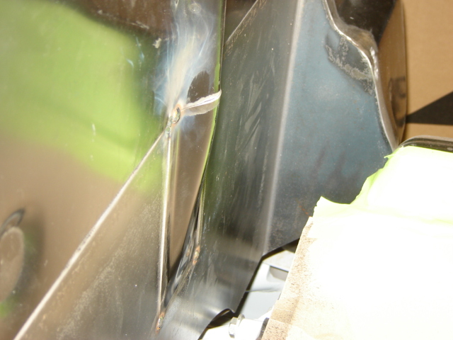

    Today I picked up the firewall. I paid a shop to tig up all the seams so I would have tidy welds to work with.

    good move looks like a nice job there.

    image.png What? Is Speedway selling used parts now? Sure looks like crap!

    This column came in a heat sealed bag. I was told that Speedway modify's them to accept the Double D u joint. Can't figure why this cant be done at the factory since the other side is machined properly. They must have some flunkie in the back removing them from the boxes and grinding them on a belt sander, resealing them and sending off to customers.
    I wrote a very negative revue about it on Speedways site and low and behold it was not published...
    but someone else did a revue about the same problem they encountered with their column being ground the same way and it is listed.

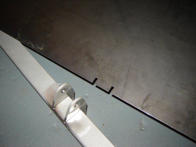

    Today I got a perch tacked in place for the Limeworks column support. Also sand blasted the firewall Tig welds to get a better idea how it turned out...

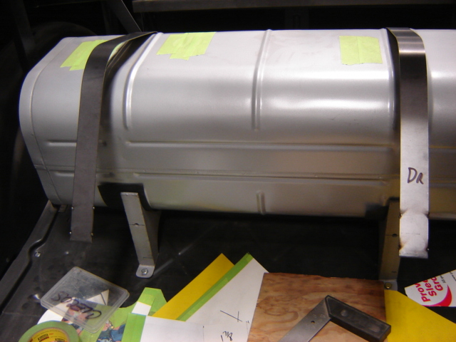

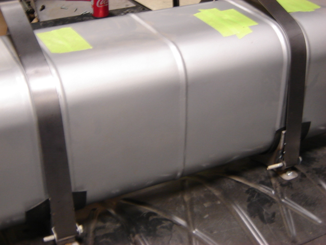

    Fuel tank supports are drilled and located.

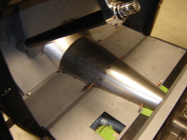

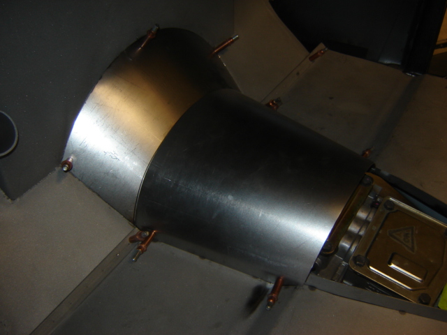

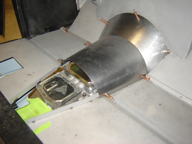

    Today 2 pieces were fitted to the trans tunnel...

    I liked your fix on this column. I don't understand Speedways poor customer support at times. It seems kind of hit and miss. Some times they will bend over backwards to make you happy and other times not.

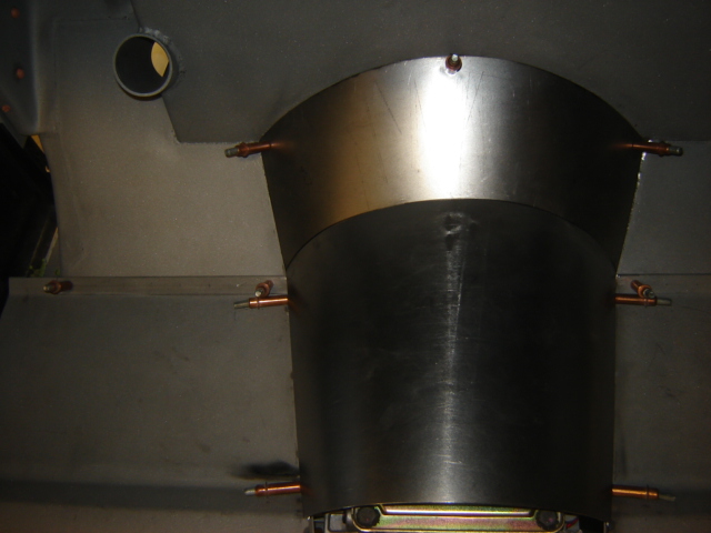

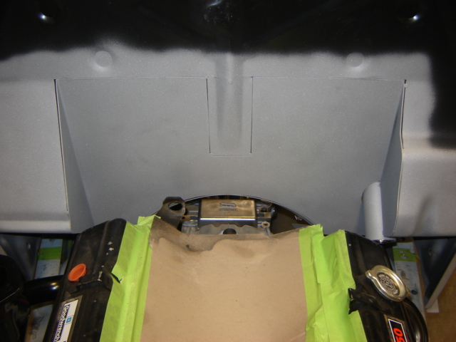

    Rear 1/3 of the trans hump was finished and capped. Work on the fuel tank strap was started...

    Interior components are nearing completion. Just a little more tig work and I'll apply body filler to smooth each piece out...

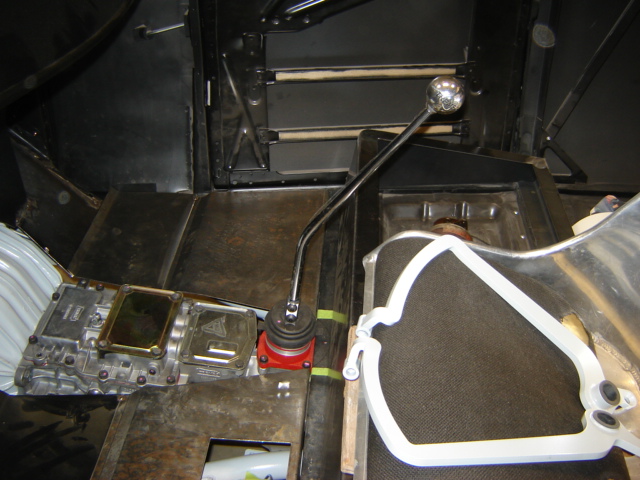

    DSC02884.JPG DSC02886.JPG DSC02887.JPG DSC02888.JPG DSC02891.JPG DSC02889.JPG DSC02890.JPG DSC02884.JPG DSC02886.JPG DSC02887.JPG DSC02888.JPG DSC02891.JPG DSC02889.JPG DSC02890.JPG Shifter boot mount was made from a 3 inch dia tube and a grove was machined into it to accept a Tremec rubber boot.
    Speedway seats had a plywood base that didnt look finished so I made new ones with an additional rear portion that is kicked up to match the profile in the seat. Next off to get upholstery installed.
