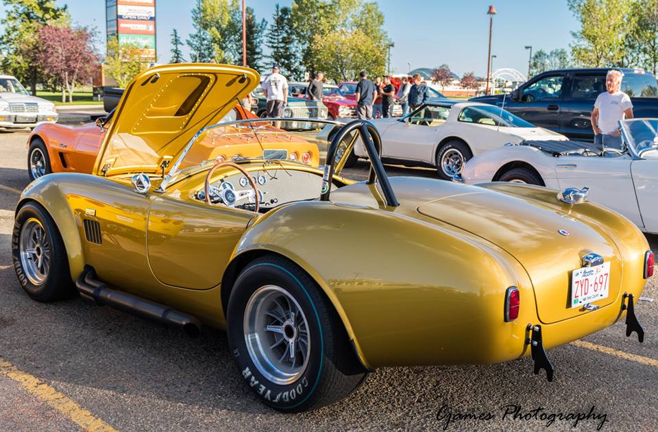

    I'm use to noise and exhaust fumes with my Cobra... 14184550_1930835077143511_7699172145493931360_n.jpg

    You’re just gonna have to drive faster than the fumes :D and I can see that you probably have some practice at that :cool:
