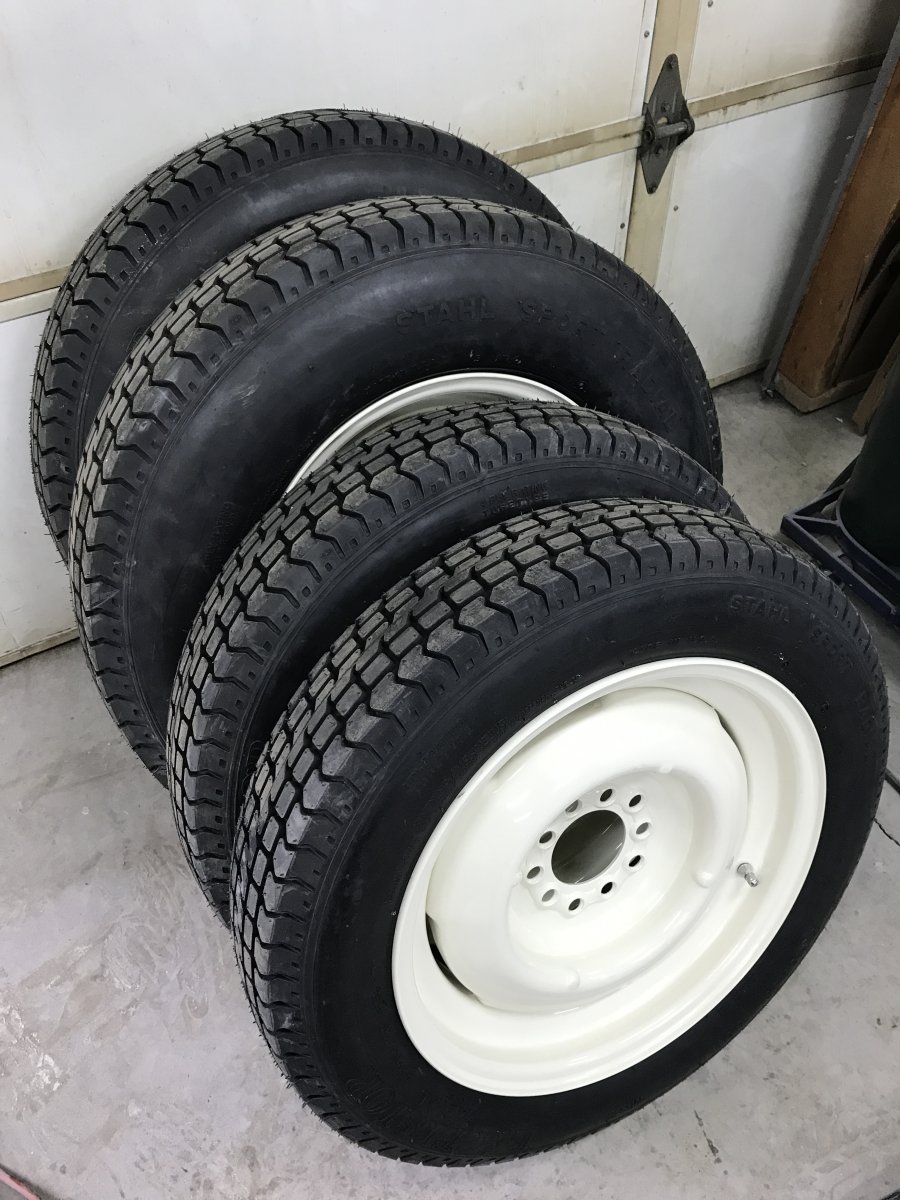

    I just got some 16" WV Gennie 14 series wheels and Excelsior tires ( 5.00 and 7.00) from Summit. 16x4.5 and 16x6.
    They came with a really nice powder coat primer and I had them powder coated in Wimbledon white.
    They mounted up and spun up on a Hunter road force balancer with no problems, only minimal weight needed on the rear wheels only.
    The front wheels and tires required no balancing weights at all.
    Who cares about the dual bolt pattern thing, caps will be over them anyway.

  25. Larry,those look nice!
    Are they painted or powder coated? HRP

    Powder coated Oyster white (identical to Wimbledon white)
