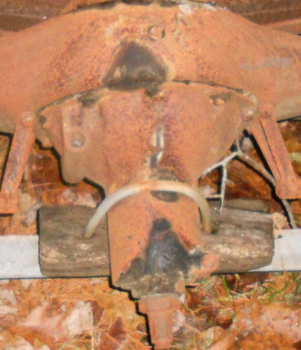

    hi my name is ryan i just got this rear end and not sure what it is i used the serch and came up with not much so here it is

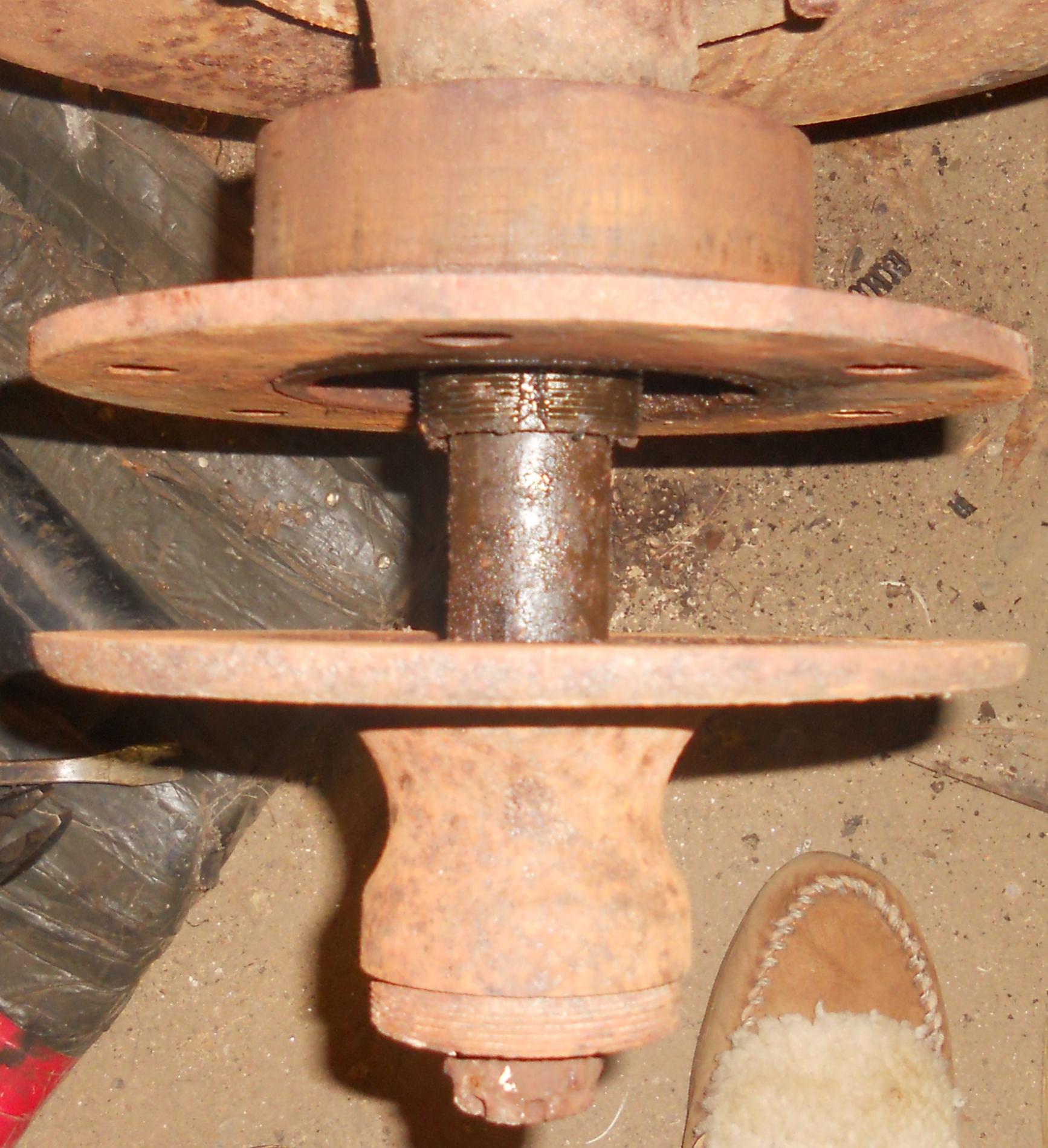

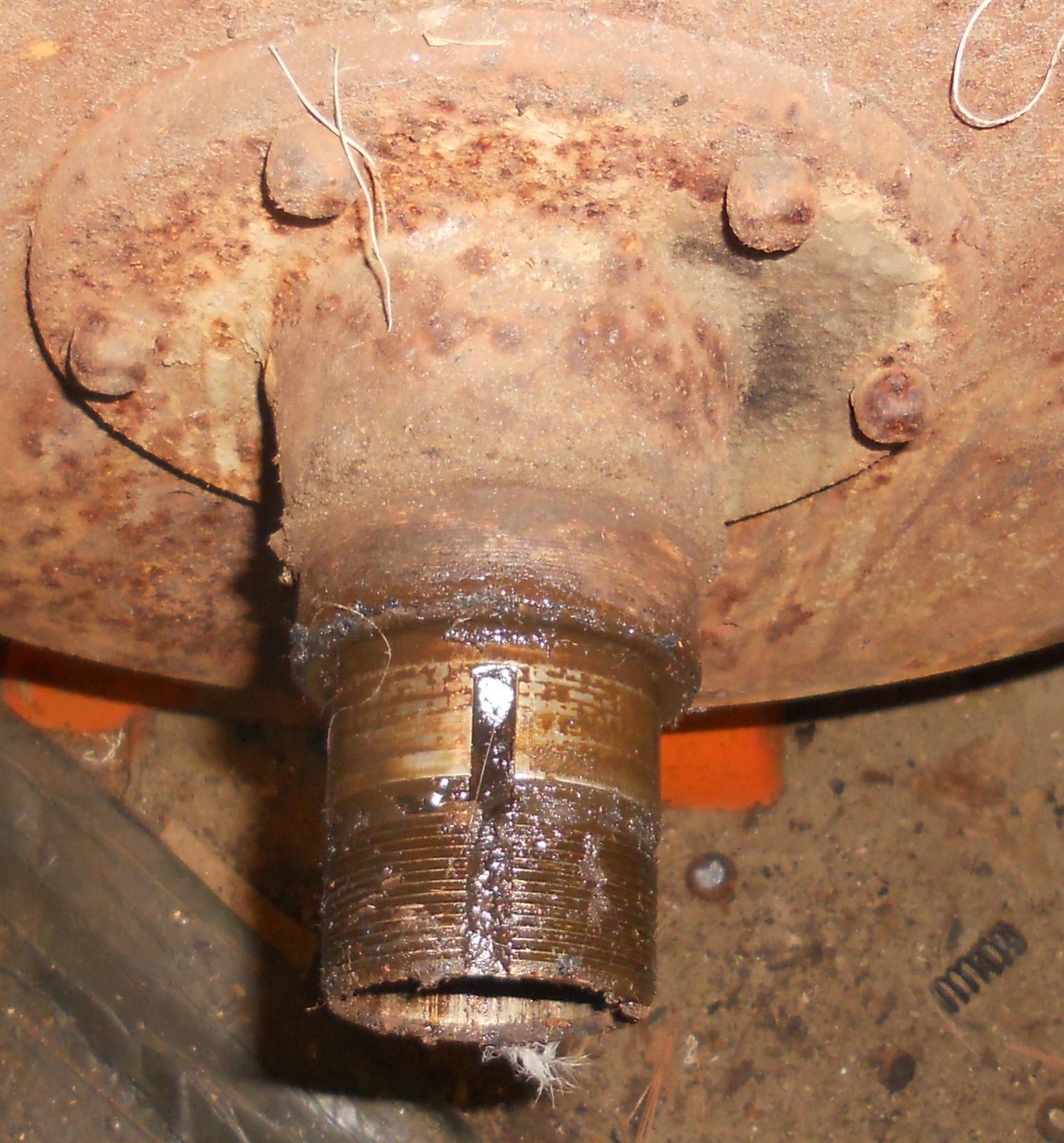

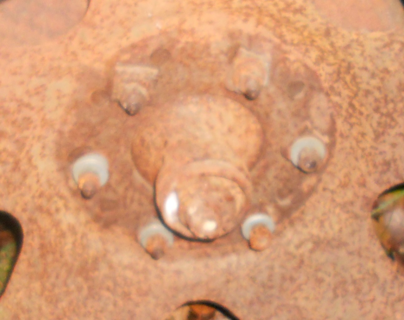

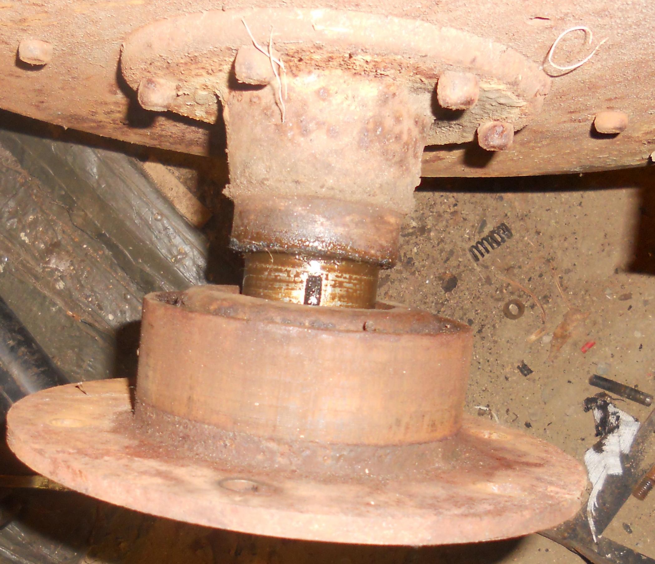

    its has full floating axles

  7. I don't think that is a full floater,,,,,,

    it looks like one to me and the wide 5 hub slides right on and the body is what its going in.

    Not anything you would want to use on a rod but scrap value will put a few bucks in your pocket to go on the car.

    Hey, what'd be wrong w/some 4.88's ...or a worm drive? ;)

    I like the way it looks its diffrent and eney one can use a newer rear end. also its 4.41 in it but im usein 20'' in the back 18'' up front.
  12. Not to argue, but, a true full floater has to have 2 bearings in the hub to be fully self supporting. whatever,, I hope it works out for you.

    Lokks like some oval track stuff mixed in that lashup, and some of it might be desired by some nostalgia racer. I'd set that stuff aside and at a good time, would find a vintage racing website, then put the word out. Be a shame to scrap it.

    your right to bearing would be full floating and i have a buddy that has a bunch of vintage race stuff that where i got the hub and rear end and not scraping it i think its cool for my next rig.
