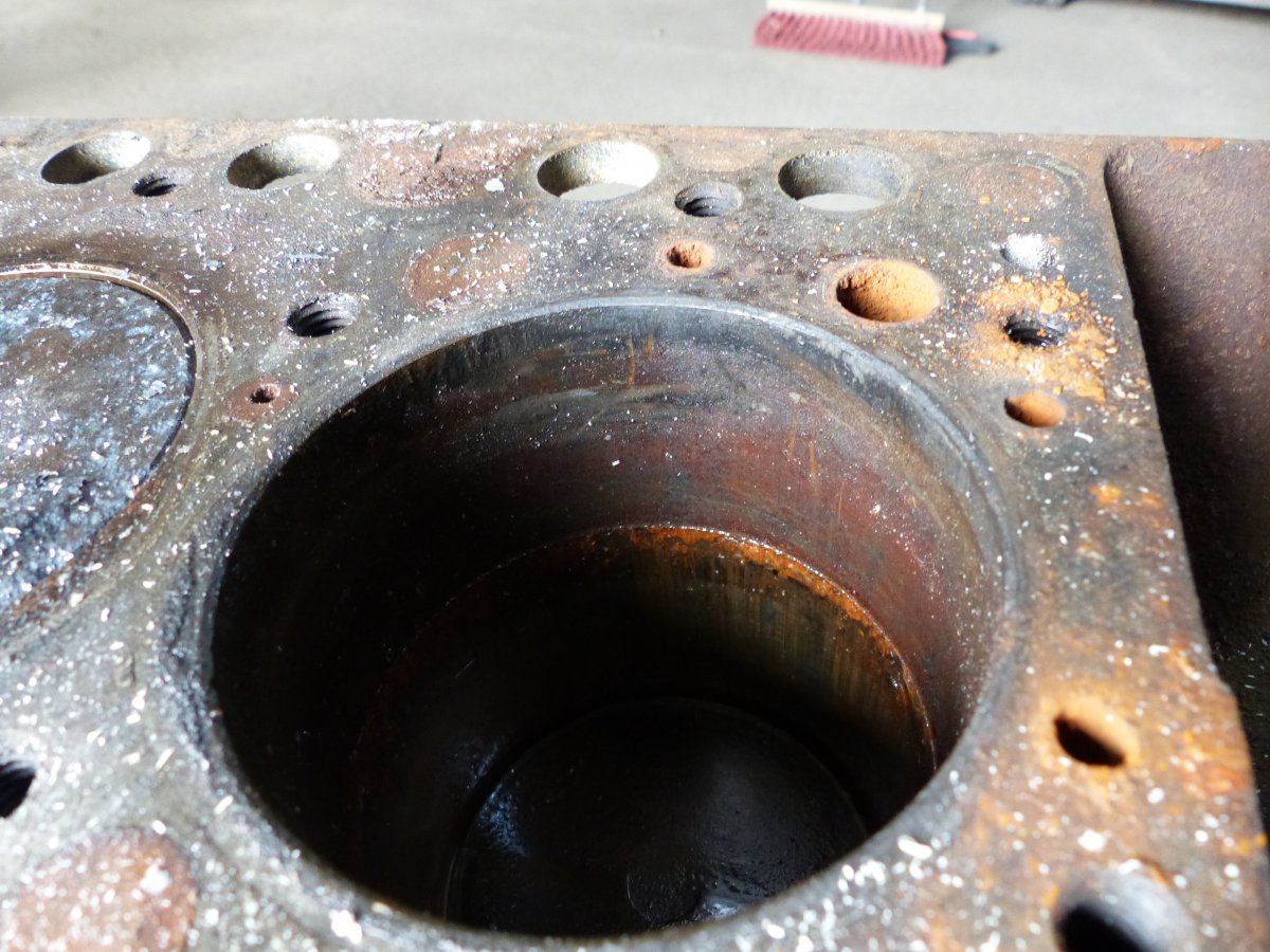

    Here you can see the latest results of trying to get that damn pistons out. First I put in some citro acid for a night. Did remove the surface rust in the cylinders but pistons still stuck. Then I used the explained charcoal method and heated the block properly. In every corner it was damn hot. I tried to cool the pistons down by spraying brakecleaner on them. Be careful if you try that on your own. I saturated the air with gased out brakecleaner and it did explode a bit. I **** my pants but I'm not injured or something. A that time the charcoals where totally gone and out of the engine. Must ignite because of the heat of the block or something. Pistons still stuck in place. But if you have such a problem it is worth to try it with that method. If you clean up the block before you can have a cool BBQ.

  8. If the pistons have swollen because of corrosion would it help to drill holes in the dome area to relieve pressure?
    What about trying CLR in the cylinder bores also? Maybe that would break the bond.
    I've beat them out before with varying success rates but just a couple random ideas.

    I was thinking along the same lines. You could drill a series of 3/8" or 1/2" holes around the perimeter which may allow the pistons to release from the bore. Worst case you can smash and crack the centre with a big hammer and large steel punch (or a piece of pipe). Once this is done you might be able to get some Coke or CLR in between the piston and bore.

    As mentioned earlier, you risk breaking the cylinder wall in this manner.
    From the pictures you originally posted the pistons are junk so just start drilling holes through the tops around the permieter and behind the rings. Be cautious and keep clear of the cylinder walls.
    Another option is to put the whole mess in a caustic hot tank for a couple of days, if you have such a thing in your area.

    I think the corrosion of the aluminum pistons has created a tighter fit with the cylinder wall. Also corrosion in the ring land behind the ring pushing it into the cylinder wall. I would have thought the acid soak would help more than it did, I would keep trying that. Of course acid won't dissolve any oil-based, so try to clean the bore of any residual penetrant liquids before the acid.

    Did you try the Acetone? Try 100% Acetone. CLR stands for Calcium-Lime-Rust. It is available in most hardware and grocery stores in the US. You should be able to order It over the net.
    Most auto machine shops in the US have a hot-tank or a bake-n-blast. Both get the entire block up to 200 F or more. Shouldn't cost much. Problem solved.

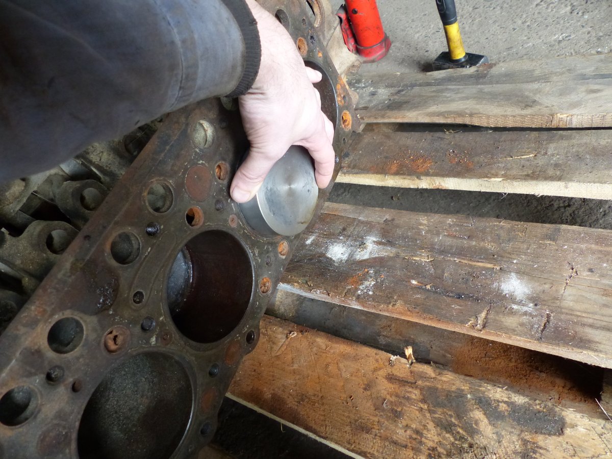

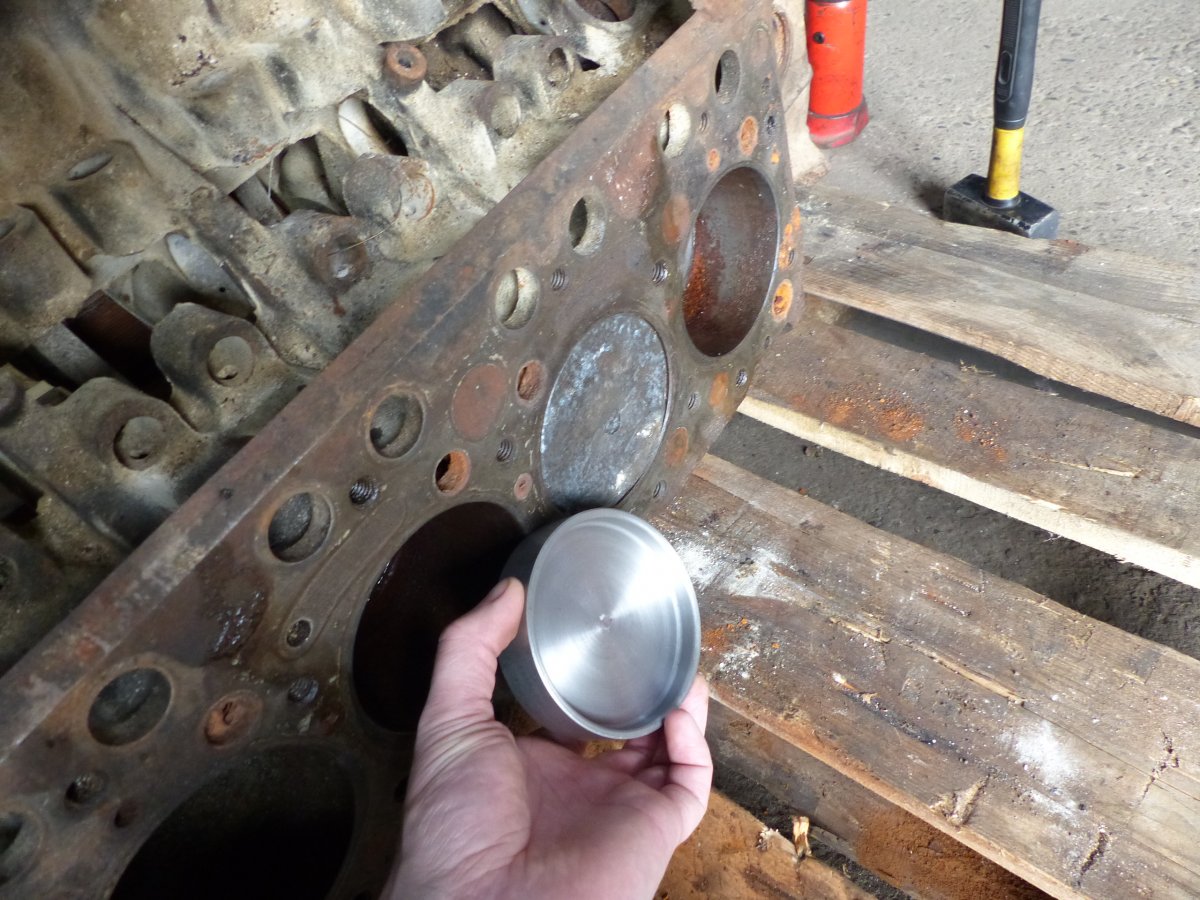

    I was able to get those stuck pistons out of the block. Some guys from the machine shop at the university made a plate of thick steel to put on top of the dome pistons. This way I can get more hammering power to the outer section of the pistons. It took a half of a day hammering those f*****s out but finally, I made it.
    Hmm, not sure why but I can't post the pics.
