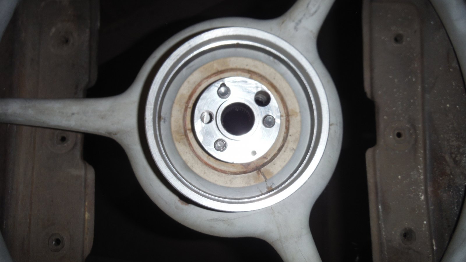

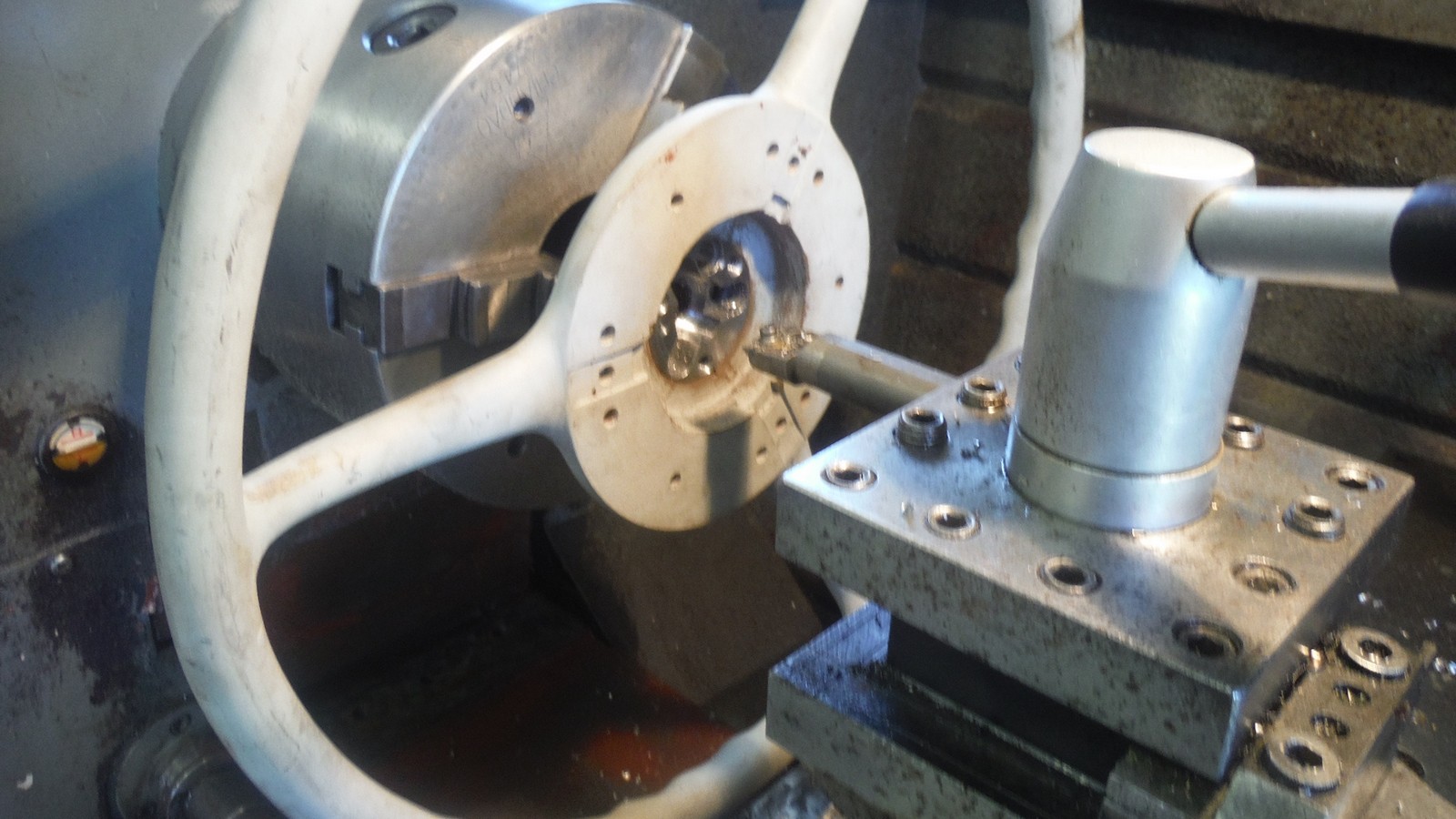

    Kinda late to the party, but I'd like to add that "the complexities" of adapting a steering wheel to a GM column are not insurmountable.
    Granted, this is an original '40 Chrysler wheel and a newer Malibu column, so your situation may be different.
    I still have to sort out the horn wiring.
    The '40 Chrysler wheel hub....
    To mate to the GM tilt column....
    Bore out Chrysler hub to accept the modified GM hub....
    Drill & Tap 1/4-20 for Chrysler "horn blowing ring ground cup"....
    horn blowing ring ground cup, item 66
    Horn blowing ring ground cup installed with 3) 1-4-20 BHCS...
    Bottom view w GM hub ***embled. There's also a large diameter ring pressed onto the Chrysler wheel to match the outside diameter of the GM upper column (the part that tilts)
    As it is right now..... the center disc is a bit off because it's just sitting there; it is not fastened on
    Measure up the hub area of the wheel you want, then measure the same from whatever wheel was on the car when you got it for comparison. It's just possible that you can bore out the hub of the wheel you want and "salvage" the splined hub section from the whatever wheel.
    Keep in mind you should secure the ***embly with 3) 1/4" to 5/16" SHCS; do not depend on a press fit.
    You'll have to come up with a way to activate/cancel the turn signals if that is not already there.
    And, don't forget the horn function.
