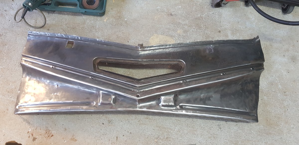

    I learned through necessity. Some parts are not re-popped, or hard to find. This ‘60 Caddy floor brace is an example. All the braces are excellent but this one. Would have been much easier with a bead roller, but I’m not getting one at this point. Various hammers and a few hard maple formes, a little torch welding, and I have a brace.
    UNSHINED 2 likes this.

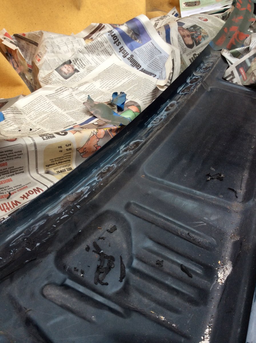

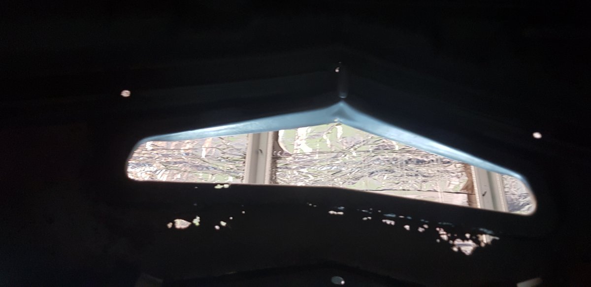

    Something I did a few years back after they called from the gl*** shop with news after they removed my windshield. Luckily, I had a donor vehicle which I used to replace the rusted out stuff. It was actually a little complicated as it involved three pcs all coming together. In the end the repair was practically invisible which for me was a major accomplishment as I'm not a body guy by any stretch.

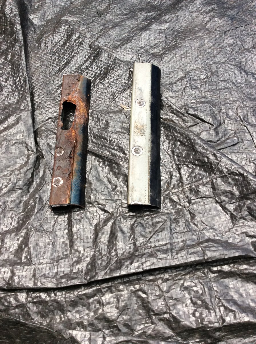

    A couple more. Donor parts.
