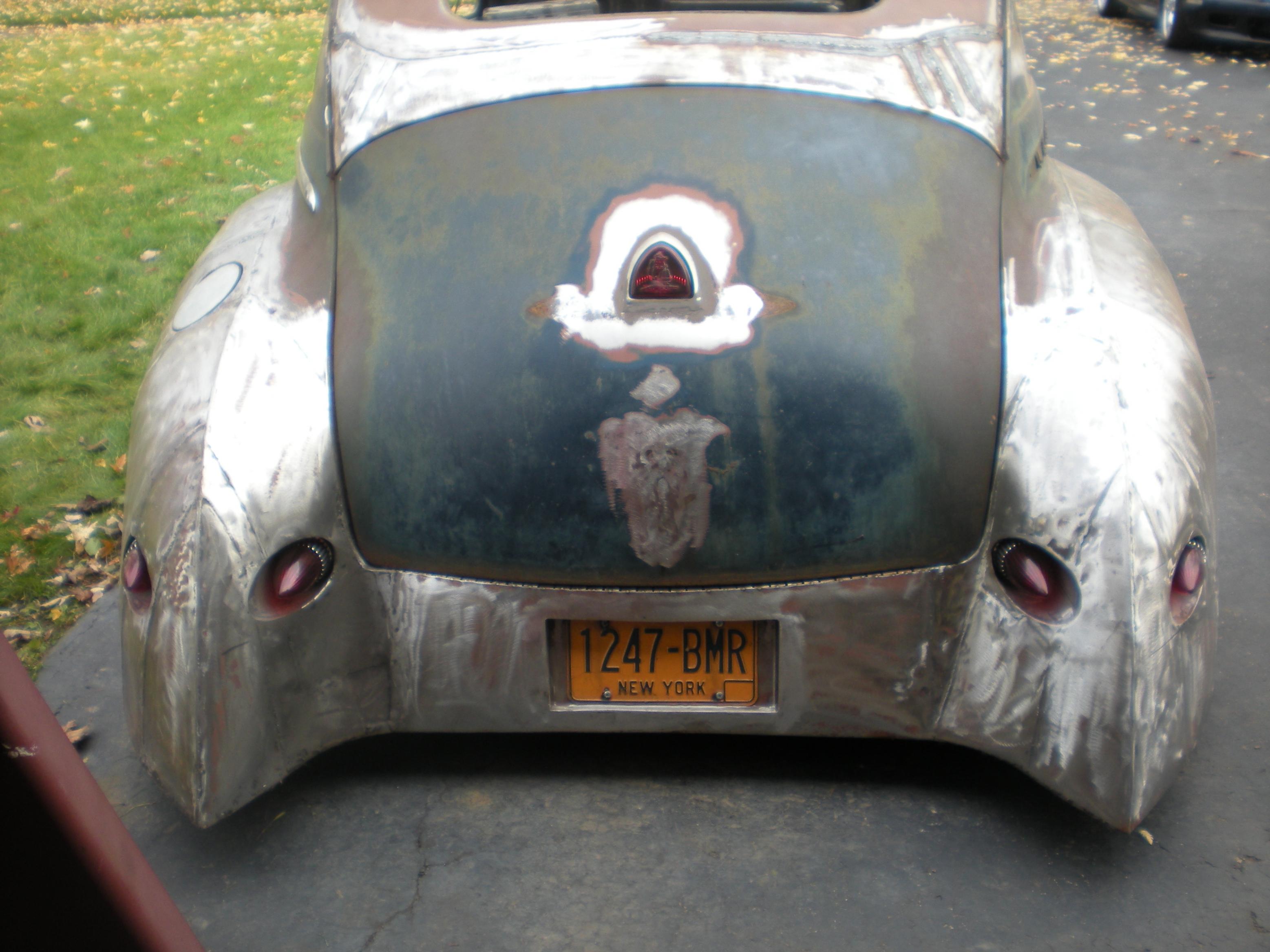

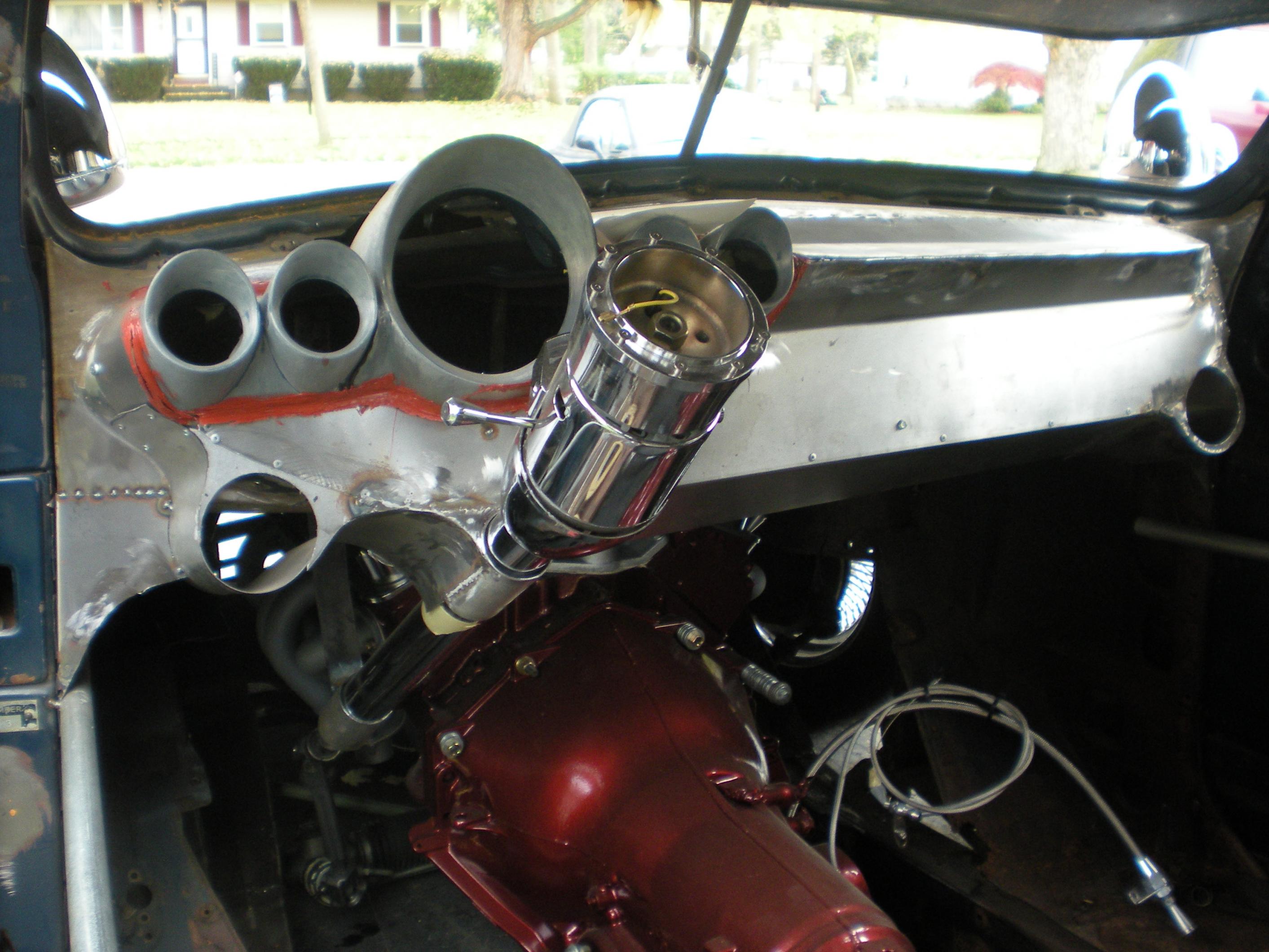

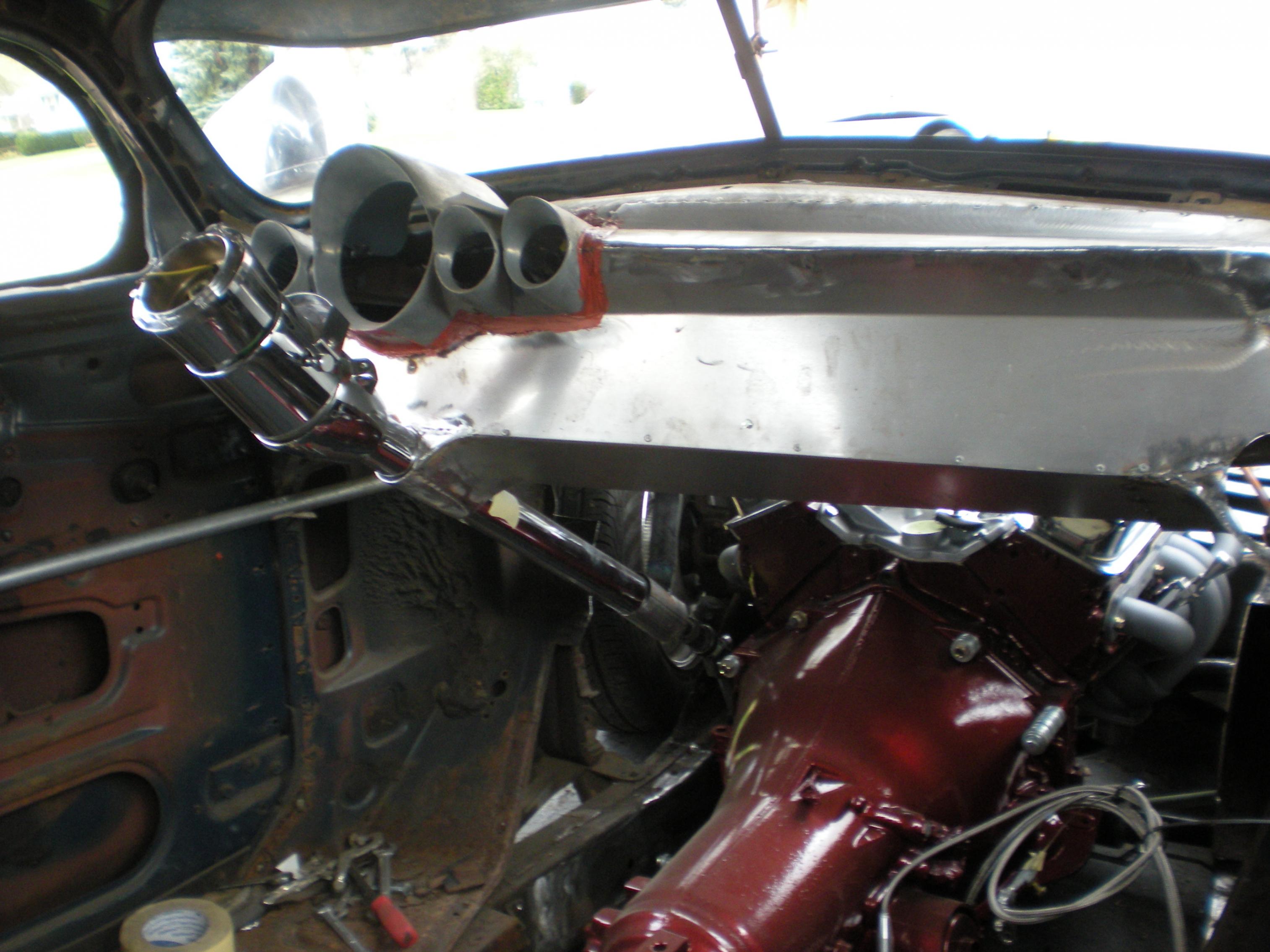

    Here's the latest updates I have.I've gotten some work done on the dash, I used 63 Impala gauges,new column.I have the tail lights done, its laying frame right now, but I'm planning on putting an s-10 frame, I had some issues with steering, that I hope will clear up with the new frame and air ride.

    Great work. But I have to say I think you should have stuck with the widened quarters. The new peaked quarters just seem..."out".
    Anyway, I admire the work you are doing regardless of my opinion. I love these types of threads.

    Damn. You and your bud have done some awesome work. The chop was great, the widened stock fenders were great but I'm not feeling the rest of it. The front end doesn't go with the ass end, IMO. BUT, I'd be the first to tell you to build it like YOU want it.

    Thats insane man I'm diggin what your goin for. I can't believe you guys did all that! That frenched 3rd brake light is sick! I was thinking about using my 2 extra lenses to make my 2 brake lights and keep my 3rd shaved, seeing your 3rd makes me think I should go for it!

    BTW Do you have any other pictures (especailly from behind) of your rear quarters from when you had them widened before you started the new rear quarters. I was thinking about doing that to mine because the front fenders are so bulky.

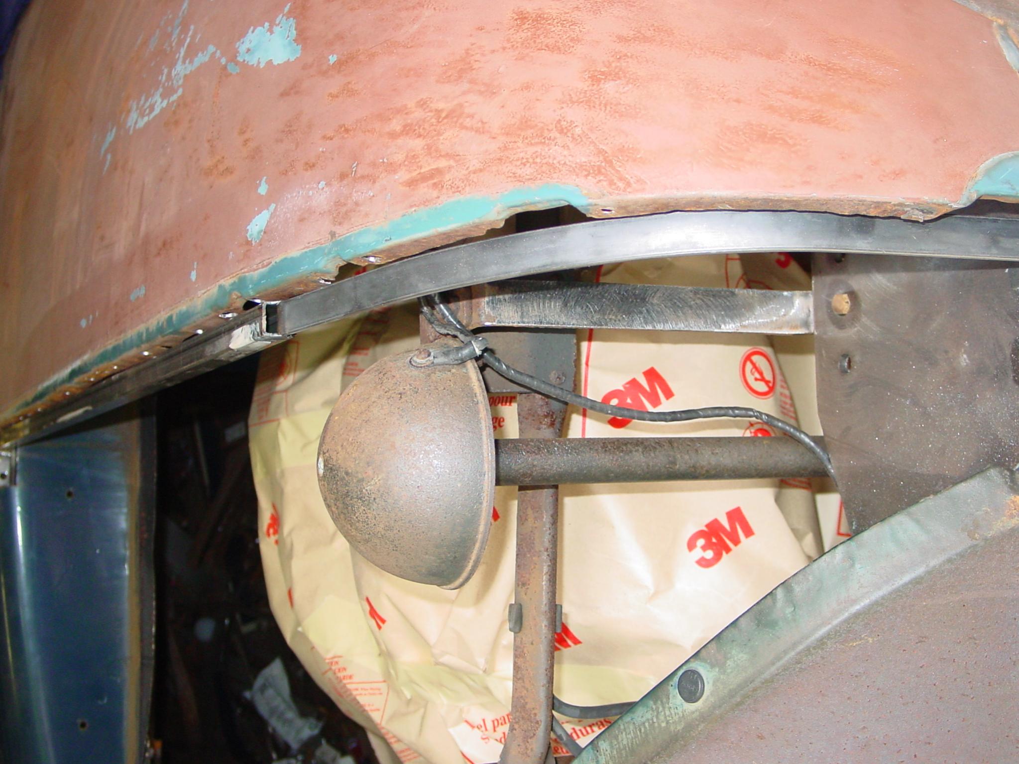

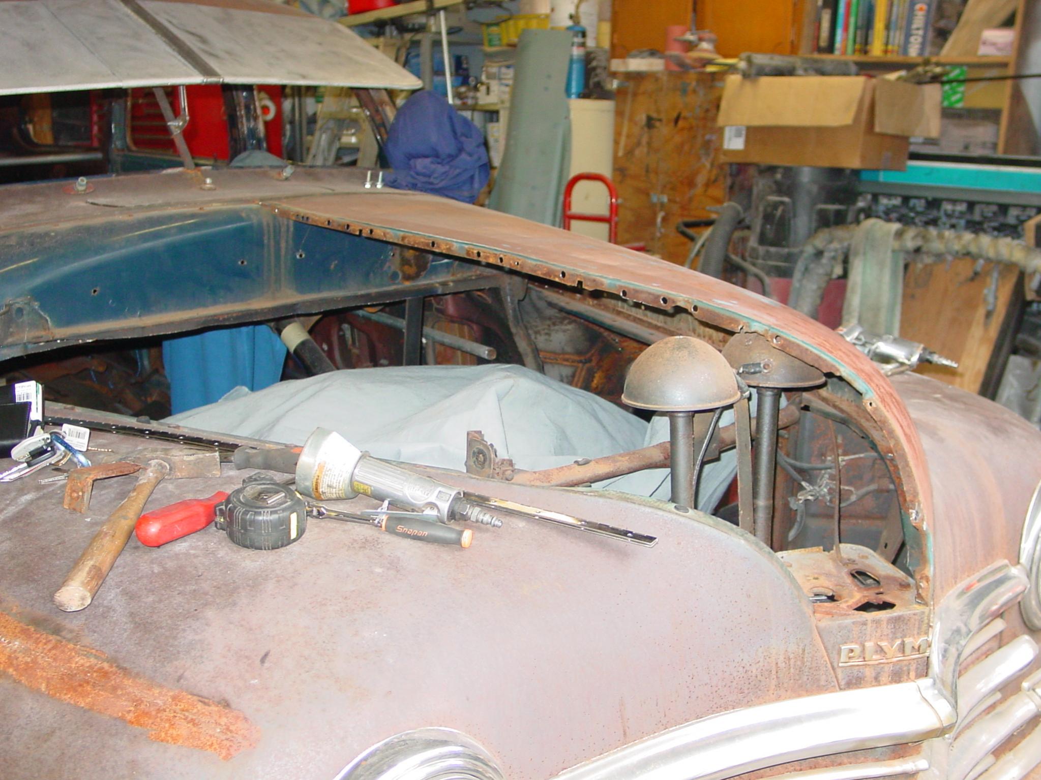

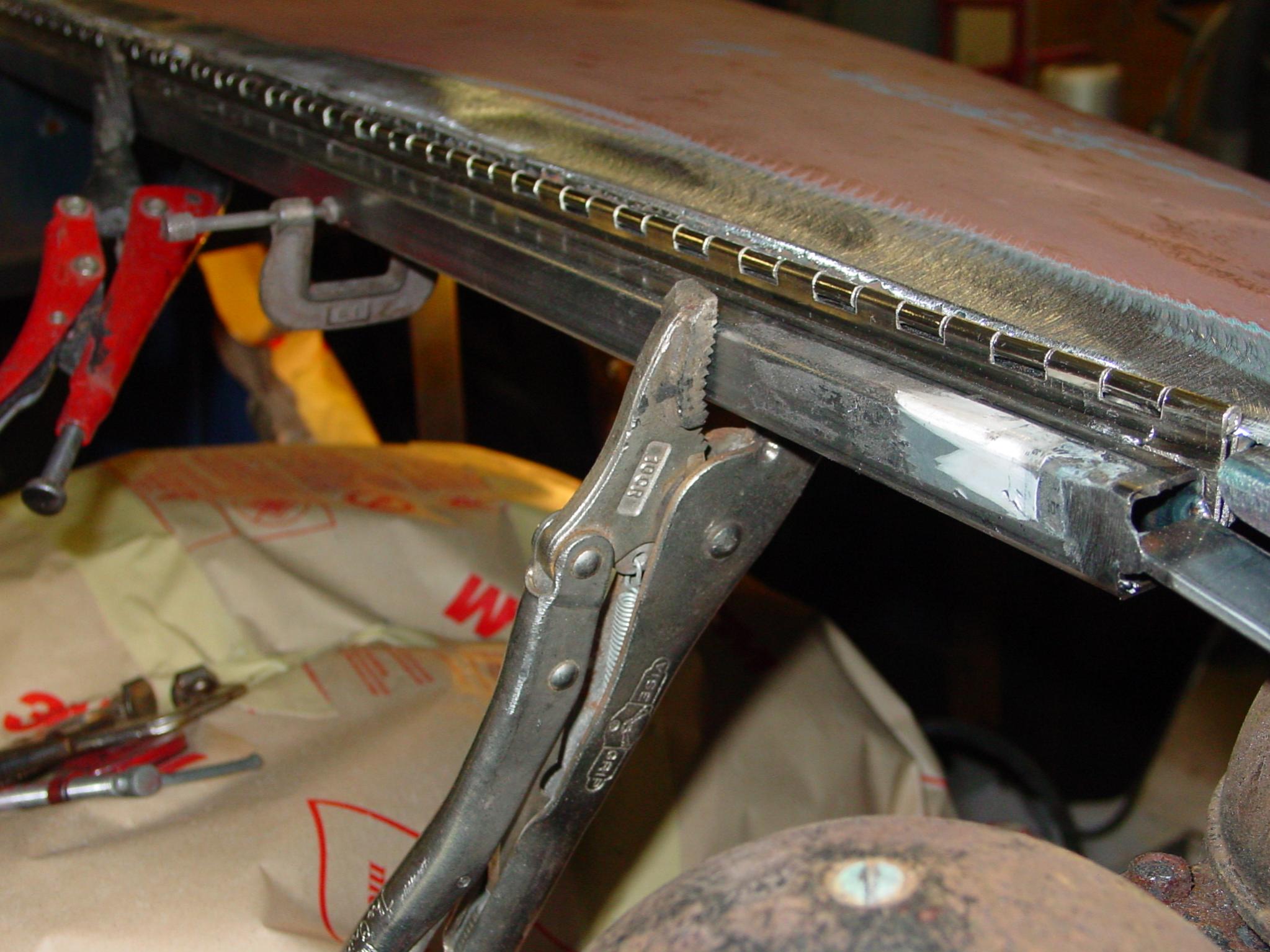

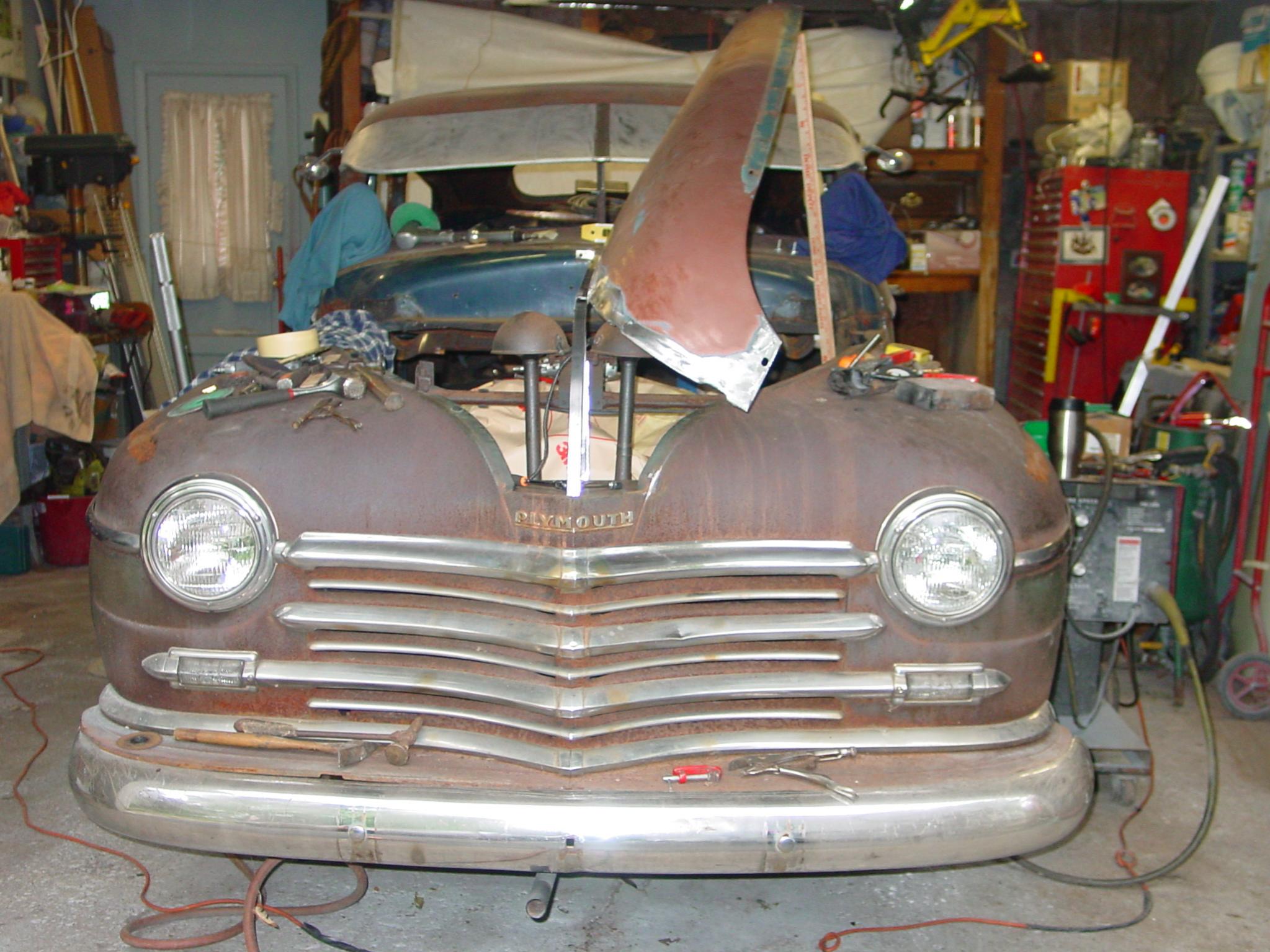

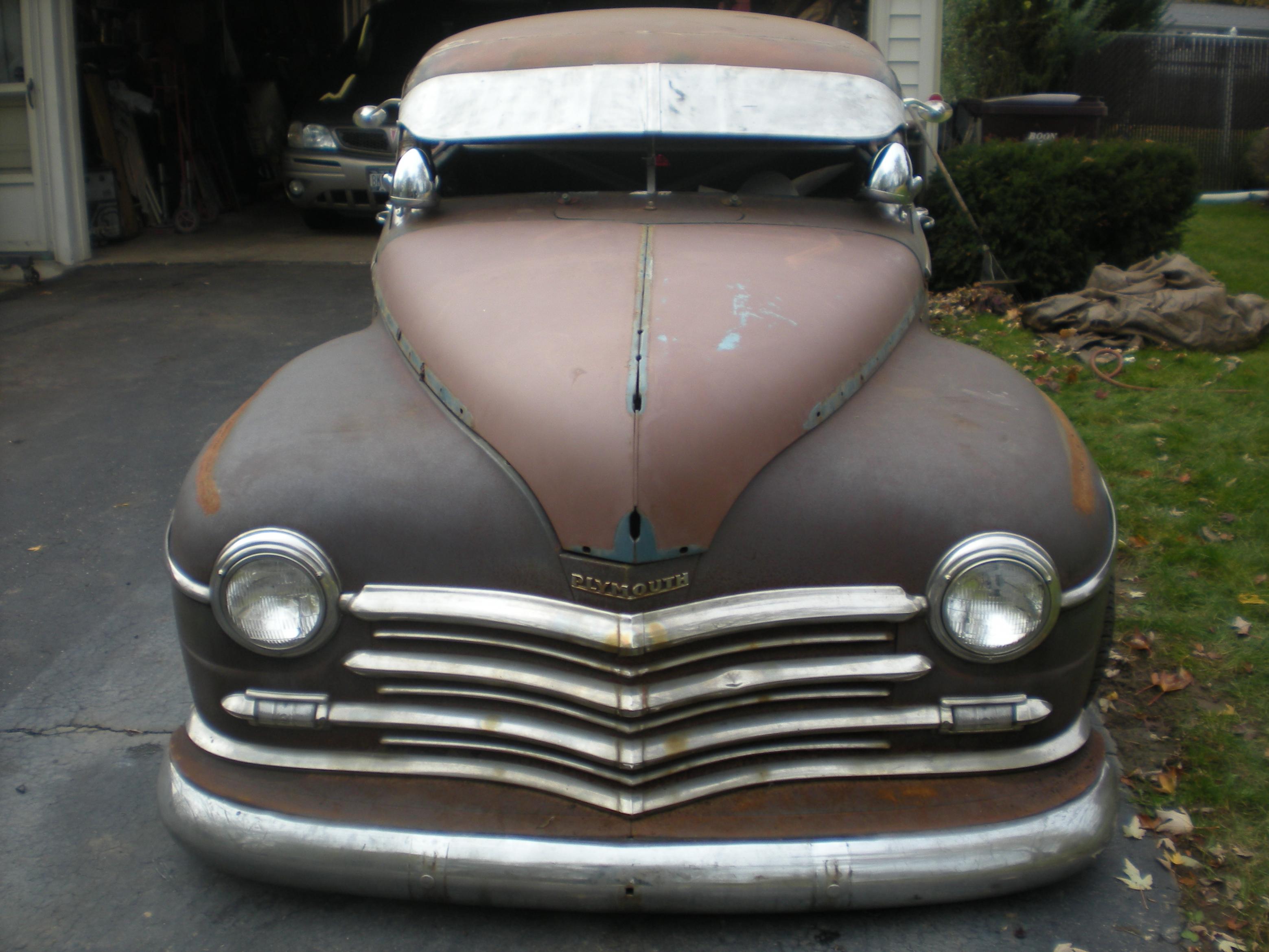

    I decided to split the hood. I split the hood, used a piano hinge from Home Depot. I used 1/2" square pipe down the center for support. I did mount the hood ornament and the trim back on. I'll take more pictures when I get a chance.

    Miguel, what are you going to do to cover up the hinge part sticking out of the hood? Glad to see you better and back at it again, looking good.

    no carson top thanks for the comment. hood ornament and moulding will go back

    I liked the chop. But the hood is much cooler. Welcome back. Great metalworking.
