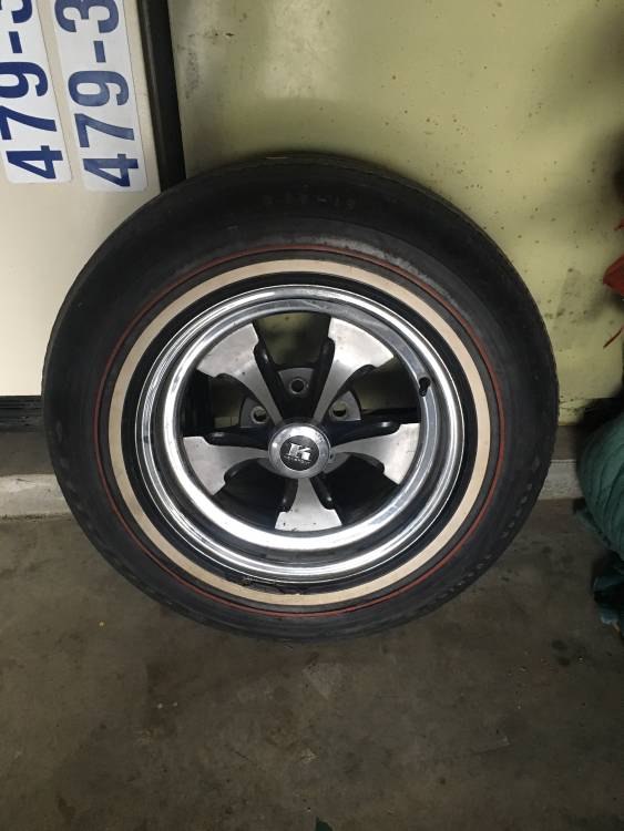

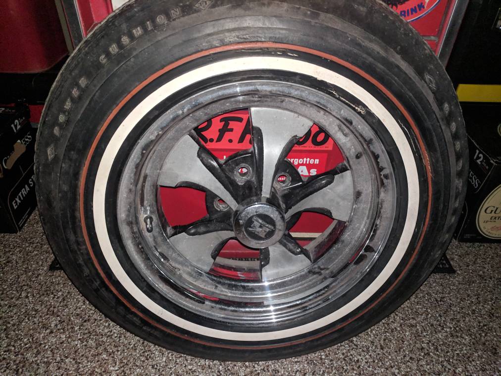

  1. A friend of mine told me that vintage wheels like my original Keystone's may be unsafe for road use. He said these original wheels were made from 2 different kinds of metals. He said with age these wheels become brittle and the metal can separate, this making the wheels deadly. I see no issues and no rust on my borrowed set of vintage Keystone wheels. Have y'all heard this before? Here's on wheel before cleaning. IMG_3501.jpeg IMG_20190203_195959.jpeg

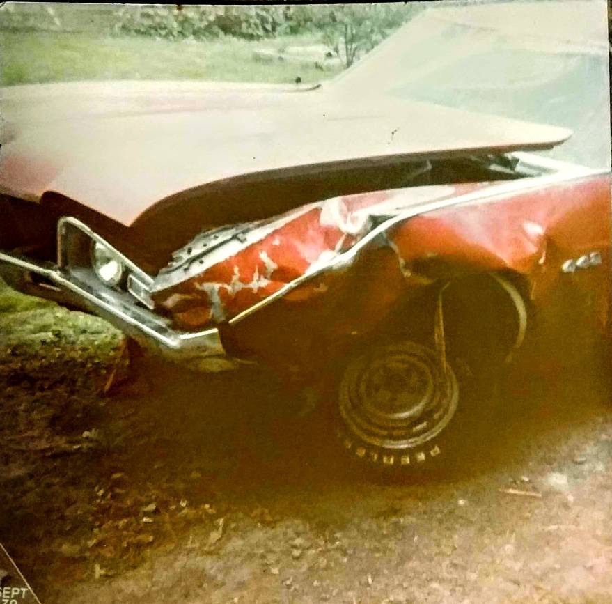

    I broke the center's out of two of my new Cragers on my 68 Olds 442 ,they were only on the car for two weeks, but I did put the car off the road at about 90mph ,after loosing the brakes, just missing a phone pole but hit a city limit street sign ,side ways , then through the front yard of a house that had been torn down except for the the front porch and foundation...and was all concrete...hit the porch ..car flipped on its nose and made a couple of spins then barrel rolled once or twice as it went through the remaining flooring and foundation landing on its top in a thicket of trees in the back yard....the wheels had been replaced with rollers before pic was taken....I was 17 in high school my first crash and big ticket and to top it off my dad being a firefighter was first on the sean..not sure what was worse getting the ticket or getting my *** chewed by my dad..... 1549685897265~2.jpeg
    Sent from my SM-T387V using The H.A.M.B. mobile app
