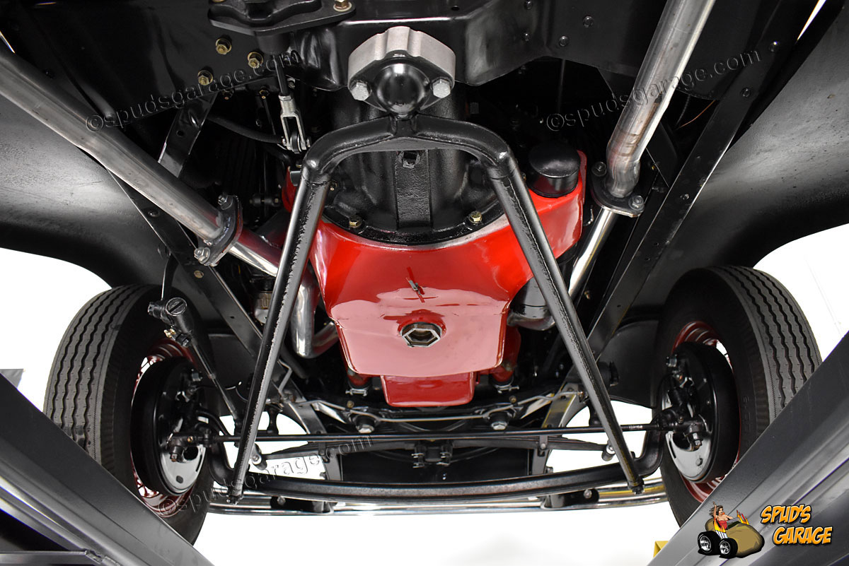

  24. ct1932ford
    Joined: Dec 3, 2010
    Posts: 13,376
    ct1932ford
    vtx1800, NoRust, Ned Ludd and 2 others like this.
  25. krylon32
    Joined: Jan 29, 2006
    Posts: 11,223
    krylon32
    from Nebraska
    The CE spacer I'm talking about was fabricated steel. The spacer you show should be able to be built by a competent local machine shop. I realize buying is normally cheaper than building.

    ct1932ford
    It looks like Heinzman Street Rods has something like it. I will check with them after the weekend.
    lothiandon1940 likes this.
  27. krylon32
    Posts: 11,223
    krylon32
    from Nebraska
    Heinzman part number AS2083 is the old CE part for a 41-48 Ford. Probably would no work on a deuce. I'd proceed in making the slick aluminum spacer you show in the above picture.
