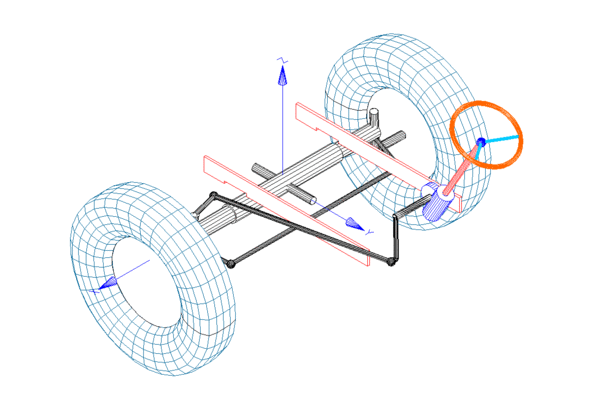

  5. So one of 2 things happen here,
    You will hold the steering wheel from moving which keeps the pitman arm still and then the car steers and darts
    OR
    The pitman arm moves and the steering wheel moves and shakes your hand while the car remains relatively straight on the road and you post a thread about a wired wobble you feel in the wheel- show us pictures of bumpsteer geometry and tell me not to bring it up again because you don't have it.

    Got it. Simple minds need simple pictures.
    Now all I've got to do is figure out what I'm going to do about it...
    Thanks!

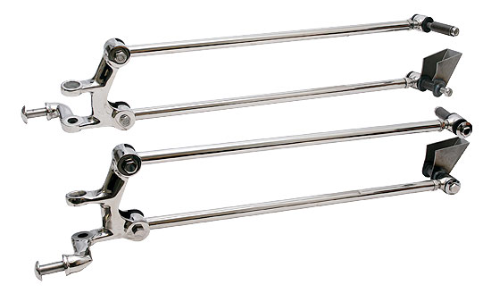

    NOW if that was my HodRod I would leave the steering "AS-IS" and convert it to 4 bar and the geometry would be correct.
    You would need some P & J style 4 bar perches. And you could mount the lower bars from them to the existing frame pivots.
    All you would need to do is fabricate upper pivots and keep all the 4 bars and drag link parallel with each other.
    missysdad1 likes this.

    3" travel would only require about 1/4" clearance.
    I've seen squirmier rods on OEM steering [check out 55-57 chevy drag links]
    The other side doesn't need to match the drivers side, only the pivot points do.
