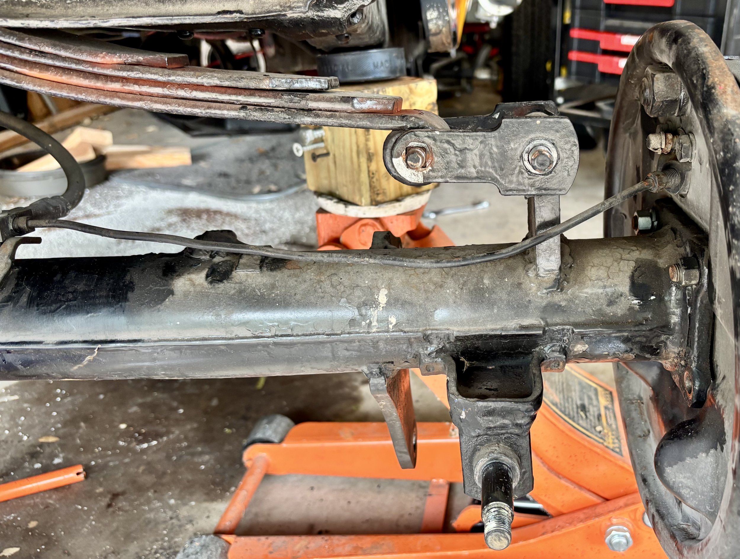

    I need to replace the shackle bushings on my ride. The axle is hanging free — no shocks, no driveshaft, brake line tee disconnected (see pic below). Is this what it should look like with the spring “relieved”?
    I’ve never dealt with transverse springs before.

    With no weight on the springs, they look alright. With weight, the shackles should ride at a 45-degree angle. What is your plan for dis***embling the shackles? There are a lot of threads on here about taking springs apart and putting them back together. Check this one out: https://www.jalopyjournal.com/forum/posts/15427945/

    Lots of guys will dis***emble the spring leaves first to make the arch less. Two giant C clamps, and then loosen the center bolt slowly as you loosen the clamps.
