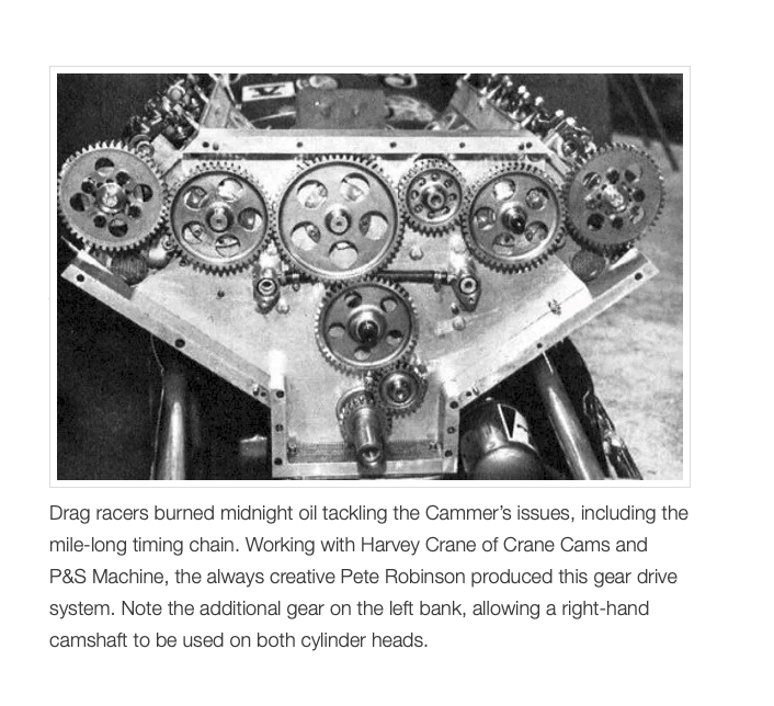

    Puzzle solved.
    From the above macsgarage story:
    "Note the additional gear on the left bank, allowing a right-hand camshaft to be used on both cylinder heads."
    Chain driven cams required a unique cam for each bank to be ground beacuse
    "on one bank the cam rotates toward the intake follower, and away from the follower on the opposite bank. This in turn necessitated a unique camshaft for each bank, one a mirror of the other, so the opening and closing ramps would be properly located."

    Flyer has it right, I think.

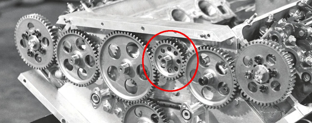

    The set of pushrods is lighter and cheaper, but they wanted what was become a modern and unavoidable system for sporting and racing engines - overhead camshafts!
    Chains, gears, belts or king-axle, maybe horizontal pushrods, or pair of mini crankshafts (levers), or... for transmission between crankshaft and camshaft (s) - a lot of choices...
    [​IMG] [​IMG]
    However, maybe I am the only one questioning myself: should one small gear (right from the big central gear) besides turning the direction of camshafts revolutions - at the same time change the ratio of the entire right side of the gears? Making revolution of camshaft twice slower at right than on the left (considering left-right sides as on the photo)... All other gears are installed in a symmetrical position, giving an aspect ratio of 1/2 revolutions of camshaft (s) consider to the revolutions of crankshaft? Probably that I could be wrong about such solo-thinking?

    The small gear is simply an idler so it doesn't change the ratio as it reverses the rotation of the camshaft so they can use the same camshaft for both banks.

    YEEEES!

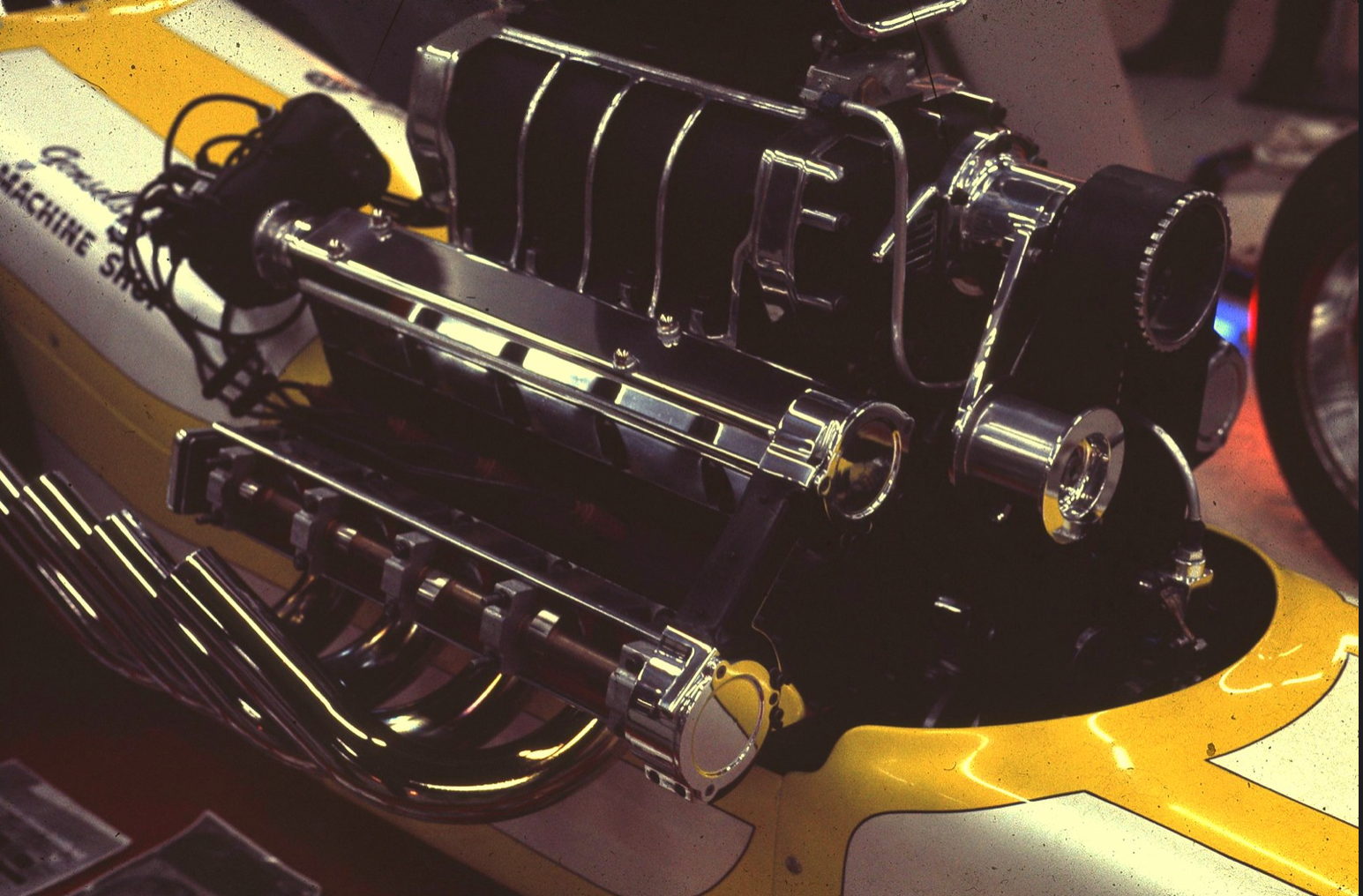

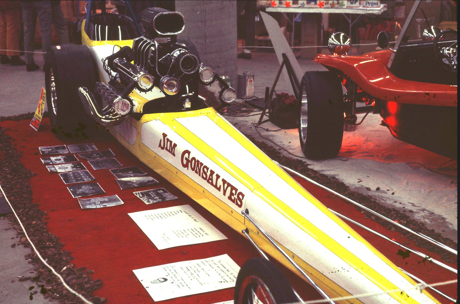

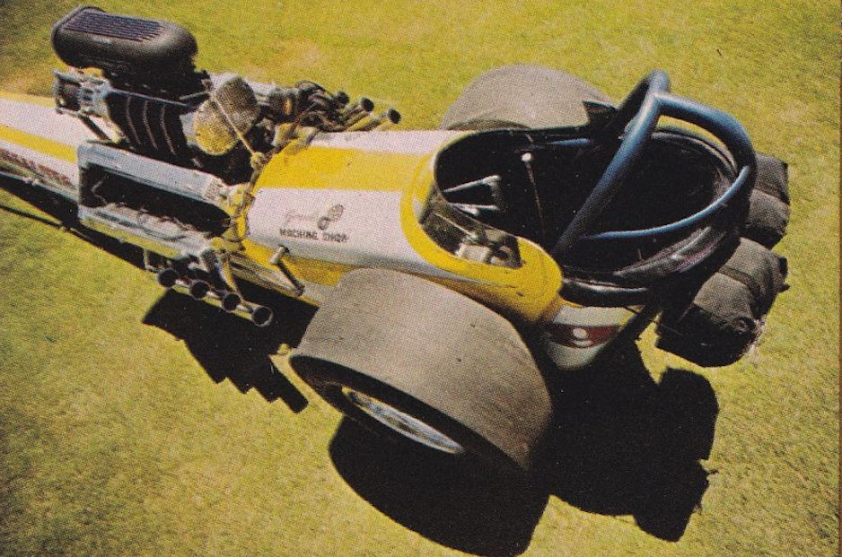

  21. Everything I have on file for Jim Gonsalves...8.05 @ 187 in 1974.

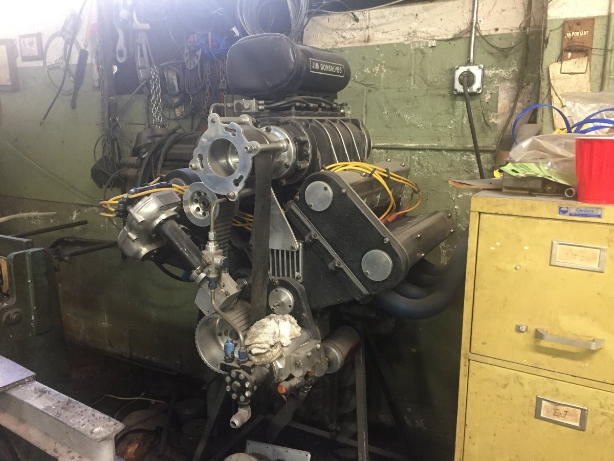

  22. And of course Jim Green's Cammer.
