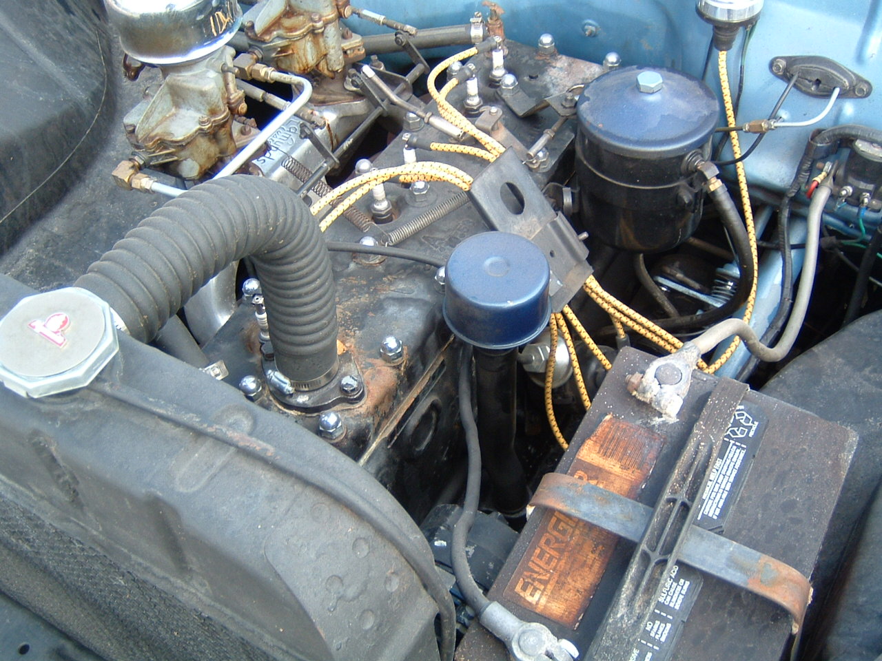

    i've run my coil upside for about 5 years now, you can barely see it in the top right corner of the picture, i have not had a single problem.
    ...although i just jinxed it by saying that. :D
