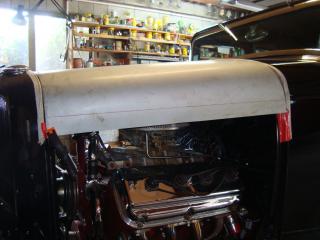

    Started the process at least, slipped in a longer center hinge rod so I could get a more accurate picture of what i'm up against. The three old rods were fun to get out, and the hood has lost its curve like they usually do, this one had been stored for decades. I'll have to carefully bend it back into shape. Looks like the stretch is going to be closer to 2" Had to bend up a little temporary grill tab, until the one I ordered comes in. I have to think about the spacing of the hinge loops on the end and getting the curve right against the shell before I start cutting and welding the pieces. not sure if this will be harder or easier than it looks..[​IMG][​IMG]

    I have done this both ways. A good and I mean really good welder will be able to add what you need and not warp the hell out of it. I have also had a full custom made aluminum hood made. I like the aluminum hood much better than the one with the added pieces. Good Luck

    Started fitting the pieces off the old parts hood to stretch mine the needed 2 inches..Man, I envy you guys that can whip something like this up in a few minutes...This represents about 5 hours so far for me, but I am working slow, as I didn't want to cut too much off at once. I did find my grill was off center a bit, so had to take care of that issue first....Its getting there at least, hood sides should be a lot easier.....I emailed Sache about the 32 style hinge, and will probably go to that later, but for now I'll stay with the stock A piano hinge [​IMG][​IMG]

    Pretty much built now...ended up being a 2 1/2 inch stretch...still a little tweaking to do...straighten a few louvers, cleanup some welds and finish body work. but I really like the new look. Thanks for the suggestions and comments....

    it looks like the louver spacing would "appear" more centered if you added to the rear. on a deuce hood the body line ends at a subtle point before the grill shell so if you add to front you could just finish the body line with a bullnose right before the front end of your add on piece . i see a good reason to do it both ways so i am of no help !!!!!
