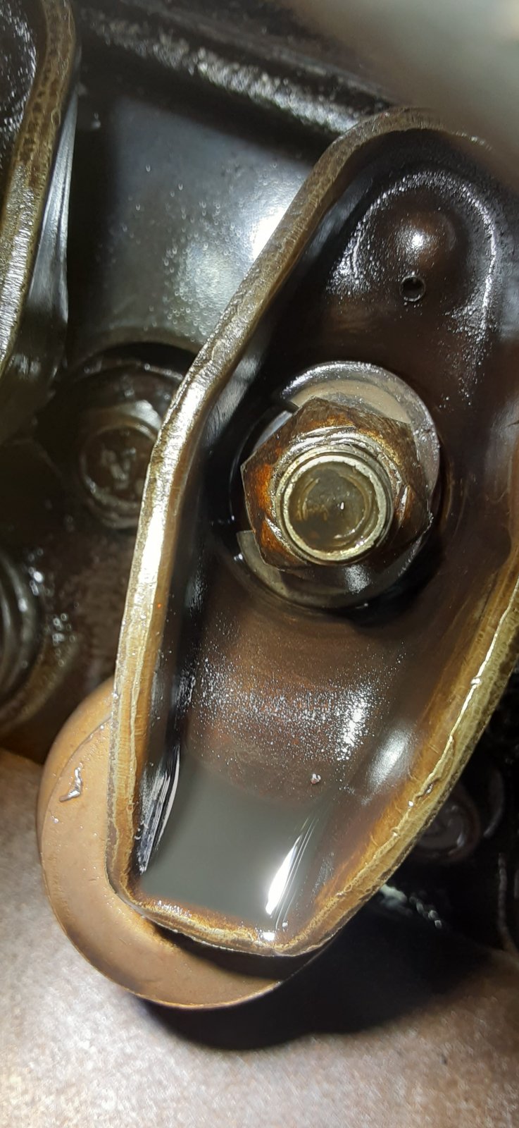

    I have been nursing the 327 this year in my avatar so I could make it thru the show season. It has blow by, it smokes out the oil filler. I've done a compression test, numbers weren't great (23psi on this cylinder) and it has had a tick. I haven't noticed any loss in power at all. So I pulled the valve cover off and was wanting to see if I had a lifter that needed adjusted. Started the car, it ran for 3 or 4 minutes and died and it will not start at all now. (Maybe unrelated). 20211018_113032.jpg I noticed this valve is off. Thoughts? And if it needs the heads redone, I'm thinking of replacing the motor as I've not been happy with it anyway.

    Can you wiggle the valve retainer sideways? It looks like that valve is not in line with all the others, like the guide is completely gone.

    I have to go with what Jim said as well. Bring the piston all the way up on that cly. and pull valve spring off valve and take a closer look.

    20211018_124351.jpg I just noticed this, the washer on the rocker arm is busted? How? Something else cause this, what's my next move?

    ^^^^^ Valve float

    just buy a new rocker arm at the parts store, it will have a new pivot ball. Put it on, adjust the valve, see how it does.

  25. Can't see how the push rod could have been bent and pushing the rocker to one side,....with guide plates ;-)

    Seems the rocker moved through the lift of the cam by looking at the pics.
    As noted the broken ball is probably issue. But take a bent wire, run it through a hole, it will lean/move to a different spot as it goes higher and lower.
    I think that’s why the suggestions to look at the push rod were warranted.
  28. Of course everything should be looked at when it's apart. But once he loosens the lock nut it would be apparent where the trouble lies. Top of the rocker where it belongs, with the guide plate ...Bottom, not so much so.
    I would guess someone along the line , trying to eliminate a clickedy -clack, ran the lifter plunger down to where it was acting like a solid but with no lash ... Rocker at an extreme angle , stress on the ball...crack!

    I've had the car for 4 yrs, valve cover has never been pulled. Motor was rebuilt (whatever that's worth) before I acquired it and I'd guess it has less than 1000 miles on it. I got the rocker off, I don't see anything other than the broken washer. But I can't see that being the only issue but a symptom of something else.

    Rocker stud coming out of the head or the cam is going bad.
