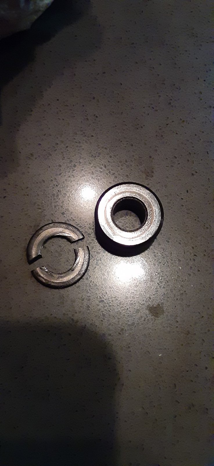

  1. That's not a washer..It's the pivot ball for the rocker arm... Not supposed to be in two pieces. It won't work well like that. Also , the lock nut being way lower than is "something else'. If someone else cranked it down like that 4 years ago, I'm surprised it lasted this long :eek:

    20211018_223720.jpg that's the top of the pivot ball?
  3. Okay, I should have waited...I have seen a bunch of MM stuff on these old cars.
    That washer doesn't belong there. That makes things even worse, being that it collapses the lifter even more.
    Keep up the pictures. Bottom of the rocker. Top of the valve etc.
    Check one of the normally adjusted rockers nearby. Probably won't be a washer there.
    ZZ Top Chop and gimpyshotrods like this.

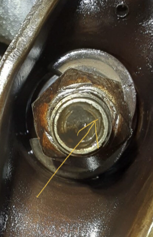

  4. I'll go along with the cam but it has screw in studs and guide plates.
    Although, with a worn intake lobe it wouldn't run very well. Should be noticeable .

    I am not so sure that the nuts are "way down".
    I have seen some pretty tall screw-in studs, designed to be used with poly locks and stud girdles.
    These might be those, just with regular nuts.
    Desoto291Hemi likes this.
  6. I see your point, Gimp. Might be camera angle and so on. The washer (s) ? are there for some reason, and it's probably not a good one.

    The only thing I can think of adds up to bad. If the rocker stud pedestals were not milled down to the proper height, and were left too tall, the washer might be there to keep the nut from running out of threads.

    The heads might be 3991492’s, Chevy castings that came with screw in studs and guide plates. @gimpyshotrods might be on to something with the mention of longer studs, in the photo it looks as though there is a witness mark from a set screw.
    The OP doesn’t know the history of this engine, could the builder have removed roller rockers and poly locks before selling?

    That's exactly what that circle looks like.
    It may have been "downgraded" before sale.

    I would set all of the valves at zero lash and see what happens. If it is a hydraulic cam, it will be correct. If it is a solid lifter cam, a little tight.
    Then repeat the compression check cold. and see what you get. Then do it again with a squirt of oil in each cylinder, and see what you get.
    Try one more time with about 0.020" clearance.
    See which one produces the best readings.
    If these are 492's, and need a washer to keep the adjusting nuts from running out of threads, the valves are too tight.

    There are washers on all of them. I'll post some more pics today.

    The onlt thing I can think of needing washers is the studs have walked out of the head. Built my first SBC a few years ago for my grandson's '59 El Camino. He thought I had timed the cam chain, I thought he had, neither had and the chain was off several teeth. As expected there was valve piston interference and several push rods bent but several studs walked out of the head. Point is, that method of securing the rocker studs is sketchy. I imagine a tired head will start having the problem.

    Hmm, looks like you got a random ***ortment of parts. The heads may have big valves if someone went to the effort of putting screw in studs in. Though they may be beat to death. A hardware store washer on top of the rocker pivot - I wouldn't trust anything else that person did.
    You're close enough to Louisville. Run over there to find a used sbc. A 305 will drive down the road.
    Tear this thing down and see what's left of it.

    20211019_065947.jpg 20211019_070000.jpg 20211019_070114.jpg hey guys, thank you for all your input, appreciate it. I took pics of what I thought you may need. It does appear that there isn't enough real estate for the threads so the washer shim was added, but IDK. What do you think? This motor is coming out this winter anyway. But I did want to keep it running so I can get it to my buddies house. Looking at a Blueprint 350, thoughts?
