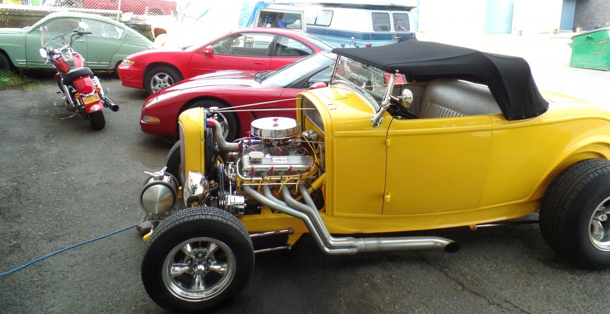

    Upgrade? The scrub radius is so wrong there. o_O
    seriously, that is not the right way to build a front end.

  4. It's pretty,
    It's not right but it's pretty
    Lots of cars have **** for scrub radius because of the aftermarket parts we are force fed. So you're not alone.
    Scrub radius of 2" (positive or negative) is the sweet spot.
    Andy, 56shoebox, BJR and 1 other person like this.

    Maybe it is my old eyes but it looks like the bottom of the shock mount is just barely above the rim outer edge, thus making it technically within the scrub radius. Cutting it close if there is any crown but
    we all make our choices. Sorry I was not thinking scrub radius but scrub line.

    Happydaze
    I have an almost identical looking setup on my roadster, but the inner edge of the wheel rim is just about inline with the outer edge of the large slot in the caliper mount / disc cover, meaning the wheel is inboard by a good inch or more. Mine drives perfectly. I don't know how detrimental an effect that extra scrub radius would have. Can't be a good thing but isn't necessarily dreadful?

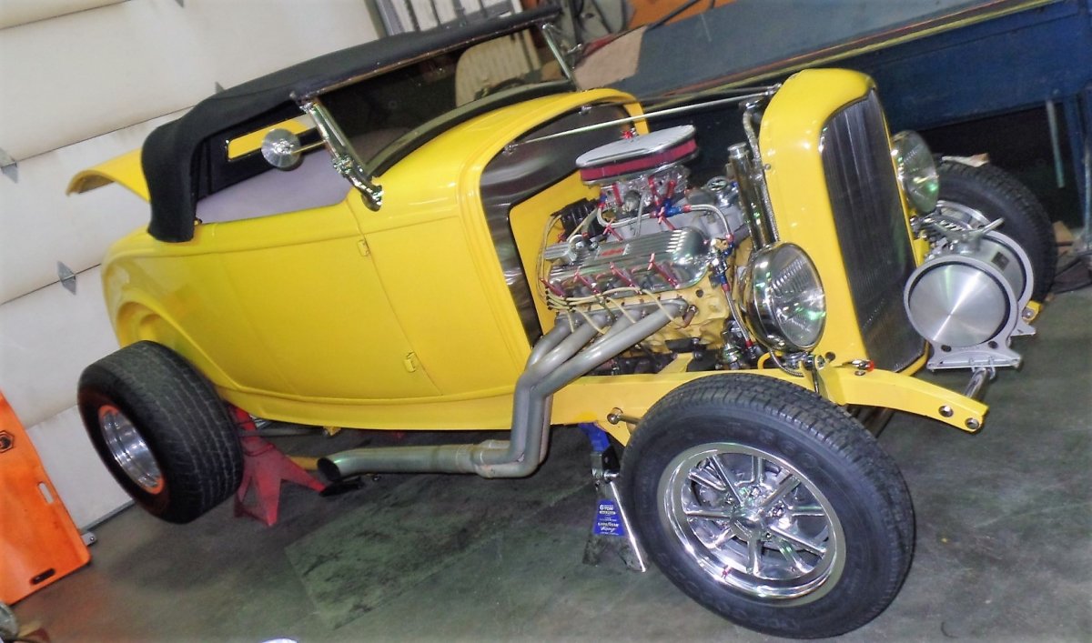

    SAM_1094.JPG Had to get the balloons off the end and the ****py yellow spindles. The stance remains the same.

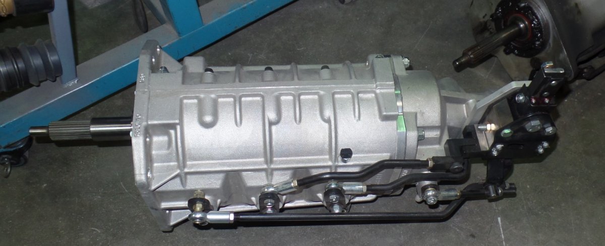

    Updated the Muncie two years ago. Changed from 3:30 to 3:80 posi. In need of a fifth gear, settled on a Richmond. Won't install it until next winter. SAM_2082.JPG

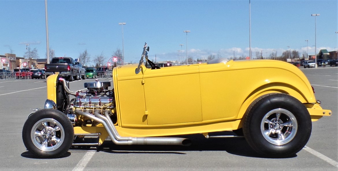

    A taller tire would help also.

    Nah, it sits right...it's been measured out. It drives right. We didn't change the stance...Video with the 3:30

    I thought the Richmond trans still had a 1:1 fifth gear and lower first ?
