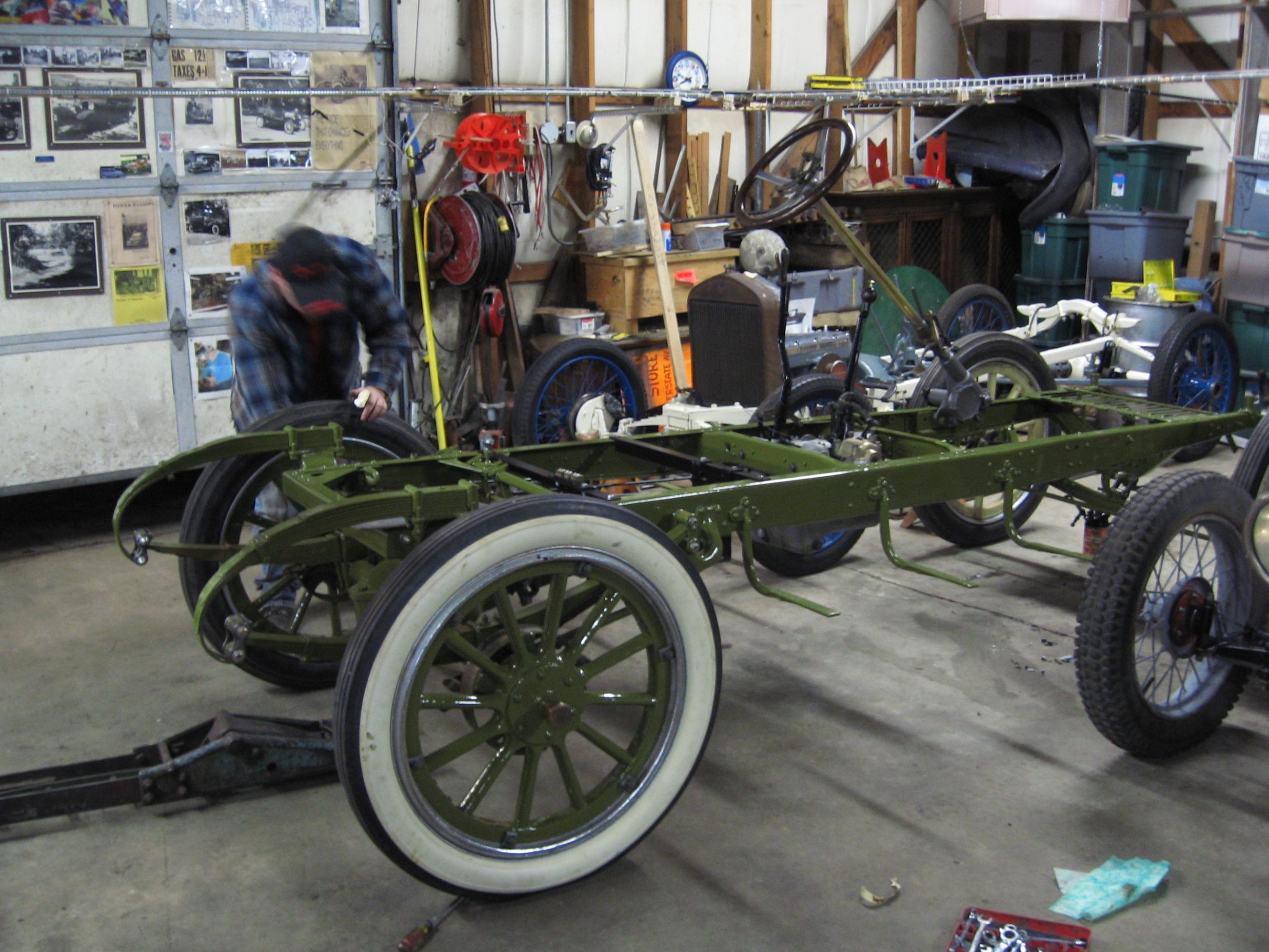

    The White is far from done, but getting alot closer. Chris and I have been working on just about everything besides the body, paint and what remains to be done on the engine. I have been going through loads of nickel and br*** bright work and doing detail work on the little parts and accessories, and at the same time Chris and I are researching and working on getting the motor back together.
    Chris has been spending more time lately on his roadster and rightly so! His car is the reason I built my T and we always hoped we would have them running about the same time. Good things did get in the way (Carston and family), so it's not all bad that it has been a little neglected...I'm glad he is back on it!
    ...I used to kid him that by the time he gets that car done, I will be restoring my T AGAIN with my grand kids! :D

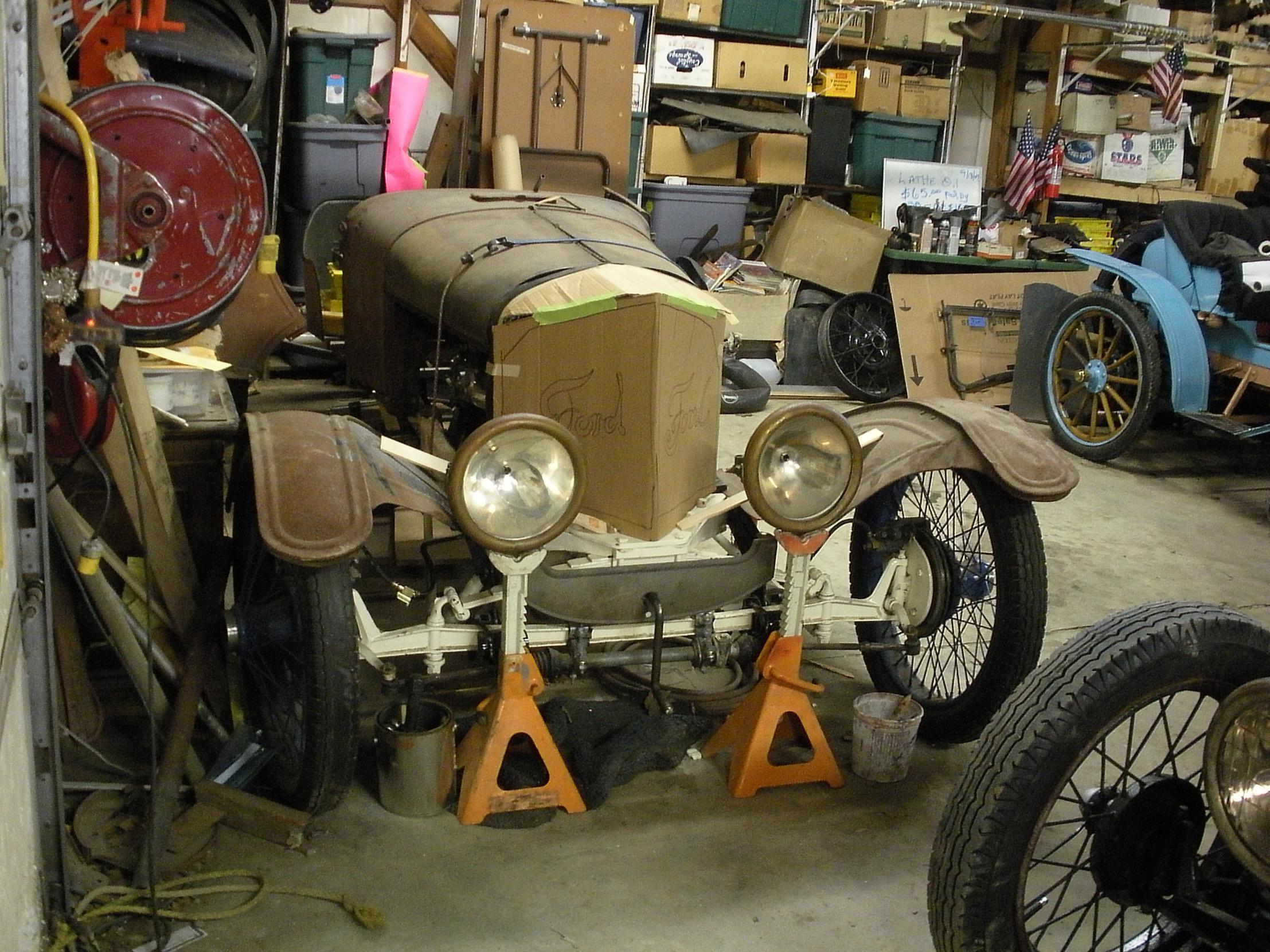

    Here are some of the latest on the White and some earlier shots of Chris's T with the headlights he is running. I had found them on Ebay and picked 'em for myself: Br***, electric and fork mount. Not many cars used these, We think they are 1912 White.
