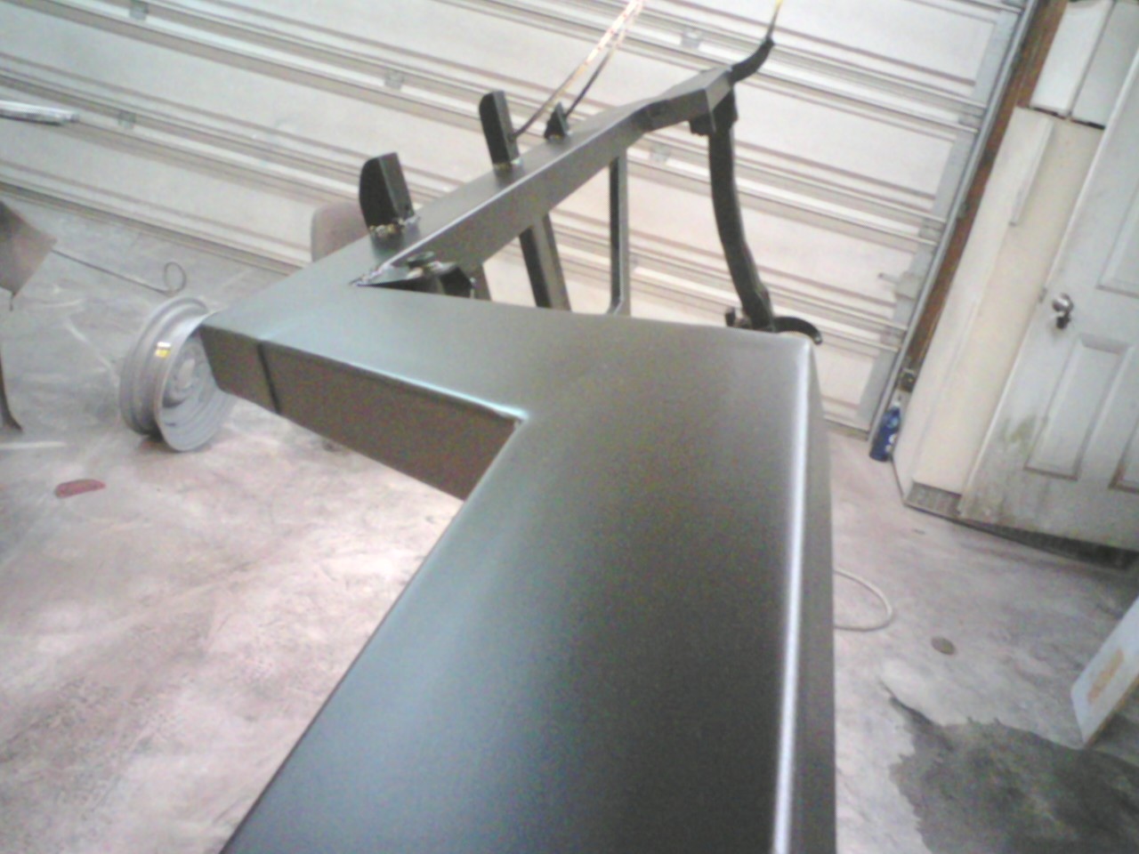

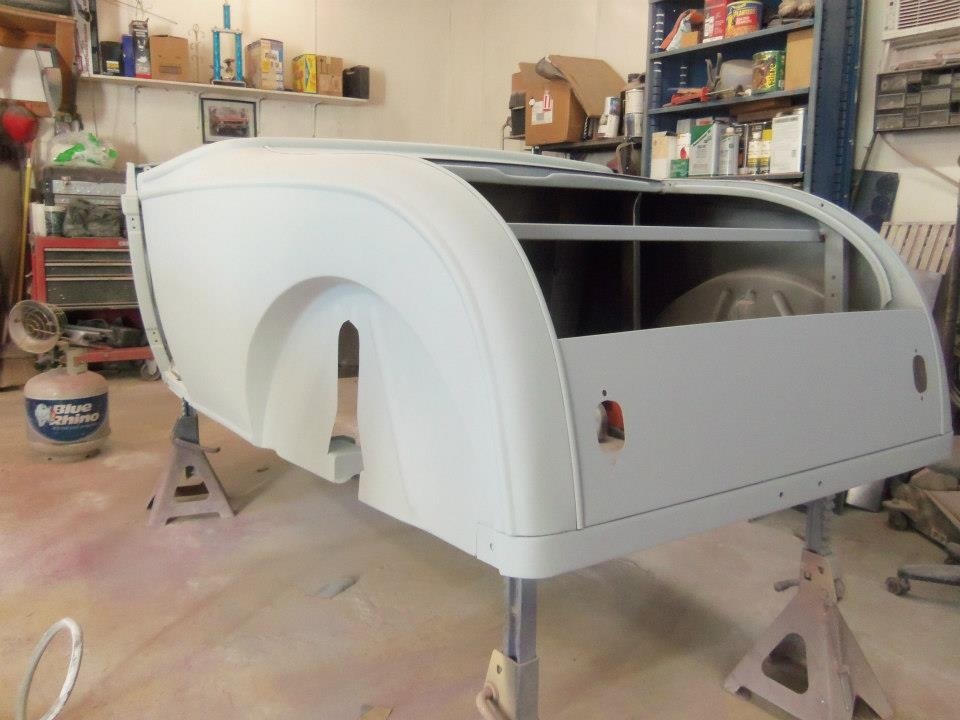

  26. kasultana
    Joined: Oct 27, 2012
    Posts: 162
    kasultana
    Body almost ready for color. Cars going to be monsoon maroon. Color starts next week.Frame/suspension back from painter.

  28. kasultana
    Posts: 162
    kasultana
    Here's a shot of the frame. Long weekend might get some re-assembly done
