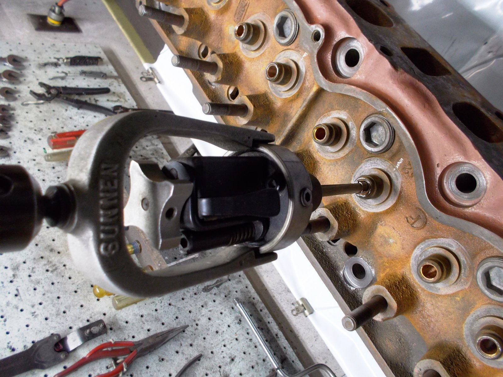

  29. THE FRENCHTOWN FLYER
    Joined: Jun 6, 2007
    Posts: 6,131
    from FRENCHTOWN
    A precise valve job should include first reaming and then honing to size with a Sunnen hone or equivalent.
    Dan Yager and ottoman like this.

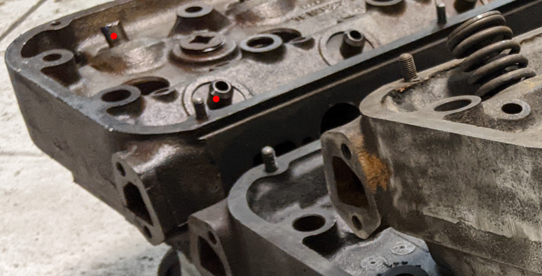

  30. sunbeam
    Joined: Oct 22, 2010
    Posts: 6,400
    sunbeam
    Look for holes in the exhaust guides top side at the bottom of the guide. This allows oil to the guide. When the head is on the engine oil would have to run uphill because the retainer end of the valve is lower than the head end. No valve seals. Have the guides been replaced if so do the exaust guides have the oil holes and located right.
    Dan Yager likes this.
