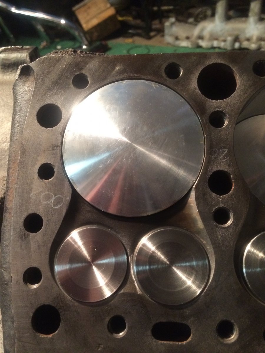

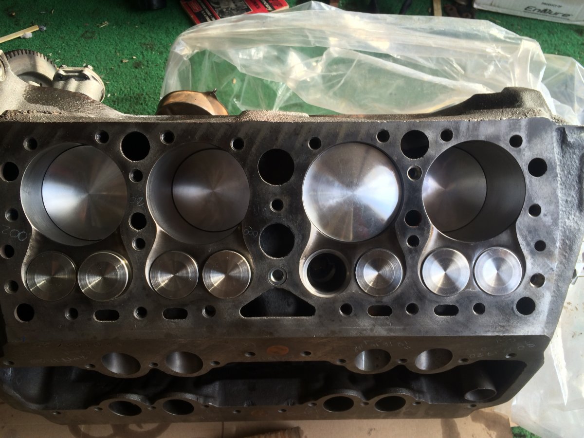

  13. My 8BA is .125 over...there is still plenty of meat
  14. Wow why is your deck surface cut so short under intake surface???
    HOTRODPRIMER likes this.

  18. It looks like your missing 1/4 inch of your deck surface.
    GreenMonster48 and HOTRODPRIMER like this.
  19. I see what you're looking at now...it's an optical illusion!
    I just had the deck surface cleaned up, no milling. The block was .060 over when I bought it with an aftermarket cam, but I've been running the motor for 500+ miles no issues.
    Here's another pic. The block was painted at the machine shop, you may be seeing paint lines instead of shadows.
    mgtstumpy and HOTRODPRIMER like this.
