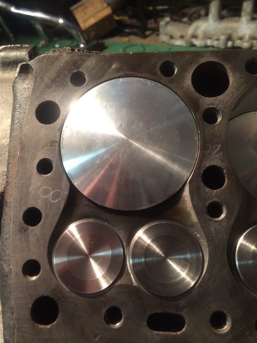

    3-5/16" X 4" makes 276"+/- & was considered to be one of the best running & reliable motors for the "Oval-Racing Crowd" back in the day. Easy (& relatively inexpensive) to build, durable, &(for their time) performed well.

    If you like to live dangerously I have 8 3 3/8+=.030 X 4 1/8 pistons.

    60 sum years ago 3/8X3/8 was a fairly common big flat head. 4 inch Merc. crank offset ground with 21a rods. The big guys ran 7/16 by 4 1/4. this was done with fairly new blocks.

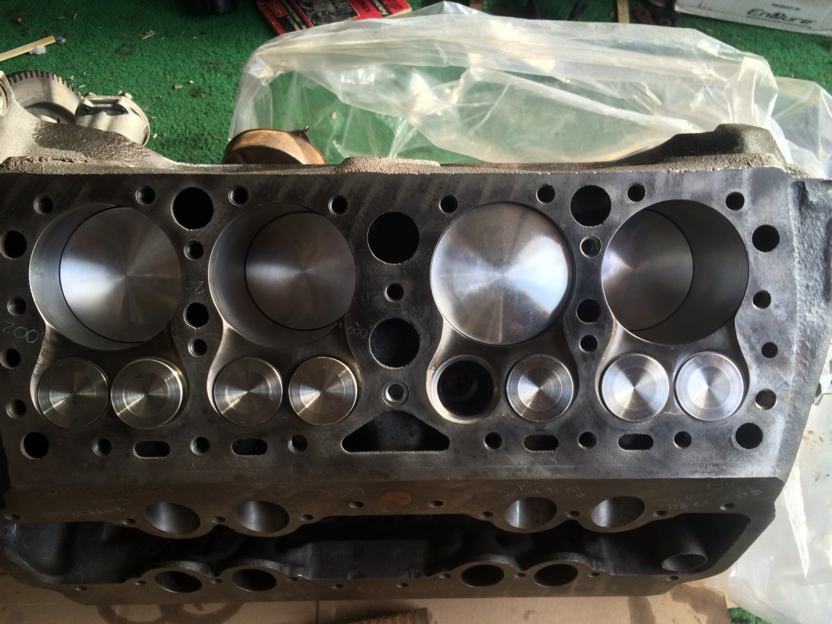

    The parts have been purchased and the engine is going back together,thanks for all the shared knowledge on boring the Flatty. HRP

    HRP - I am late to the party so I apologize. I will say that although I am running a stock bore flattie in my avatar, digging out the sand from the water jackets is key for any flathead to stay cool. I dug a gallon bucket of sand out of mine, digging with a long screwdriver and ****ing up the sand in my shop vac. That is not including all the sand I flushed out with water between the 4-5 times I dug out the sand. That little flattie has proven itself time and time again so the 2-3 hours it took me to do that were well spent ....

    I have a '40 engine that I knocked the thin shell sleeves out of. Light hone, and it's .083" over bore with no machining! Finding pistons & rings kinda hard, but do able. And it runs cool.

    Haven't built a flathead since the early 60's but am in the process of doing an EAB. Question is how deep is the relief cut from the top of the deck to the top of the relief? Have three blocks and the best one to do has 2 exhaust to cyl. cracks. I would do the relief then plug the cracks. Any and all suggestions wanted...
    HOTRODPRIMER likes this.
  13. My relief was 3/16. Or just shy of that.

  14. Bore them 3 5/16" all the time. The important thing is that the water jackets aren't so rotten that you bore through or have thin spots. Clean cooling system and a good radiator, be just fine. 140414_0002.jpg

    My '52 block in my '40 Tudor is .125 over and 4 1/8" stroke. Been that way for years. Originally it overheated but that stopped when I put in a new Walker radiator. Best $500 I ever spent.

    It's been 6 months but I am happy to report that the Flathead has been rebuilt and after running the engine through several heat cycles and re-torquing it is once again installed between the frame rails and sounds great!
