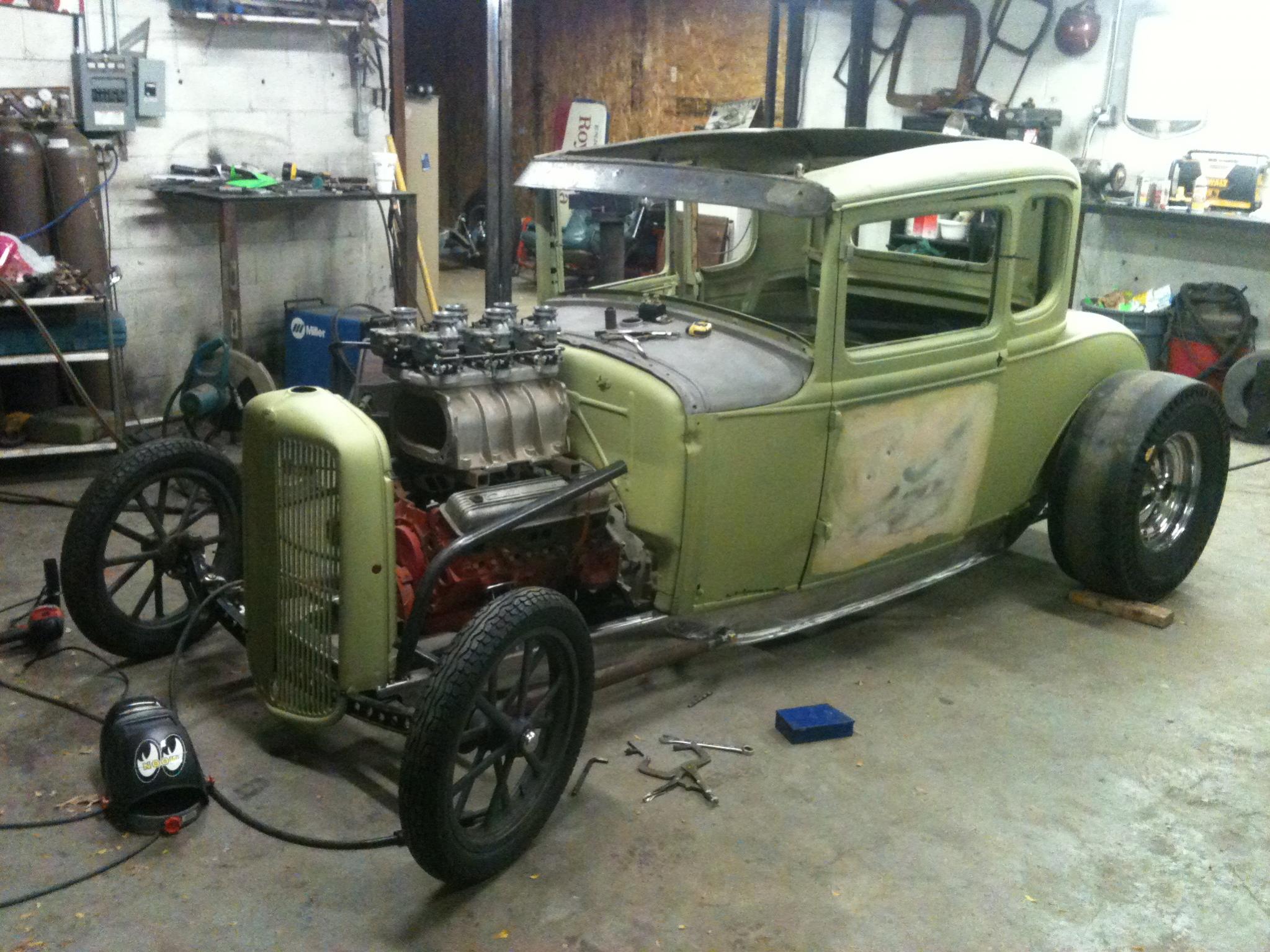

    I had a left over '32 dash from a previous project
    it was hacked, patched, brazed and bondo'd
    I warmed it with a torch and s****ed the worst of the filler off,
    stripped most of the **** off with paint remover and grinder
    chopped the top off it and the bottom off the stock A dash rail
    and tacked them together
    cut out the poorly done patches
    filled them with new steel
    and hacked a big hole in the middle

    got most of the welding done and ground
    still need to spend some more time working it smooth
    but here it is screwed in place for a trial fit
    with one of alchemy's dash panels hanging on it

    ironed out a few wrinkles, drilled and tapped the panel and bolted it to the dash
    this is as finished as the dash is going to get for the moment
    it's just about ready for some filler and primer but it'll stay naked till then.
    the aluminum panel will probably get polished
    and I will need to round up some gauges to compliment the package

    making seats,
    borrowed a mold that was taken from an old race seat
    never done this before and might never do it again but, what the hey
    number one mocked up in the car and number two on the mold

    been busy working on everything but this car
    so yesterday I took a few minutes to pay at least a little attention to it
    and ventilated my Alchemy '32 Pierce Arrow dash to accept a few gauges I had laying around

    Thank You, I'm digging the blend of styles it adds to the project, I went with the similar to stock gauge placement with '60s era Stewart Warners and used the 2-5/8" gauges on the ends, it'll get a Superior wheel on the Chevy van column. [​IMG]

    heyitsnate was kind enough to lend me some very cool old headers from some long ago hopped up Olds motor,
    I think they are just the style this car needs
    so I'm going to try to recreate them here
    I bought some nice heavy flanges from GOATROPER02 a while back and fabbed up and welded on some starter tubes
  28. Paul
    Joined: Aug 29, 2002
    Posts: 17,207
    Paul
    Editor
    started chopping up some 2" 14 gauge tube I bought locally
    couldn't find any 4" 14 gauge plain steel tube for collectors to match the originals
    so I'll use a couple Olds oil filter canisters for collectors
    finished welding the first set of tubes and blended them nicely
